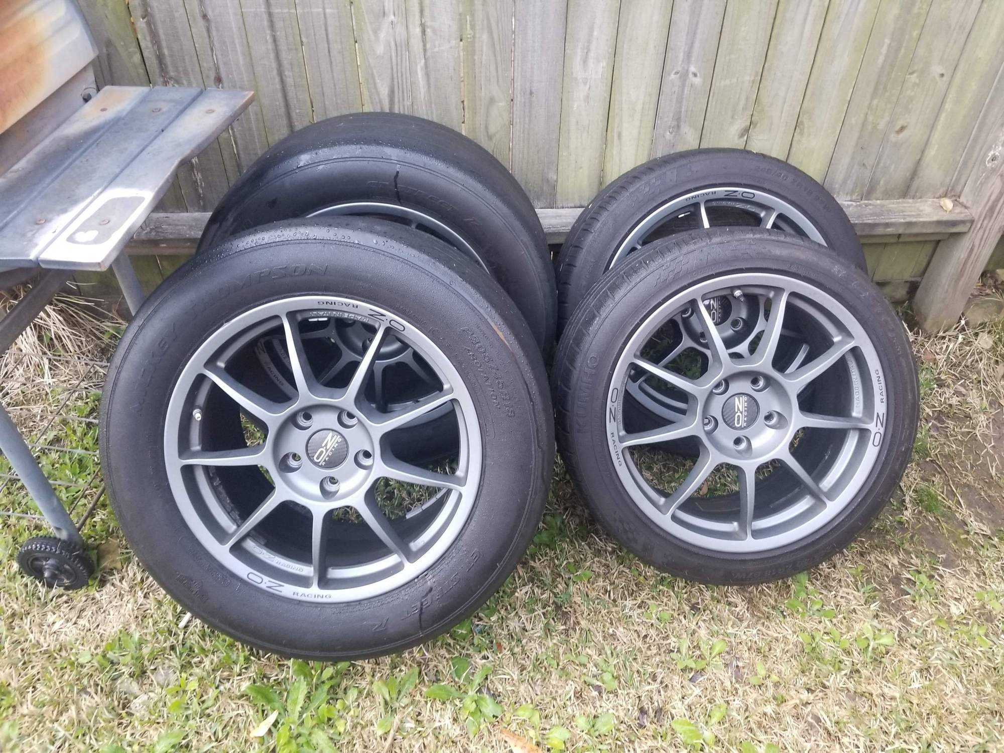

New set of wheels for the track have been acquired 😬 305/40/18 Et street Rs out back.. should hook this stock converter car id think 🤷🏻‍♂️

I run the ET Street R’s on my C5.
275/40/17
On a decent track they dead hook.
4L60 doesn’t have a tractor like first gear ratio like the 6L80, but I do have a converter that stalls 3800.
I think you will be fine.
Nice! Friend has a stock converter C6 with a small cam and headers, dyno'd ~440hp and runs 11.0 on street tires like clockwork. I'd guess 470 would be 10.7'ish.
I'm thinking the same. High 10s. It pulls as hard as my high 10 fbody did.
