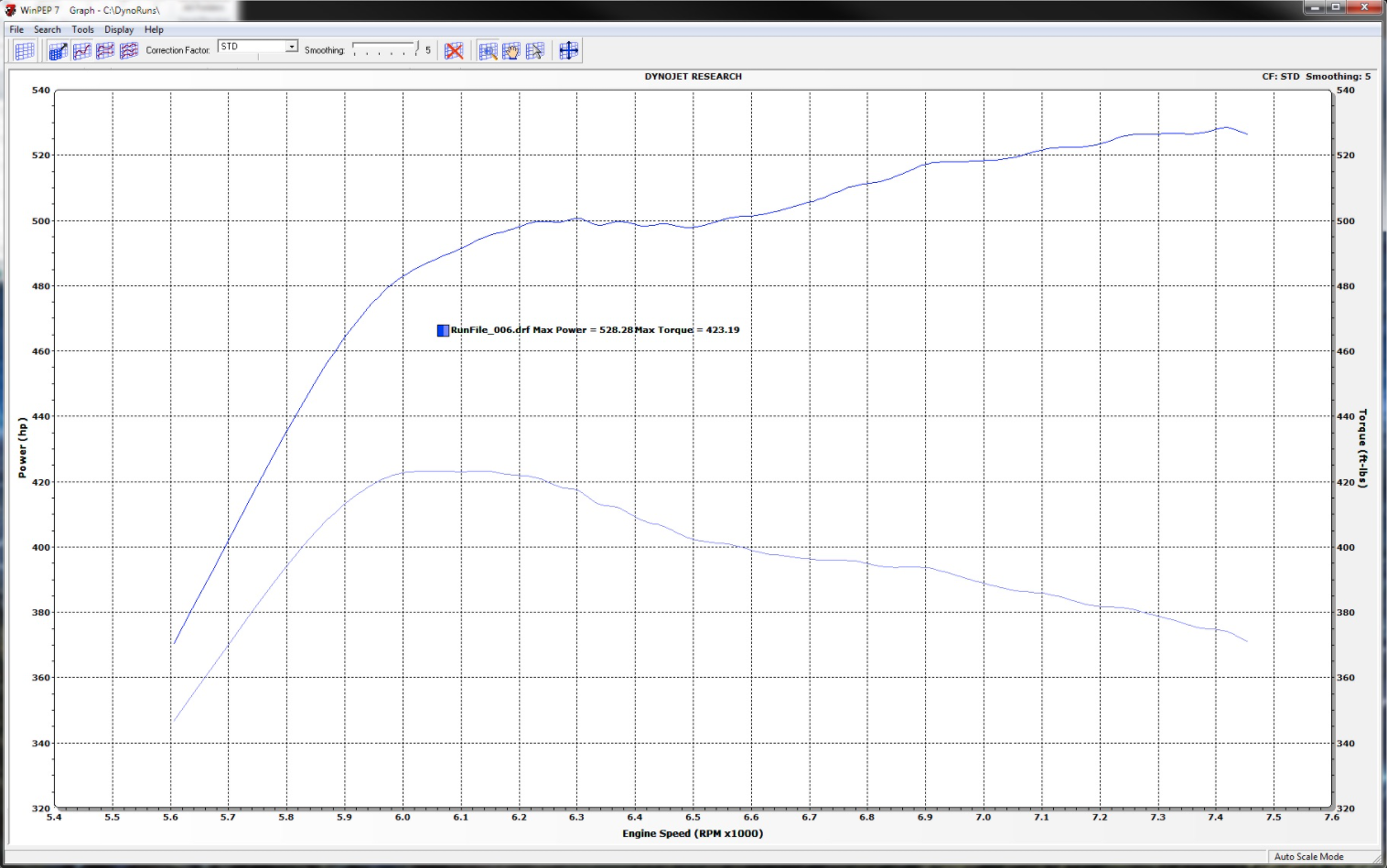

i went back and didnt see a Fast on the list. I just saw mention of the ported stocker which gained 1hp. Then saw the 8hp gain from the heads. The interesting part of this is the fact that 1hp gained with the ported intake gives you a window into how much air the head is moving. You could probably reverse engineer some flow #'s of a stock intake flowed on a stock or ported stock 823 head and look at where the .550-.600#'s are and guesstimate that is actually how much is getting used when the valve is open. Maybe
You can see in the pictures and dyno video that he had the FAST intake on.

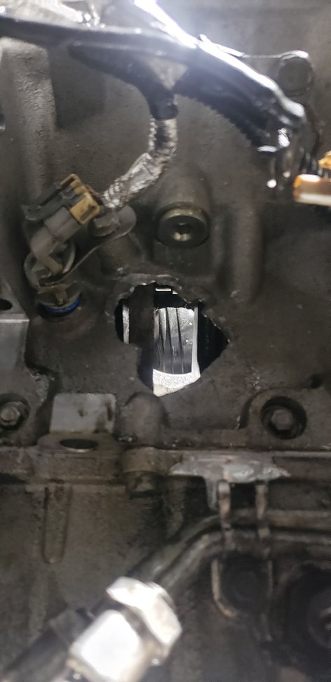

2nd pull with the stage 4 cam today . 11.8 afr and only like 23* . Had a catastrophic failure on decel after this pull. Well go into details tomorrow ! Big cam and e85 really woke it up.. there was ALOT left lol

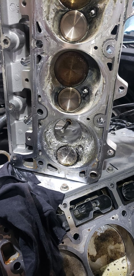

intake valve broke .

Not surprising. It was just gut feeling. I wonder what brand valve and the weight.
did it ruin the short block?

In the previous post it was REV solid stainless steel valves and if it dropped a valve.
Bloco is totalled . Nothing is salvageable.
They werent Rev intake Valves. I just got back from dropping the heads off to Hooper. He used a different brand. Hes currently recalling the sets he used these valves on . I'll be getting another set of heads in a week or 2

Originally Posted by Mavn
Ordered them exactly how he sells them. With the rev valves
Mavn, did you spec another valve, or stay with the REV valves?
Exactly why I asked this, although your saying he didn’t put REV in yours. After the dust settles, I’d be interested in knowing what valve he used in yours.
I thought he put rev valves in it. But I was mistaken

Originally Posted by Stampede4ever
Spoiler!
Is he covering the short block or anything?
Nah man this is performancr parts. **** happens . I'm glad hes covering the heads and getting me another set .
