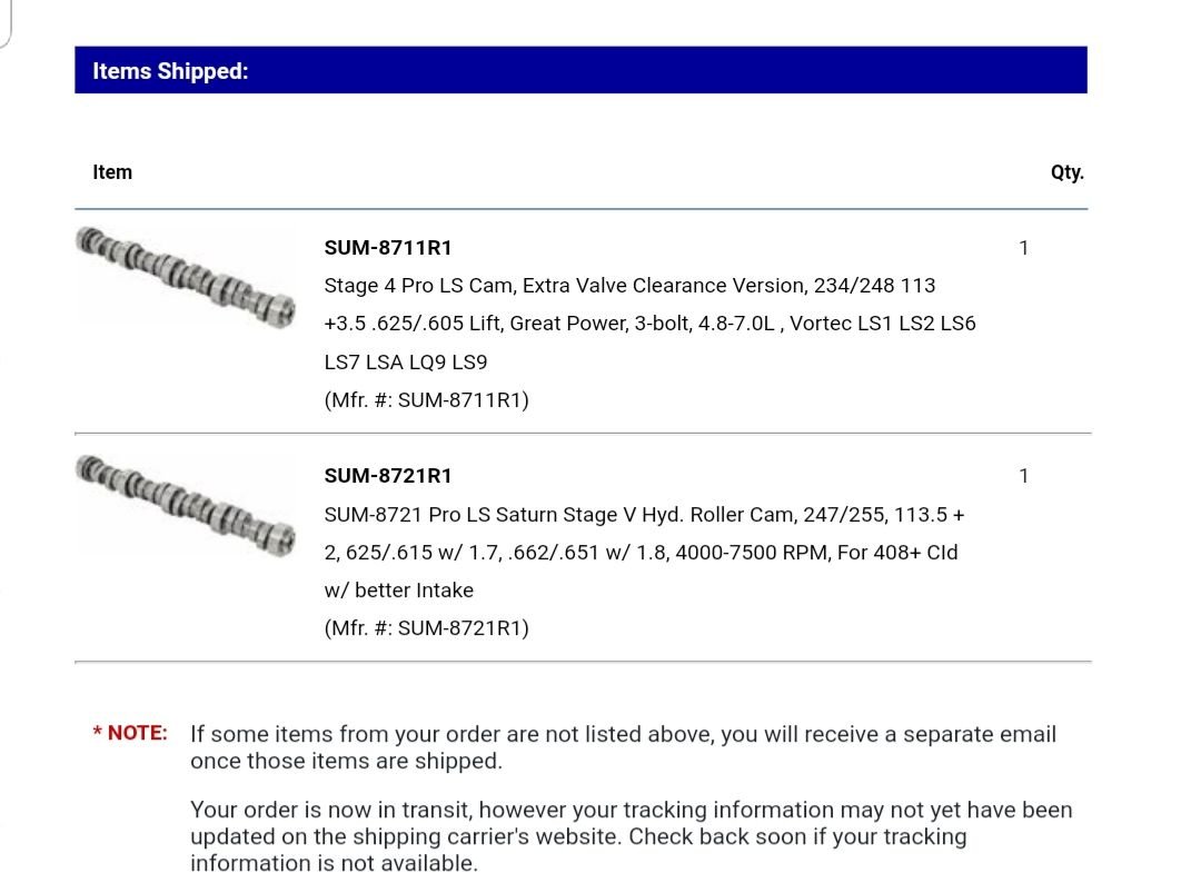

Whats the “what I want” goal?
low 10s n/a full weight with a/c . I want to do rocky mountain race week 11.0 class this year

I think the rodded stock intake and low lift cam contributed to the low gain from the heads. LS3 stuff needs as much lift as you can possibly get away with. The flow sheets show it on basically every version of LS3 head I have seen. If you didnt already have it coming, I would throw the hyd roller stuff out and go solid w/ a ported Fast and turn it up. .700 lift and supporting intake would do wonders. If you wanted to calculate the 8hp, I would look at your flow sheet on the Hooper heads and lay it over a flow sheet from similar set of OEM's. W: that .600 lift cam, you are probably getting barely a true .580 at the valve.

I have yet to see anyone actually do it, but I have a theory that a solid roller w/ .700-740 lift on the intake, mid 230's duration w/ a ported Fast intake w/ ported stock 823's can make an easy 580-600whp. Maybe a touch more. Every combo I see has a max .640 lift hyd cam w/ .660 springs which means you never get to the sweet spot of that head. Honestly, that head is just getting started at .600.

my current cam is equivalent to a hydraulic 240/256 duration cam. Knock 6 off solid which is 246/262 .689/.672 112+4 with a 1.7 rocker

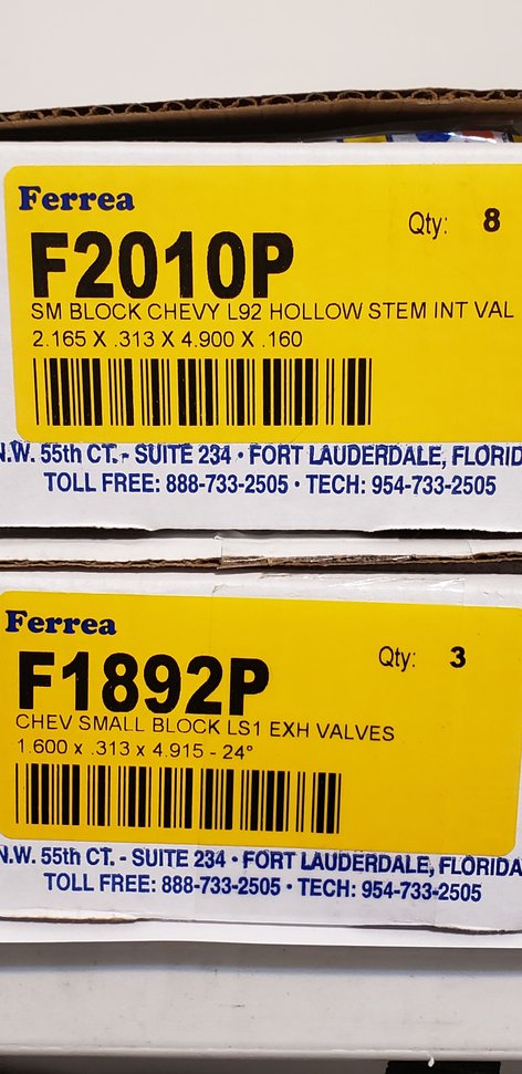

Spring settup and roller rockers for sure. I would not attempt this w/ stock hollow valves. I would go straight to aftermarket everything short of the head itself.

F2010P's come in about 9 grams heavier than LS3's but have thicker walls than the stock valves.
