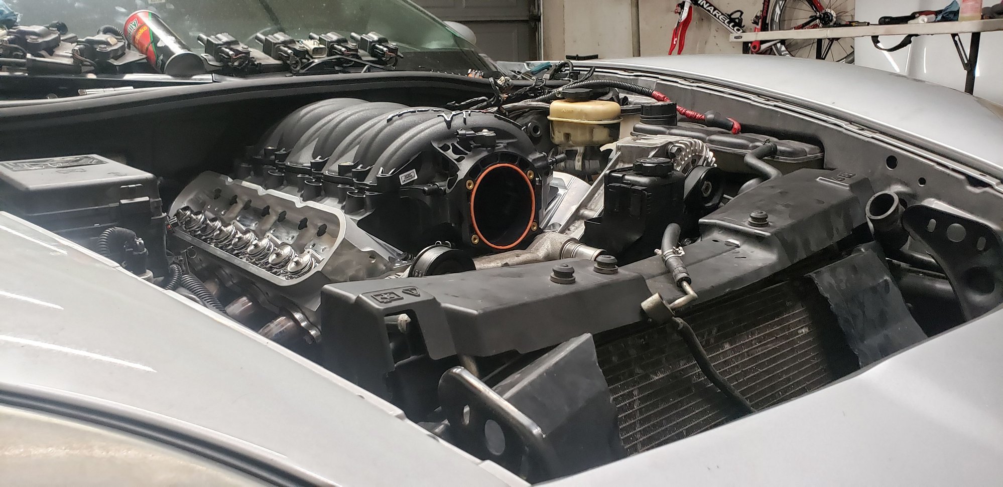

Push rod length tool will be here in a few days so I cam get the right pushrods ordered. I also ordered a 102mm TB and a catch can ...and I picked up a Fast 102 for stupid stupid cheap. Fast is going to get port matched by Shawn this weekend! Guy dropped a valve and there was piston all in the intake. Quick trip to the car wash and shes good as new. These things are fun to take apart when theres metal and oil everywhere !
Car Wash Looks good!
Damn, I want one of those!! Looks good, why can't find deals like that.lol.
