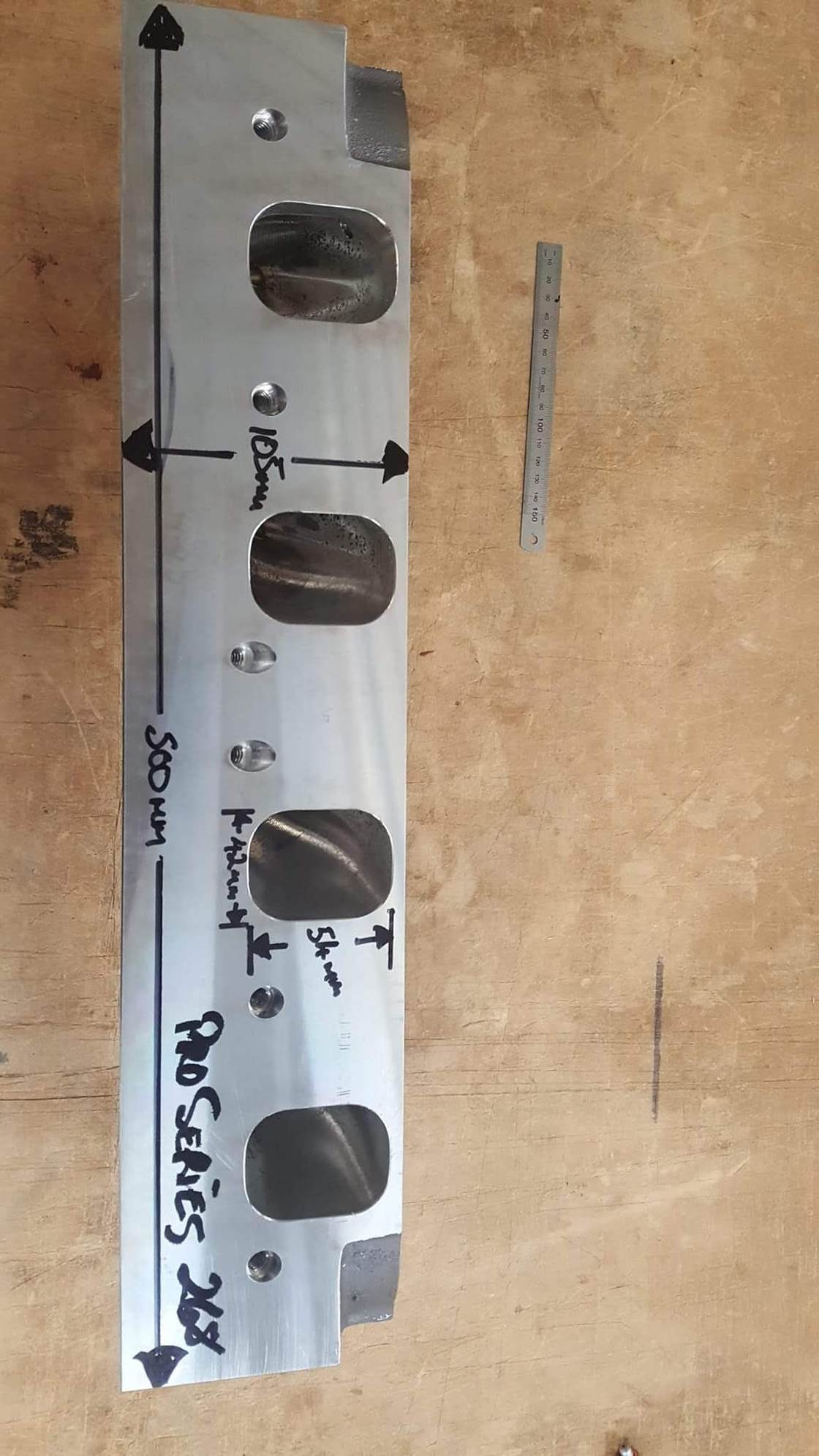

This is an interesting build. I have a TBSS 2wd also and am doing build now. I built the shortblock a while ago, just a LS2 .005 w/ Eagle rods and Racetec pistons, new stock crank. I have looked at tons of heads, all types-cath, LS3, LS7. I keep seeing the 11degree LS3's, stock/fixed/ported oem LS7's and the serious cathedrals make the #'s, both on the dyno and on the street. Will be interesting to see how ths pans out. I think a Mast 11degree LS3 will do better, espeically w/ new Fast LSXRT LS3 intake out. This is the direction I am going.
A side note, i have heard the new Brodix BR1 cathedrals are killers, also have no idea what the csa is, but has to be close to the Mamo 235's(dont go by the volume, the csa is more critical-paging Corona). They are flowing easy 370cfm w/ a 2.100 valve.
Would be nice if ER would comment on this, as well.
I think the other heads you mentioned might make more power up top but this is going to be 90% street 10% race as the local tracks are all about a hour and a half away. No trailer so drive there and drive home as well so I didn't want to have something to peaky or having to lose a lot of that low end. I'm happy with the choice I made even if it left some on the table or not.

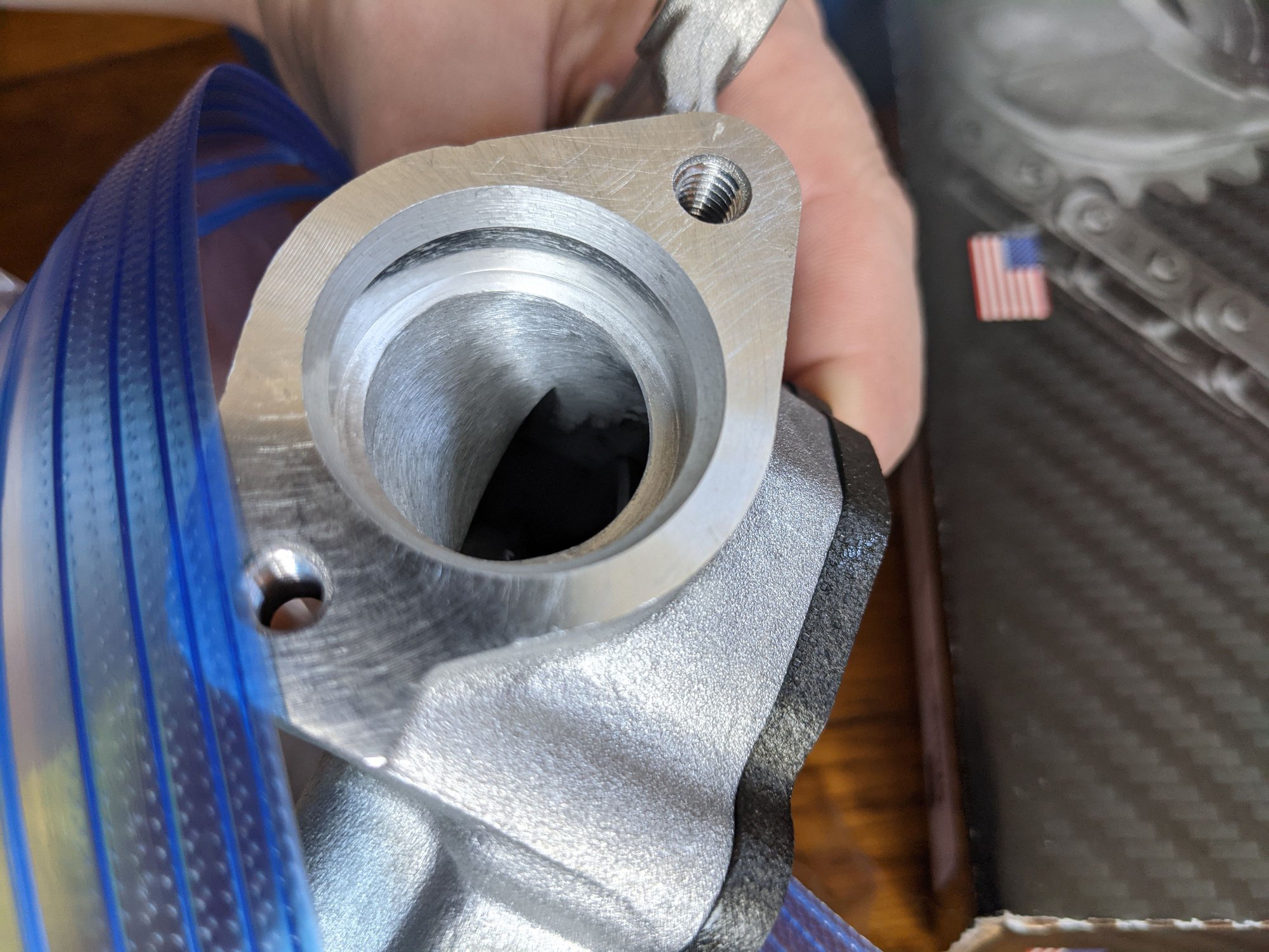

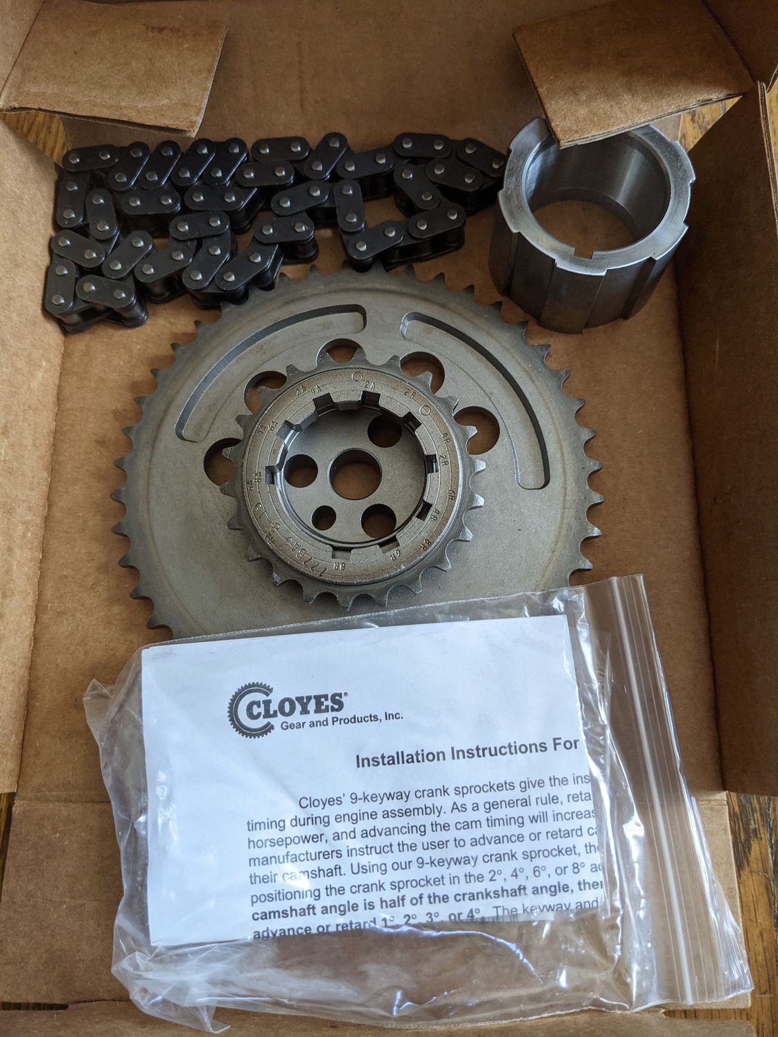

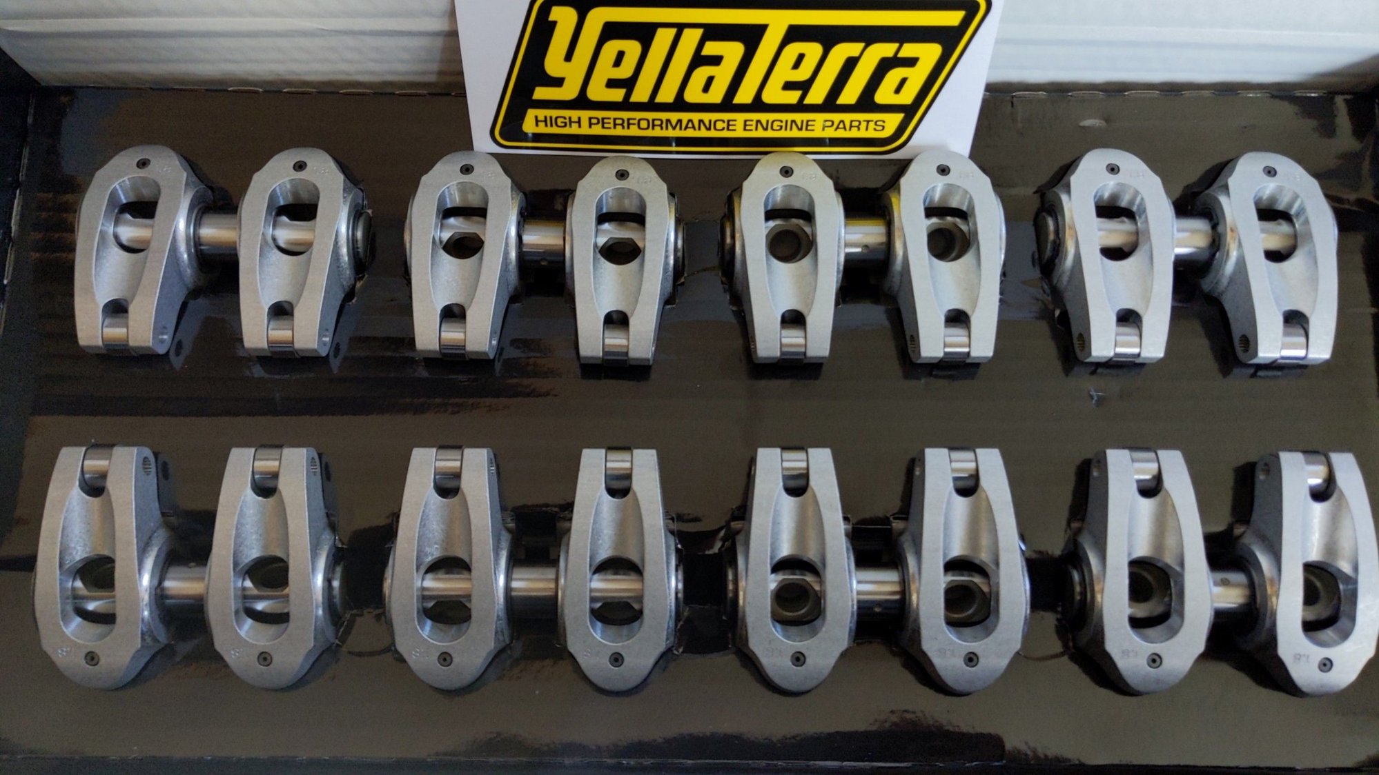

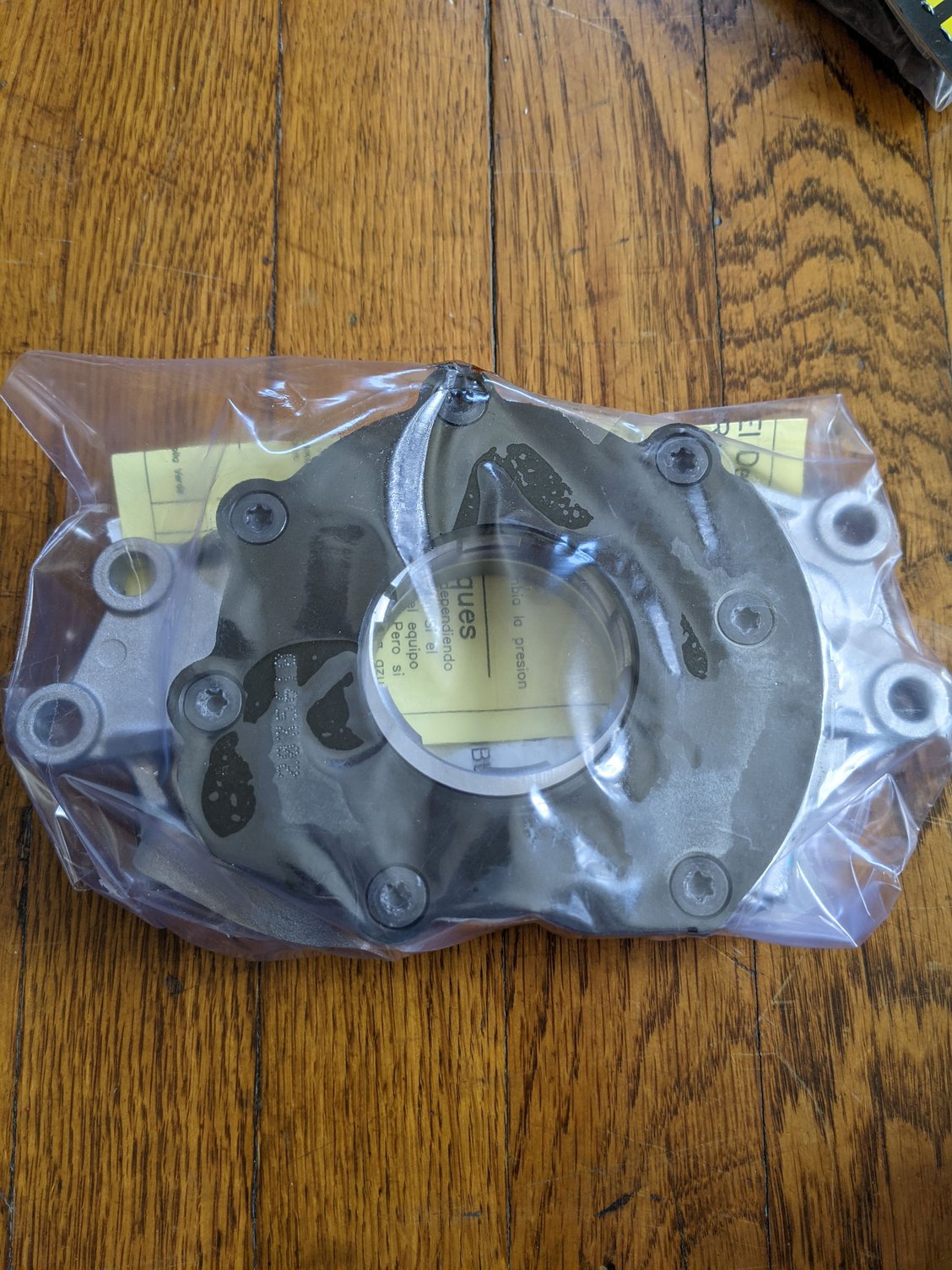

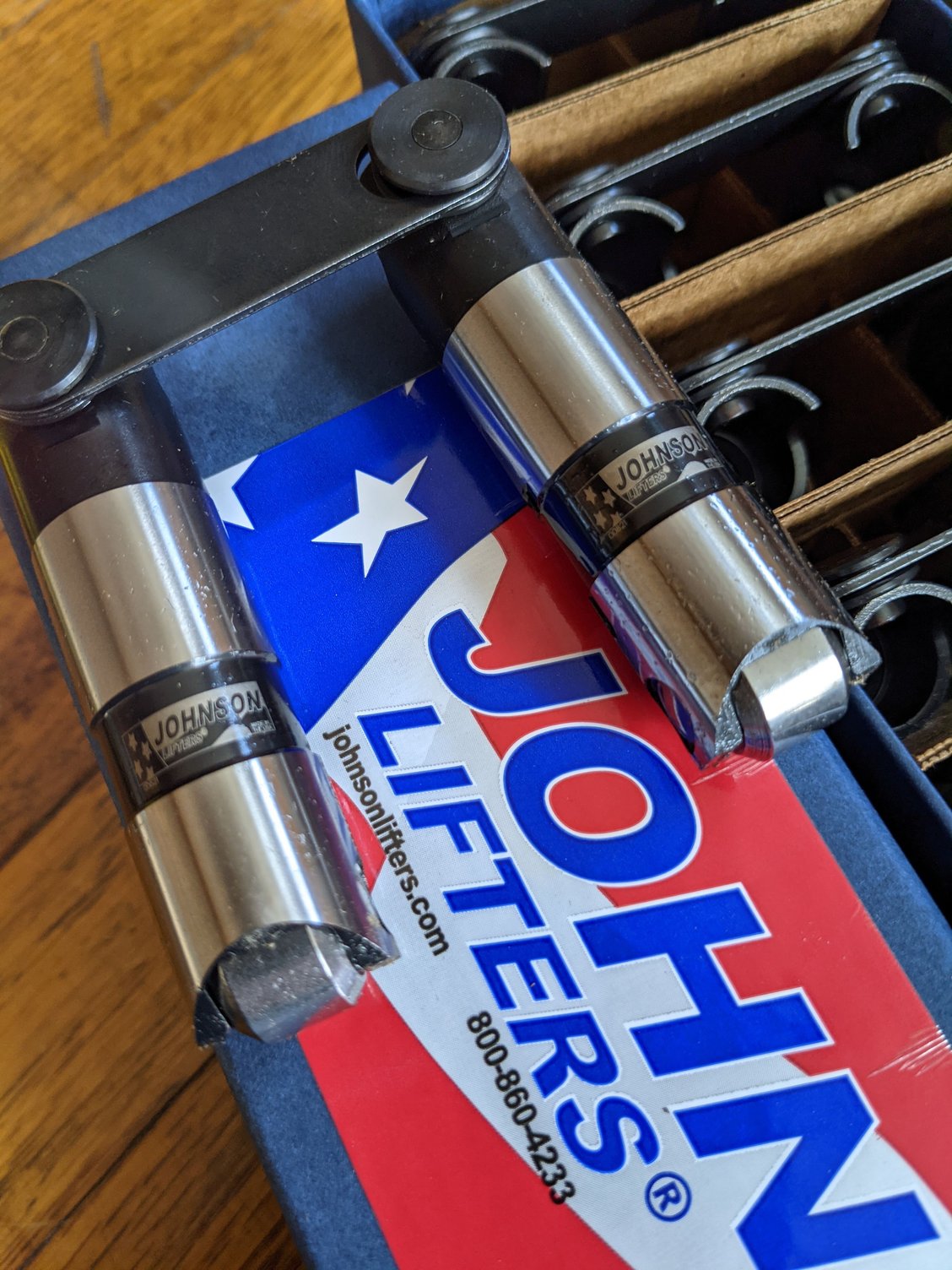

Some goodies showed up yesterday!
