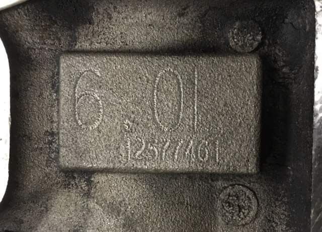

My block is at RED right to be sleeved to 434 ci.
Steve knows exactly how to drill main webs for breathing.
I won’t have my block for awhile and don’t have pictures of main webs.
Check Steve’s reply post #29 in https://ls1tech.com/forums/generatio...lem-block.html
Pictures of my block’s casting.

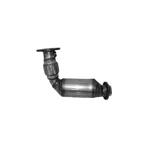

The G8 had a terrible restriction in the exhaust. It got necked down to 1.75" roughly as it came into the 'TOP' of the cat converter and then out the back again. So both necked down and a bad turn. Headers on the G8 along w/ a good tune are worth a TON.
Some say this was done intentionally to not encroach on the halo car's power (vette).
