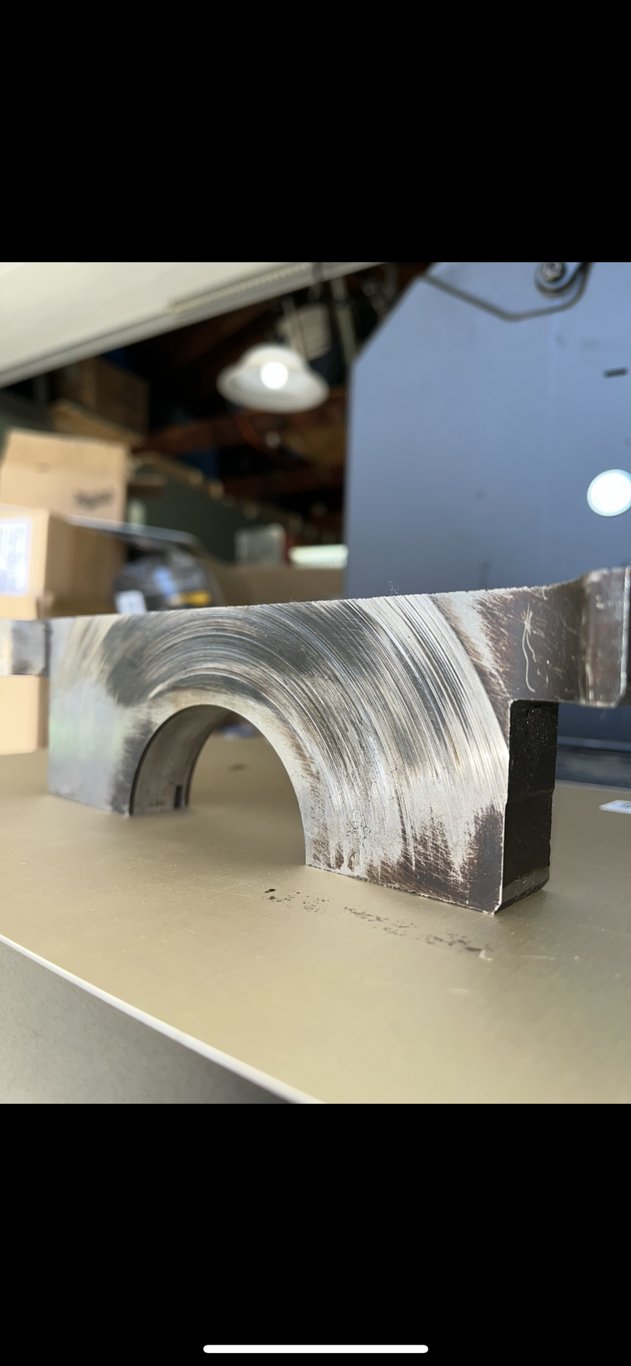

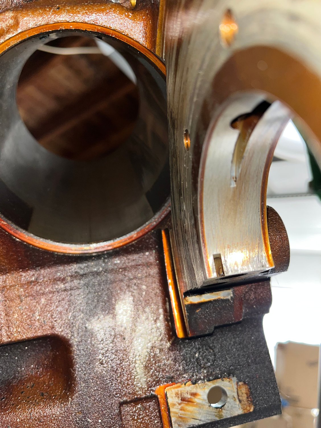

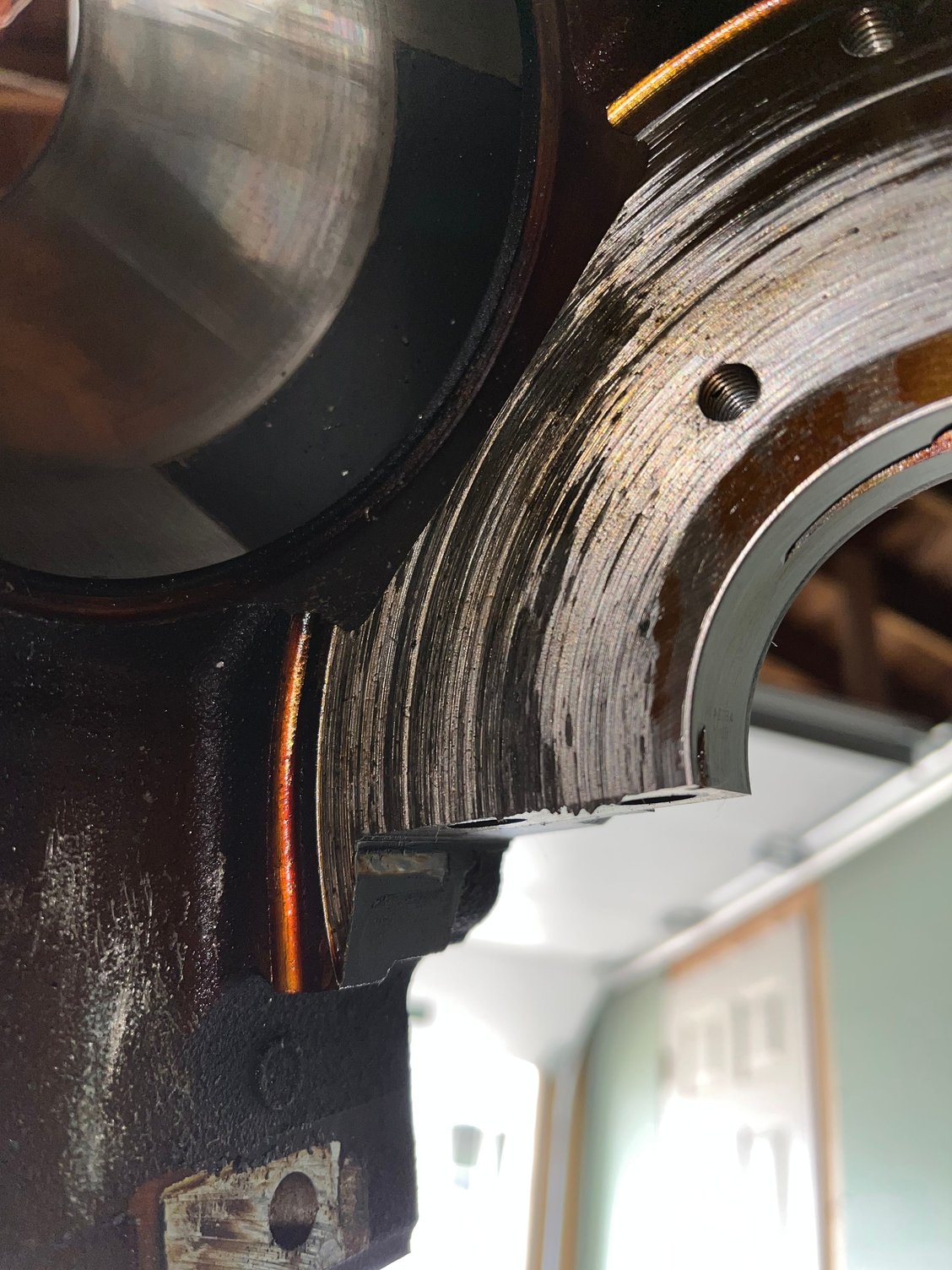

Received a block in trade and not sure if Im completely sol on this one or if this is something that is in un useable condition to rebuild with or is something that is worth being repaired if possible? Thanks in advance

I would think it is okay to use, nothing runs on that part of the cap. Was that the cap at the rear of the block? Looks like someone installed flywheel/flex plate bolts that were too long.

I was thinking the same being everything is pretty snug to the crank once theyre all snugged down to specs. I assumed with a good clean up would be useable but honestly not sure. This is actually the front right side of the block on the back side of the front cap and internal where the cap connects too

As long as it didn't spin the main bearing or wipe out the thrust face it should be fine. Either the crank bent and wiped the block or it broke and did that.
Just have a machine shop check the line bore.

The block is probably useable, but that main cap is sketchy. Not sure what to tell you on that one. I wouldn't put 1000hp through it.

my question is why only at the front? if a thrust bearing went all the caps would hit? would they not?

Get another main cap, have a shop align hone the main tunnel, and go to town.
