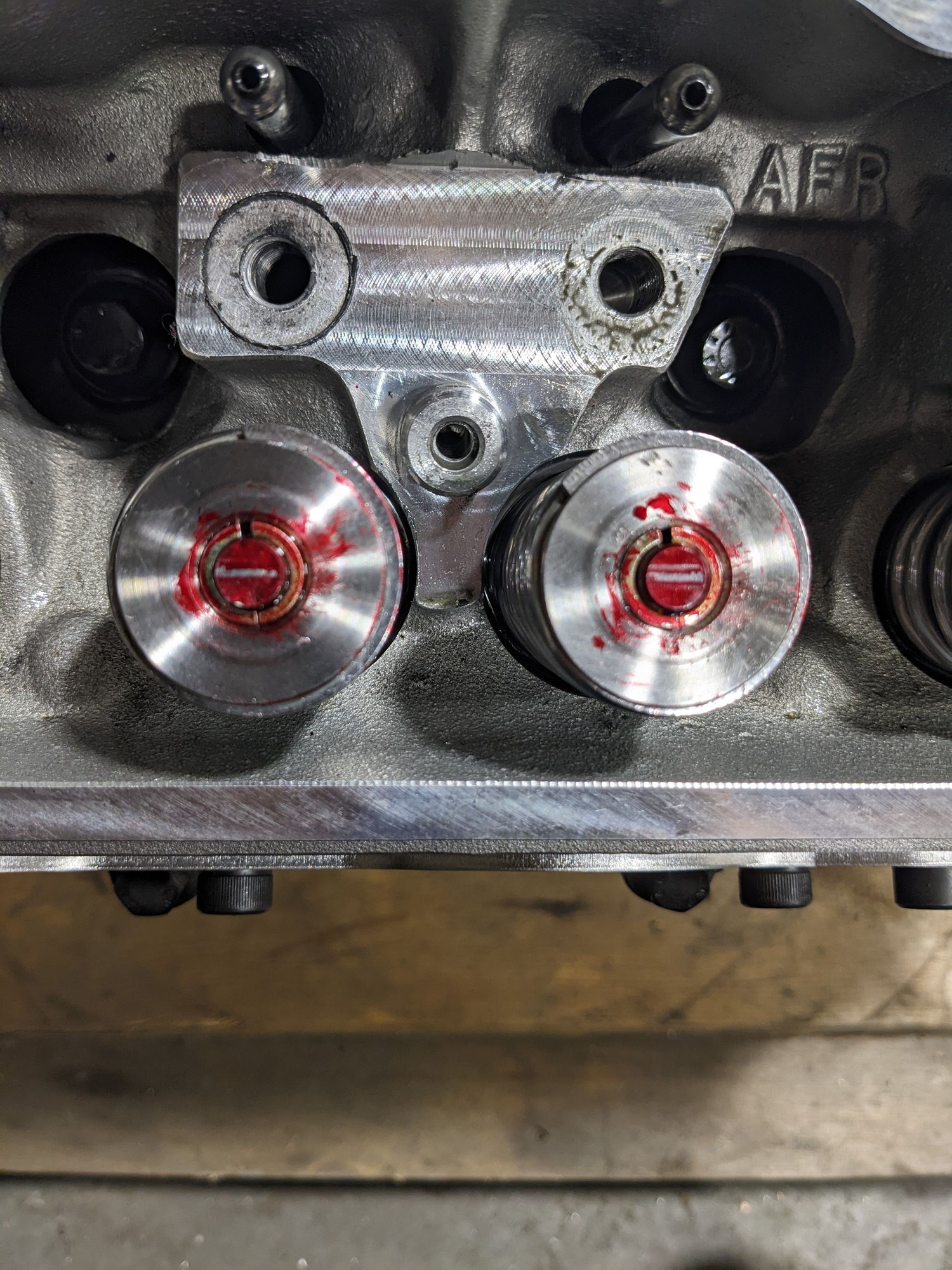

Well I haven't had much time to do anything lately. Went on a giant road trip in by buddy's 64 Rambler with a 5.3 swap that ended up at LSfest. Before ripping everything apart, I figured I would check the wipe pattern thinking maybe it runs well but it could be off to one side. Here's what I got, pattern is about .80-.90 wide.

That's certainly not ideal. Not horrible, but....to change it you would need to shim the rockers up some. Making it necessary for a longer pushrod.

That's what I was thinking exactly when I saw it. Certainly explains the short pushrods.

Upon further research, it appears there are NO shims under any of the rocker pedestals at all. From my understanding the YTs come with .062 shims. I grabbed a couple 3/8 washers from work that measured .056 and put them in, obviously the pushrods are a bit too short now but I turned it over slowly and got what looks like a much better wipe. It's centered better and much narrower than before. I sent a email to YT to see if they will sell me a package of shims.

This wipe pattern is nice. How thin the pattern is is more important than the location of the pattern. Meaning…if the pattern is nice and thin, but a tad high or even a taaaad low is ok. Thinner is better. Obviously centered and thin is best, but not as important simply thin and slightly offset.

1. by minimising the sweep you set the geometry at midlift-square. you get the highest lift out of the cam. the difference however is marginal. by having a wider pattern you get better wear, if it matters. there is a simple, direct method of setting up middilt-square, btw.
2. setting the pattern exactly in the middle is not really optimal. the highest valve tip force occurs approx. 30° after open at high rpm. (accleration, jerk and jounce of cam lobe are highest.) so that point should be in the center.

Well it took me a long while, dealing with personal stuff, getting locked out of my google accounts and not being able to access anything. etc. but I have finally gotten around to finishing this long project. I ended up measuring all 16 pushrods and ended up with a pretty narrow spread. Probably why there was no issue with the pushrods all being the same size before. I did add .062 shims to get a better wipe pattern and ended up with (5) 7.611 and (11) 7.616 pushrods. I contacted Tony Mamo and had them on my doorstep from Manton in only a couple days. 11/32 .120 wall.
