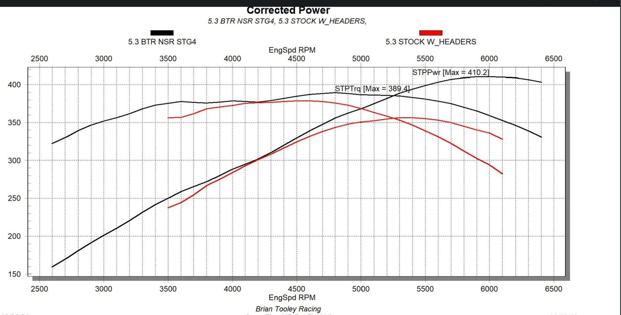

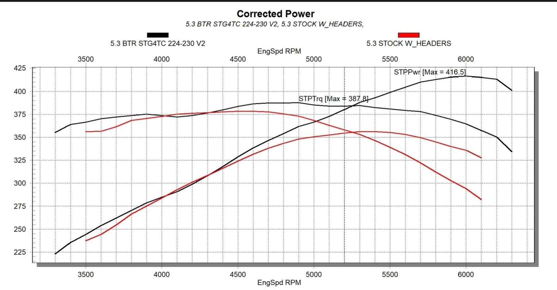

There's a pretty fair amount of dyno comparisons to look at to gage roughly what extra lift can be worth. Some depends on heads & intake etc being optimized to take full advantage of say an extra ~.050 or so of lift.
Here two nice examples from BTR, both are 224/230 stage 4 cams. The first graph is the 224/230 NSR or No Springs Required cam in a very stock engine set up with headers.
Low lift No Springs Required cam
SPECS: 224/230 .480/.480 109+0
The second graph is for the higher lift cam SPECS: 224/230 .553/.553 109+0
There are other compares if one wants to dig.
My thoughts? Rule of thumb? Conclusion?
Spoiler!
I'm with you on lift. If you have 2 cams with identical duration figures@.050" lift, the higher lift cam has a much more aggresive lobe, and should make more torque/power under the curve, IIRC, which may not be the case!!!!!
