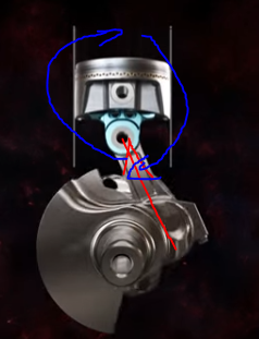

At best these are absolute B.S, but its looking more like a SCAM. They haven't built an engine, or a test bed, or anything like that, they have made some CGI animation in Pro-E, and a WAIT LIST, that's it. Absolute scam.
I love how it says it will eliminate piston rock when it will put a MASSIVE torque moment on the piston as it goes up and down. Gone is the side-load, now we have SIDE TORQUE!!!
