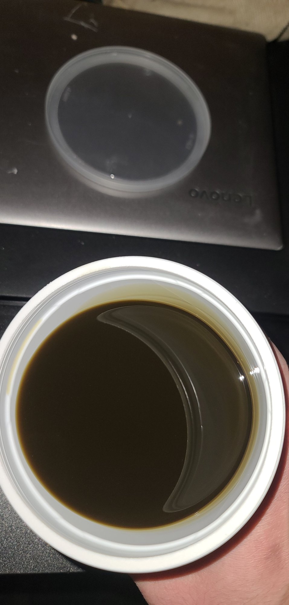

@Che70velle awesome info. I don't have aftermarket electronics. Regular gauges/sensors and I have both aeroforce interceptor/hptuners Mpvi3 as well as the gauge on my dash. Checking on clearances with my engine builder tomorrow. It's a brand new pump so I don't understand why it would fail immediately. Melling told me the pump should sit between 60-100psi under heavy loads. If it stays within that I'd call it good. I have yet to bring the car into heavy boost, so in the event the pressure is still high, I will attach a mechanical gauge and compare with my data log. I got my oil changed tonight and there was some silver metallic streaks, honestly less than I expected for a break in. I could be wrong but I believe the sheer pressure (if it's real) supplied by the pump forced the oil where it needed to go at least for now
Old Jan 12, 2023 | 11:04 PM
Xoars's Avatar
Joined: Aug 2019
Posts: 11
This has sat for about an hour, but this is the oil that came out in the middle of the draining.
