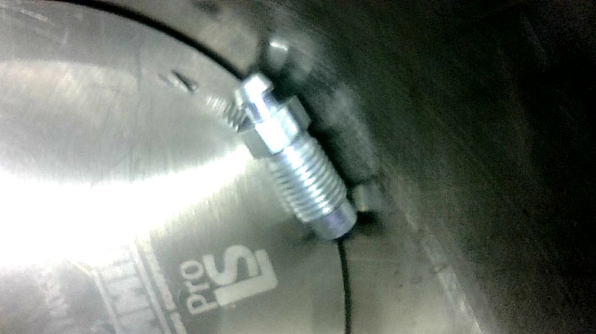

Default Found the reason
I absolutely can not believe it ! This thing was tapped up the entire time... guess I should take this as a learning opportunity. Bunch of people telling me to still run it. Looks like it dented the piston though.
Old Feb 14, 2023 | 10:49 PM
  #43
Posts: 7,815
Likes: 5,151
Holy!! Someone dropped that brake bleeder in the intake port while you were away. I seriously doubt that this will cause any problems down the road, but if it were mine, I’d take it back down and polish the marks down. Might want to check the chamber also for marks.

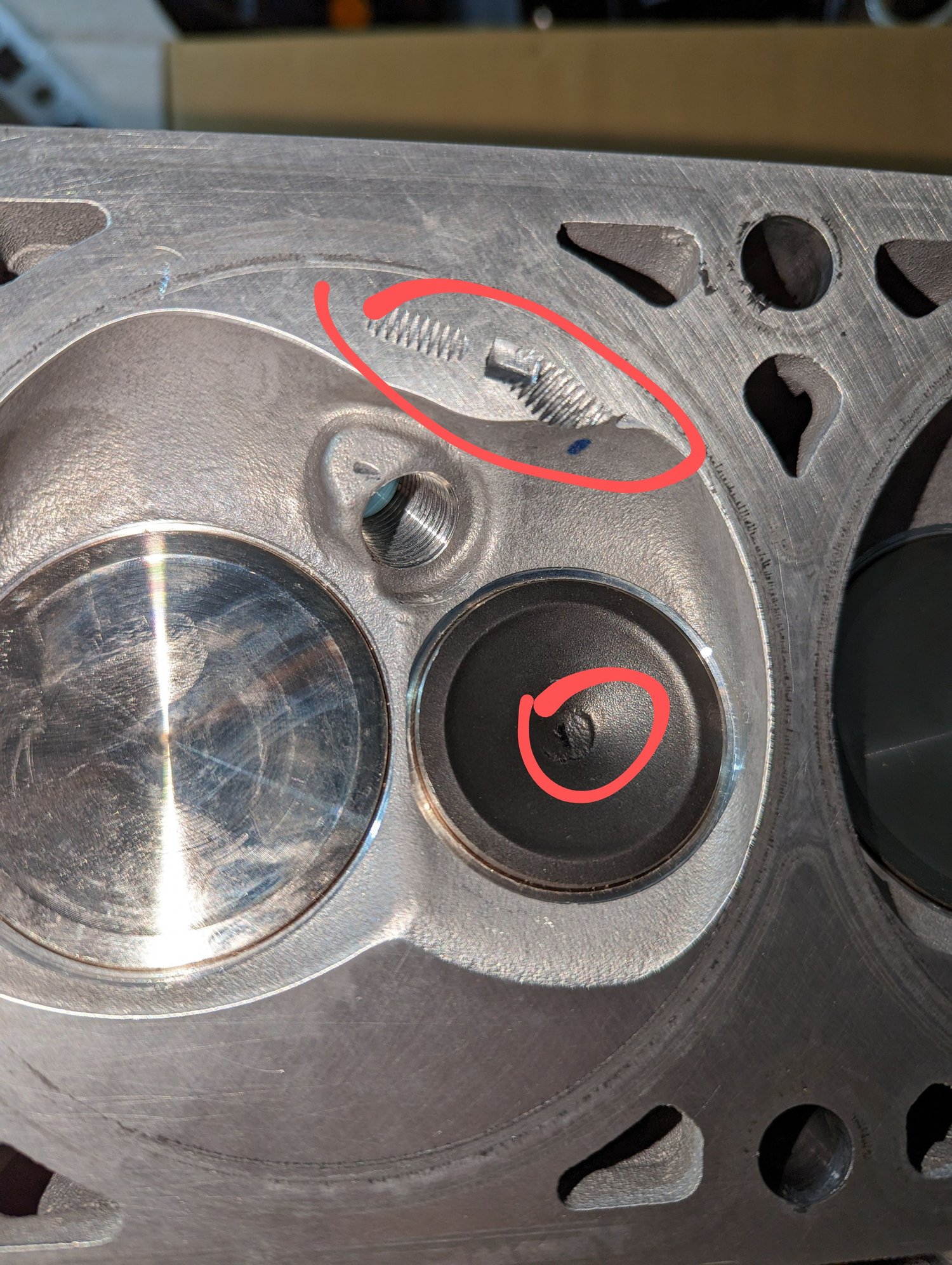

Guessing I'm gonna need to receive the piston wall. Do you think the heads can be fixed ?
Old Feb 20, 2023 | 05:19 AM
  #54
LS1Formulation's Avatar
Posts: 3,865
Likes: 1,122
From: Grand Rapids, Michigan
The head can be welded and resurfaced, certainly. Get the valves checked, might have to replace one or both. If it seized up hard enough to crack the cylinder wall, I'd be checking the connecting rod for bending too. Summit sells individual pistons, so you're good there. What block is that? Might be more economical to get a different block. Sorry to see that, it's a real bummer.

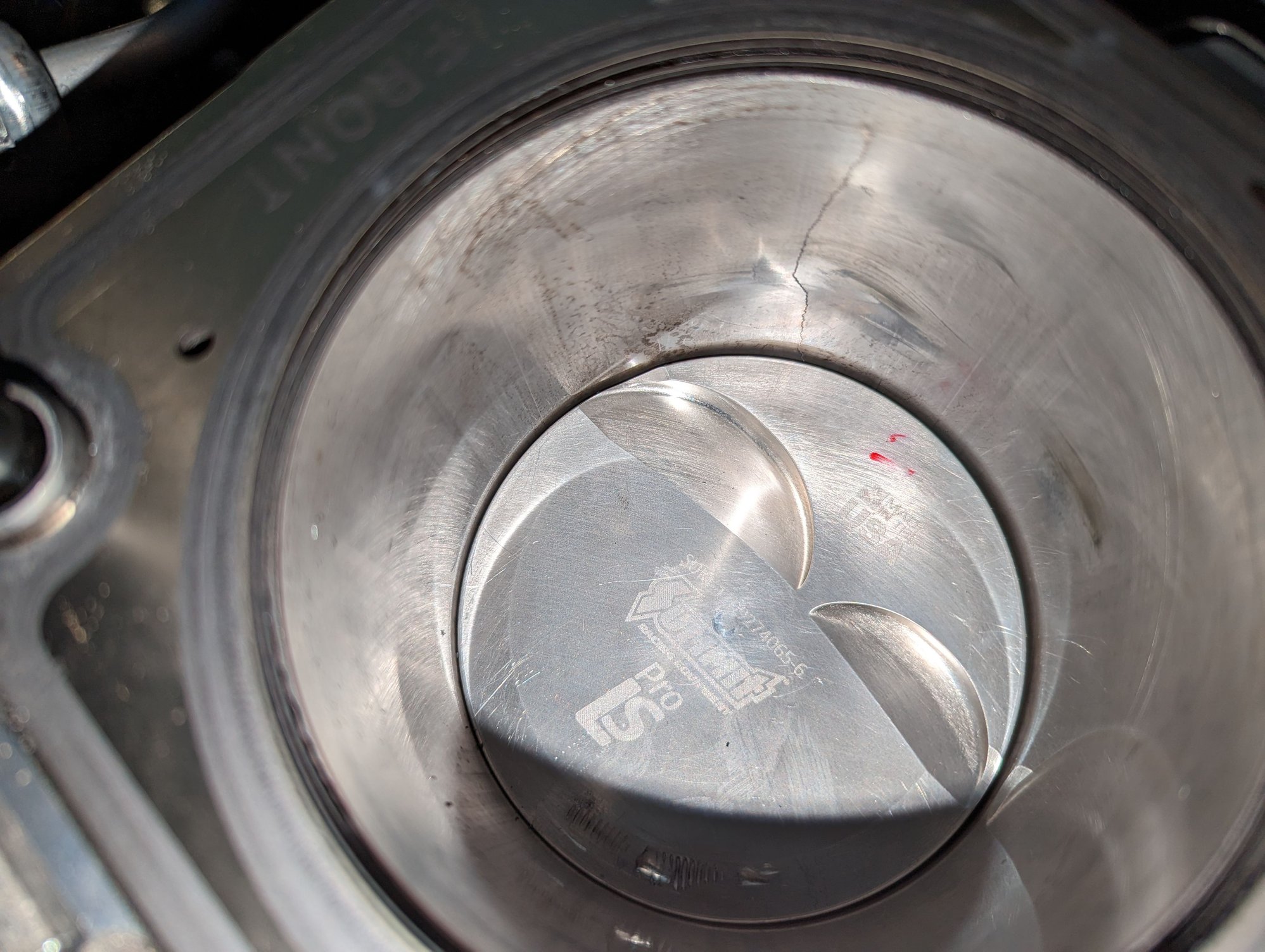

That bleeder screw didn't cause the sleeve to crack and put water stains on it.
Did you buy this already assembled?
It may be a bad picture but that piston looks too small for the bore also.
It does look like a standard piston in a +.005-.010" o'size bore! Must be an optical illusion...
Old Feb 20, 2023 | 02:41 PM
  #58
84ta406's Avatar
Joined: Feb 2009
Posts: 283
Likes: 191
From: Worcester, MA
Agreed, there is no way that crack happened from the bleeder. That has been there a while.

I do think its very possible the piston getting wedged under the force of the starter motor (and the speed and torque it developed even in that short distance) could have thrust the piston skirt so hard into the cylinder wall that the sleeve cracked (its not out of the question and is really the most likely situation here)
Look at how hard it embedded that bleeder into a hardened cylinder head.
Also don't weld it IMO.....the heat from the weld removes some of the heat treat from the casting (making the aluminum softer there). I would just sandroll it a bit and knock off any sharp edges....don't go digging at it....just clean up anything sharp and put that right back on the engine.
You want see any loss in power or performance. Make sure its not raised off the deck either when your done....slide a straight edge across the area and make sure it isn't hitting a high spot.
Welding can compromise the integrity of the casting...to do that just so it looks pretty when you reinstall it is silly IMO.....where it hit it wont effect flow and performance.
Good luck getting things fixed up
