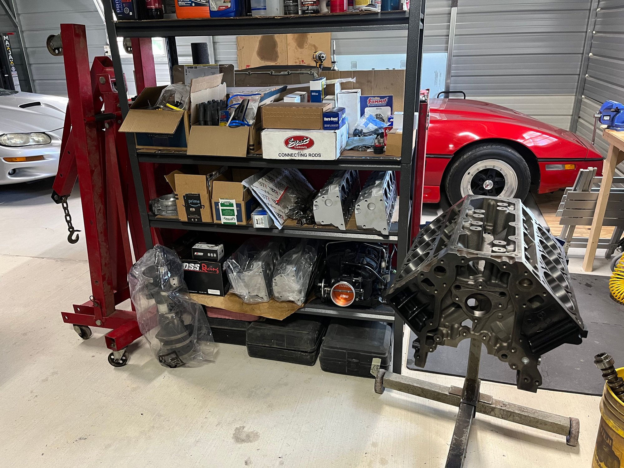

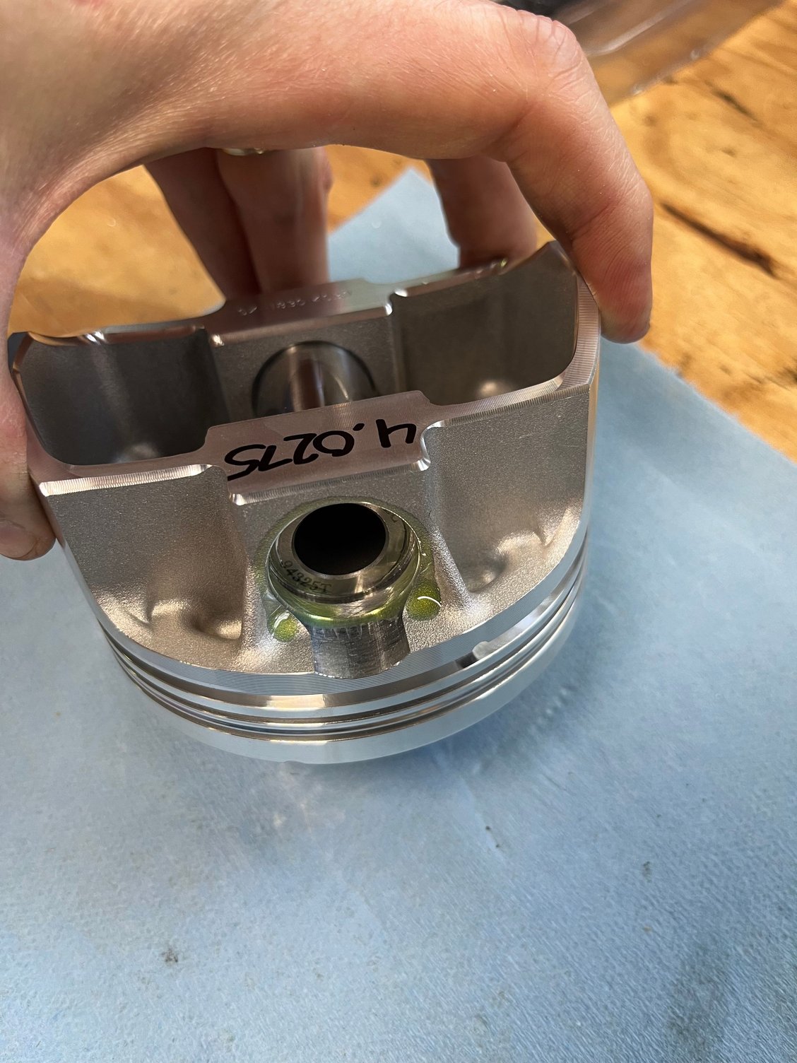

I just got the engine back from the machine shop. They bored/honed it to 4.030”, balanced the rotating assembly, decked the block, and milled the heads. Now, it’s time to make some power! 😁
This is going into a C-10 swap for a customer. It should spool a turbo quickly with the Summit “Ghost cam” and LS3 top end. With the heads milled to 67cc and 5cc pistons, it will be right at 10:1 compression. I’m guessing it will make about 500hp N/A. Anyone else want to guess what it will make?
Shelf full of parts.

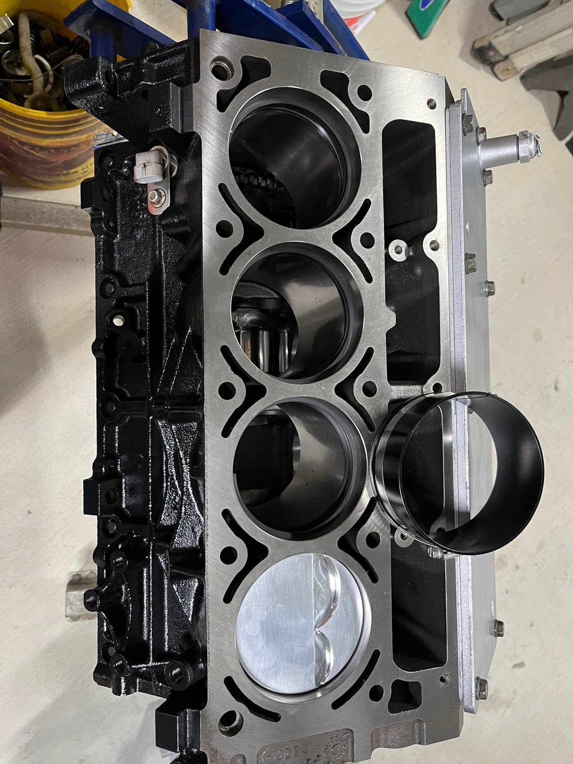

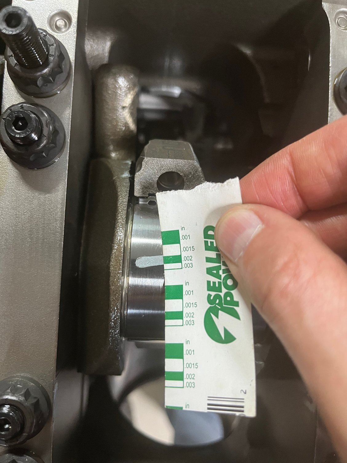

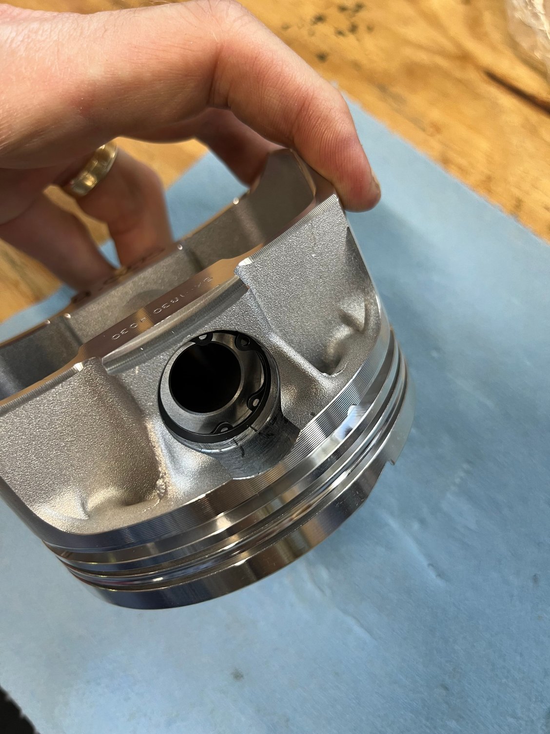

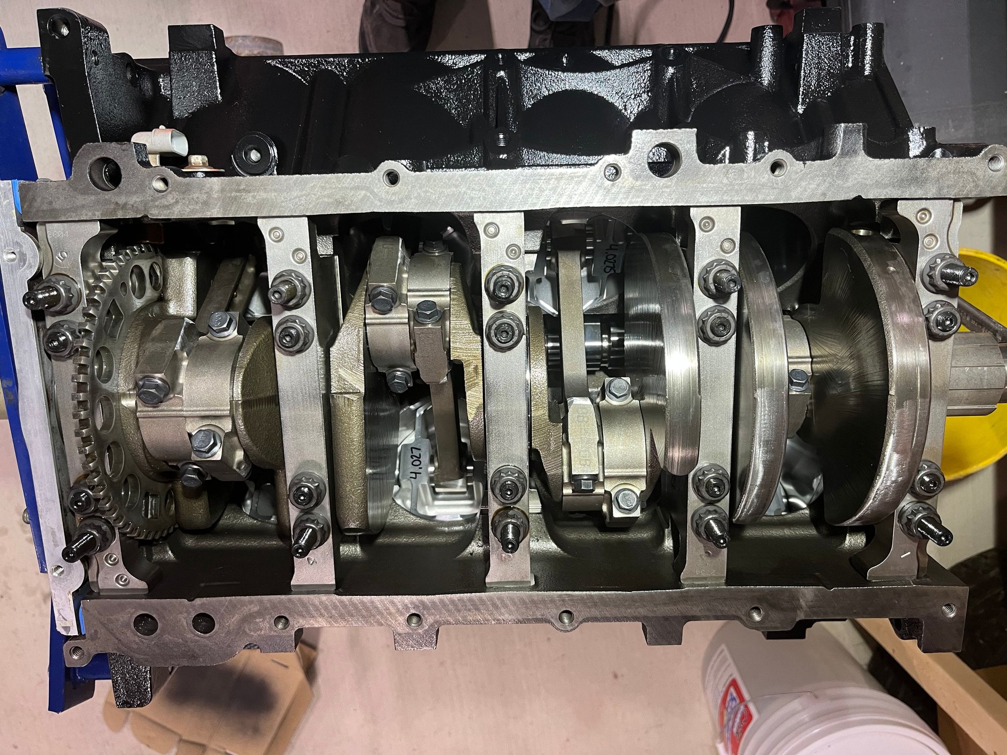

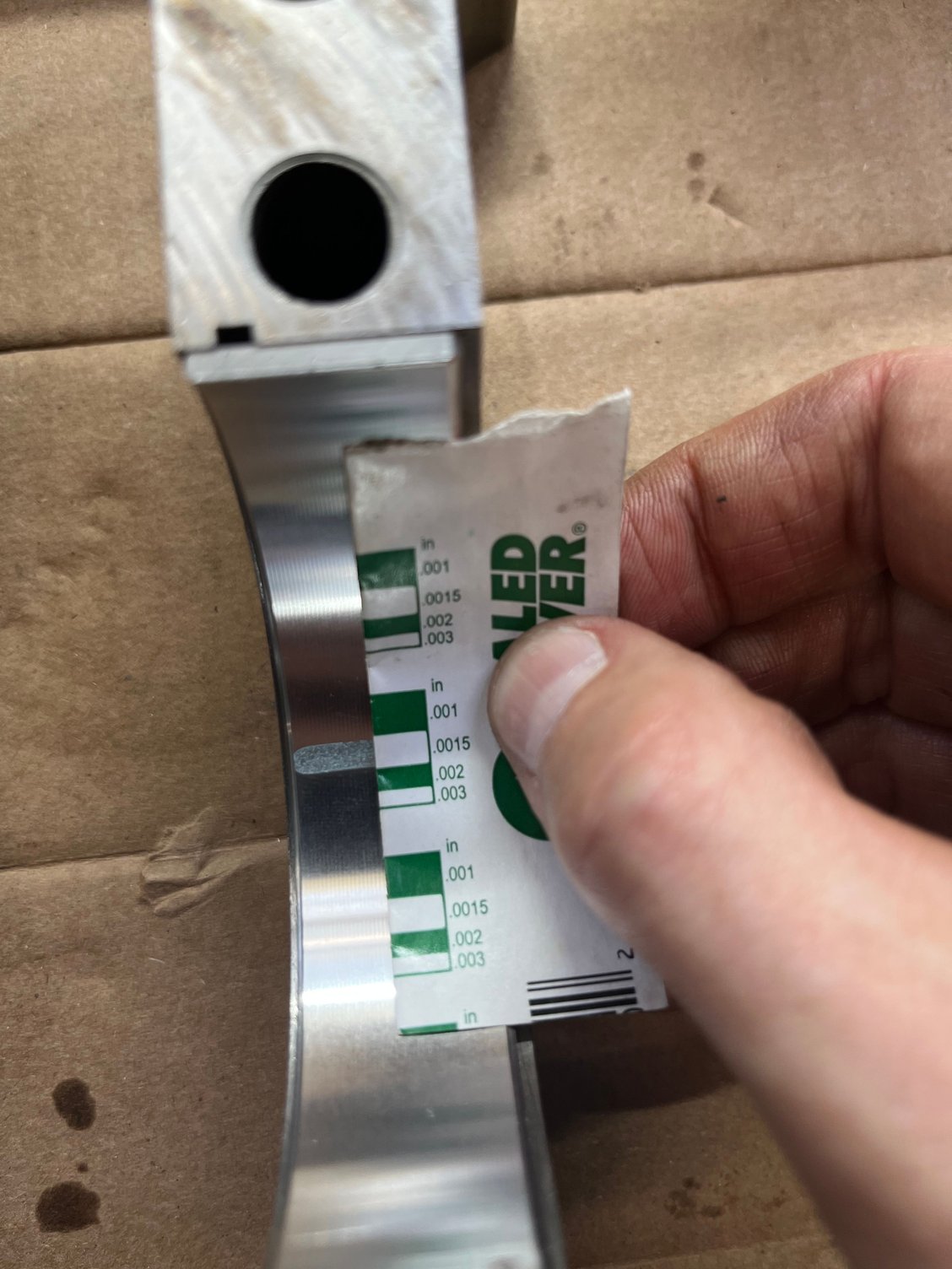

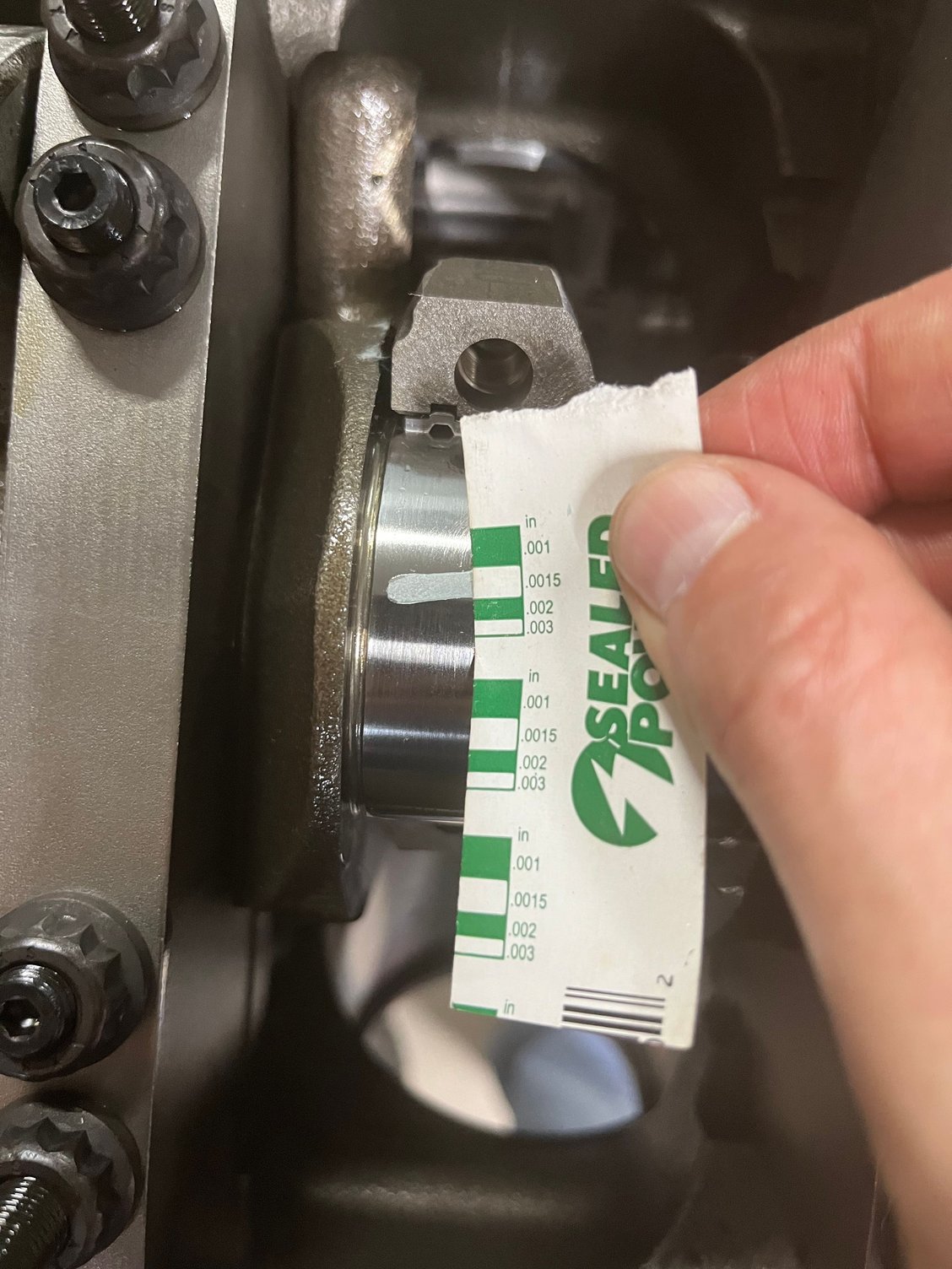

I got the cam bearings, cam, main bearings, and crank installed. The bearings gap should be good for 10W-30. I’m about to get set-up for gapping the rings. Going for .026” ring gap.
Old Apr 30, 2023 | 06:58 PM
Utinator's Avatar
Joined: Dec 2017
Posts: 1,034
Likes: 224
From: San Antonio

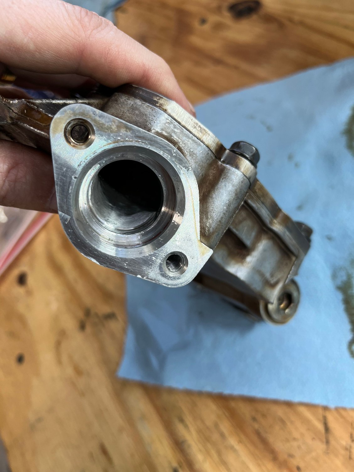

I got the rings gapped for boost, wrist pins installed, and the oil pump ported this afternoon. I'll probably put the rods on the pistons later this week. It was a productive weekend, but I gotta go back to my day job tomorrow.

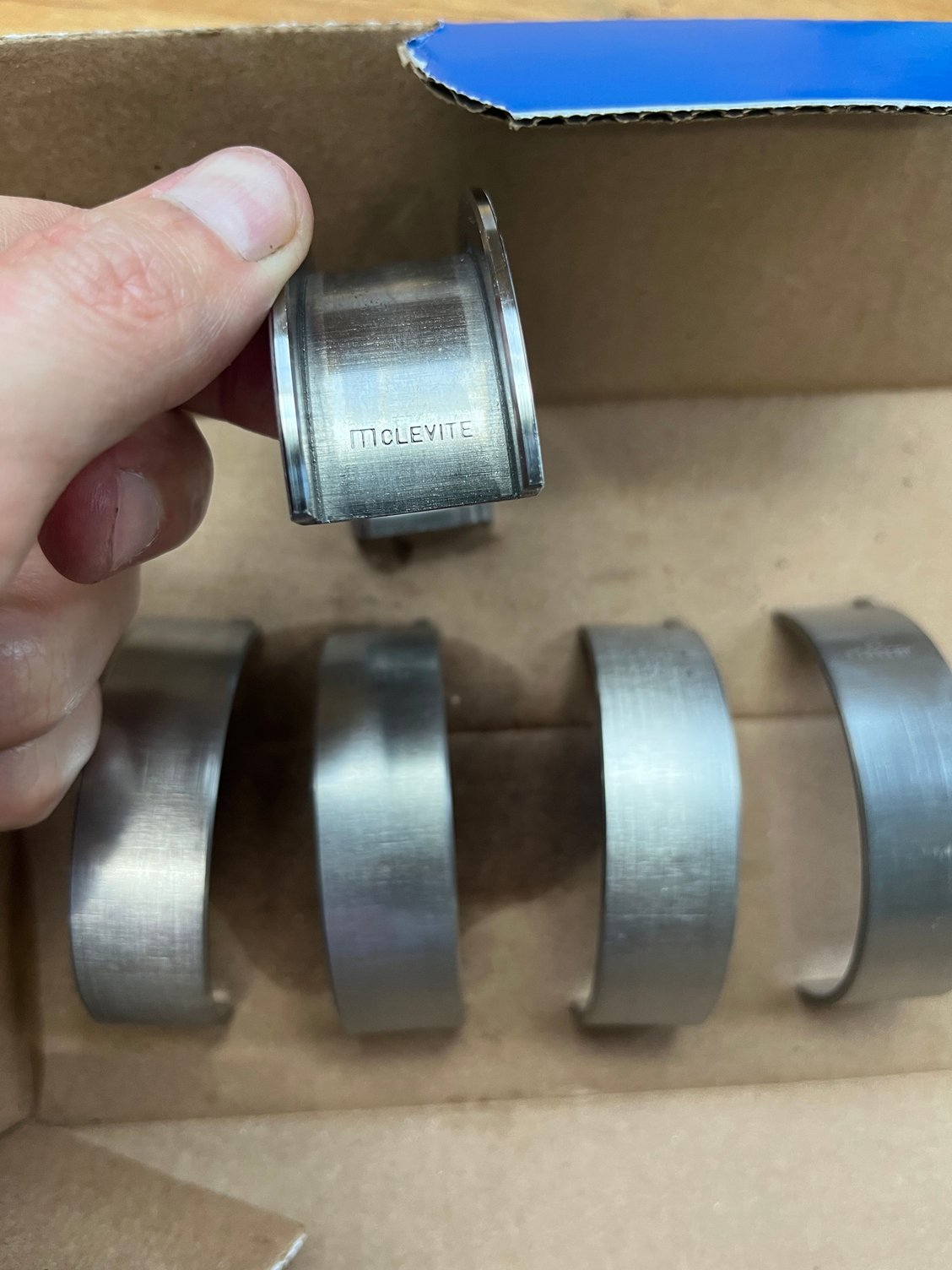

I would say you are a touch tight on the bearing clearances for a 900hp build. Also, why the basic P bearings? I would put hardened X bearings on the rods for sure. I usually shoot for about .022-026 mains/rods on.a boost build. The rods need the clearance more than the mains, but having both gives it all a little wiggle room when things get spicy.

Bearings are hard to come by these days. These were the third set I ordered. The others went backorder, and didn’t have a delivery date. It’s not a race engine, so these mild performance parts should be fine. I did get better than stock parts. I just couldn’t get the best of everything. There are still some supply issues out there.

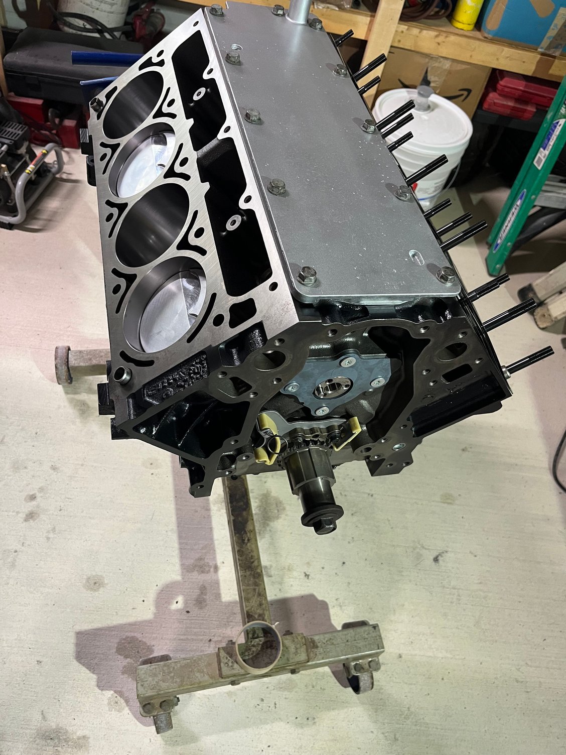

More progress today. Got the shortblock done.

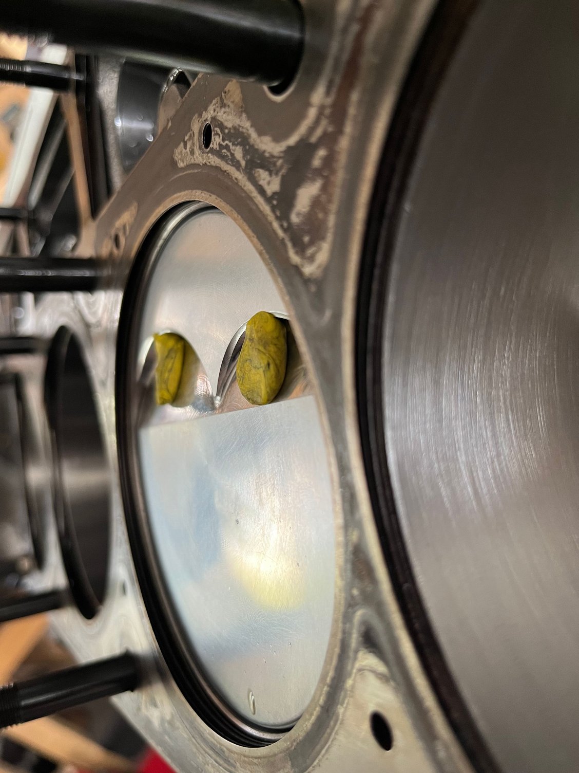

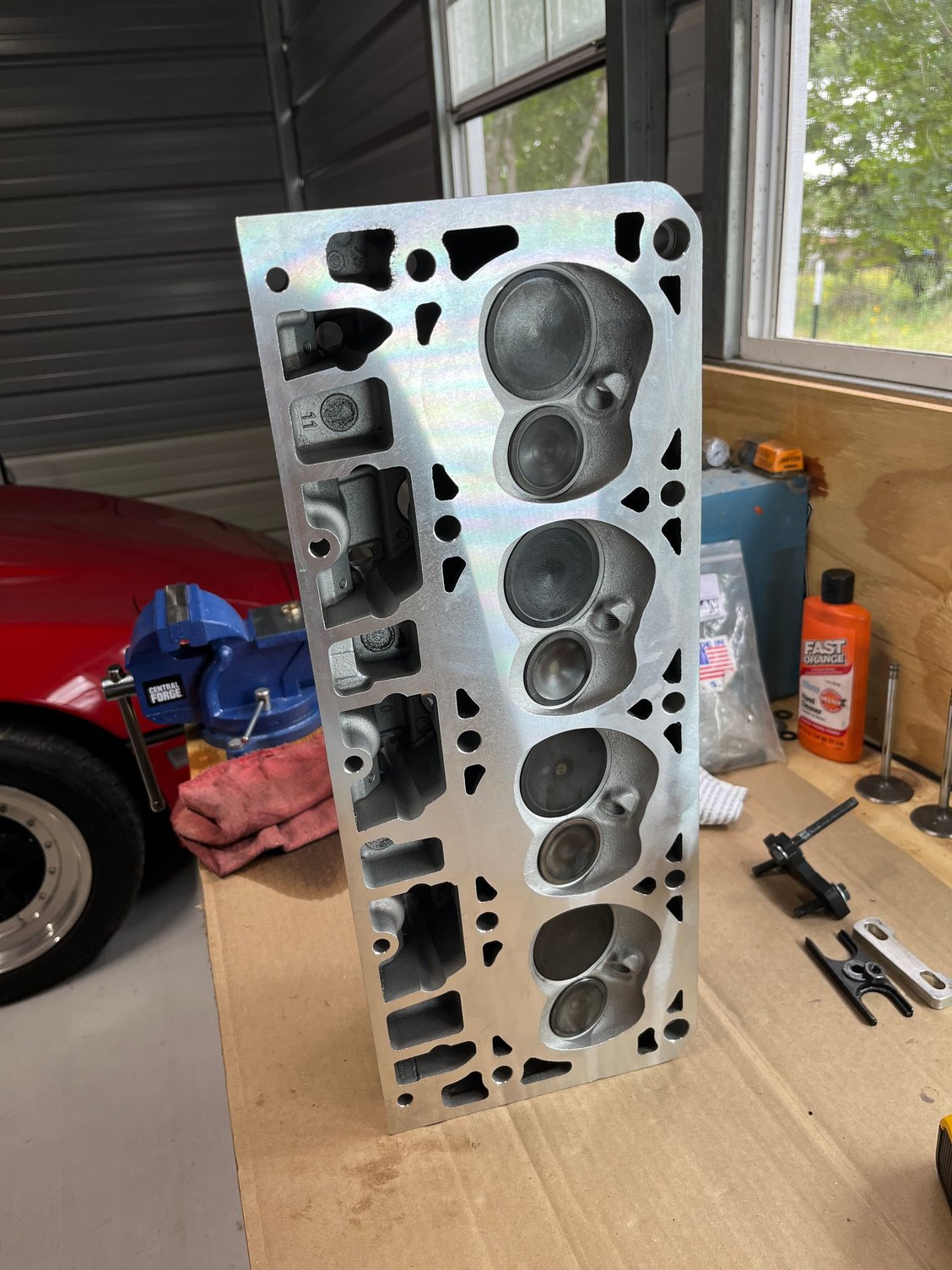

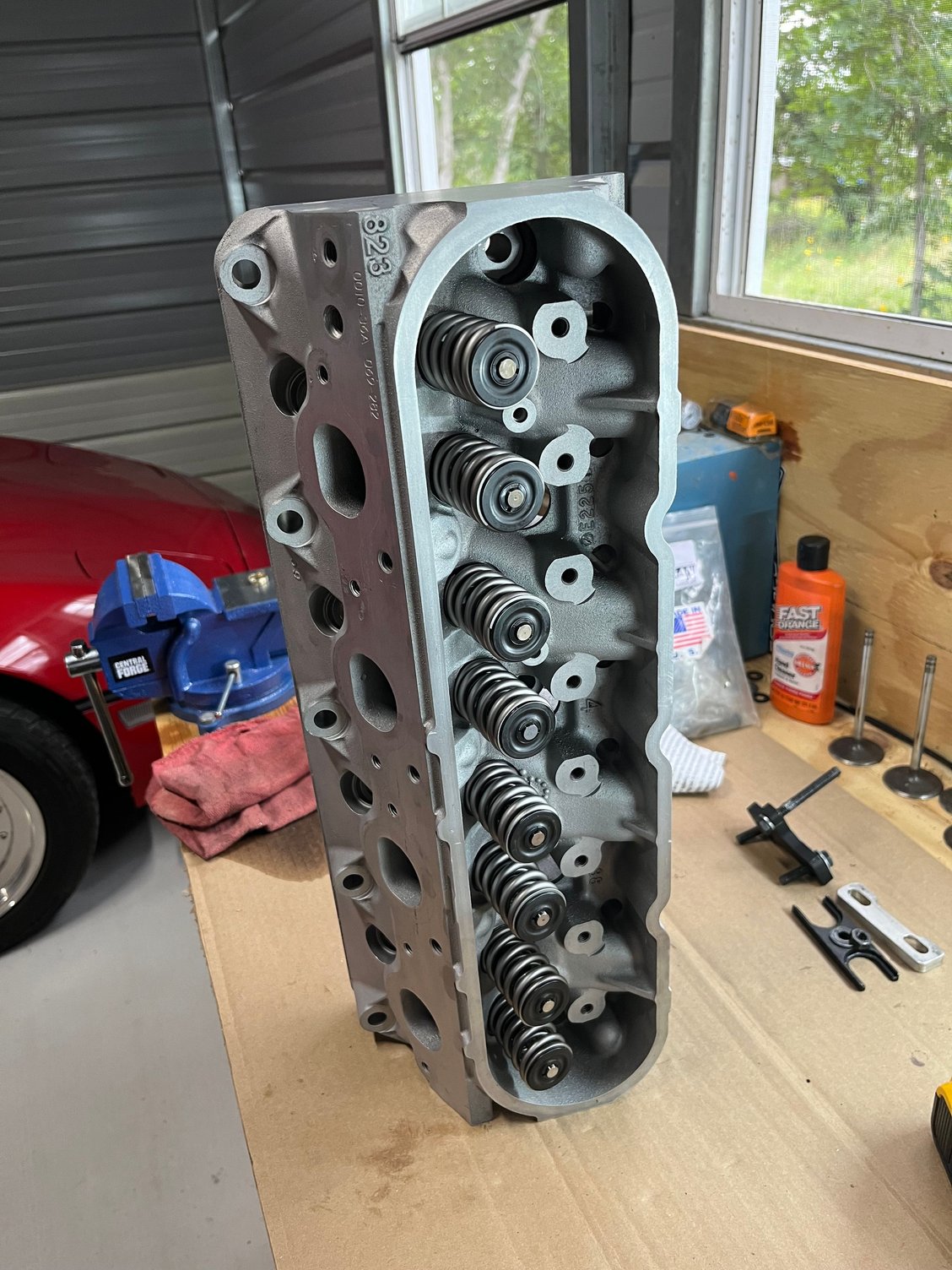

An wild electrical storm took out the power and several appliances, so I didn't get much done this weekend. I also realized that I had ordered the wrong cam gear. I got the heads assembled and ready for the PTV clearance test. That will have to wait until I get the new/correct cam gear later this week.
New springs, seals, retainers, and locks from Summit.

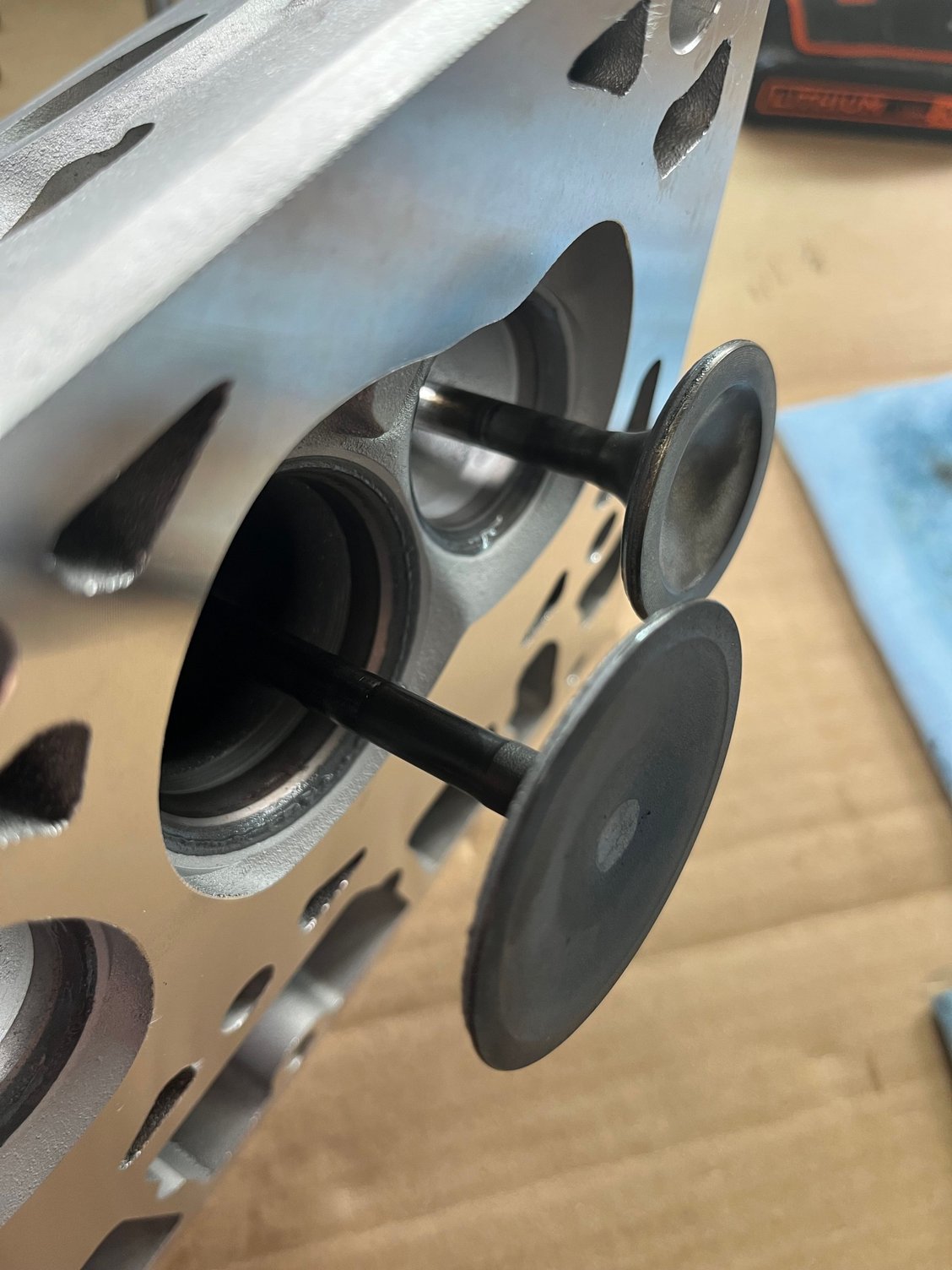

Valves lapped
heads all clean and ready for install.
Clay in place for PTV clearance test.
timing tensioner installed. Those ARP head studs sneaking in the pic.

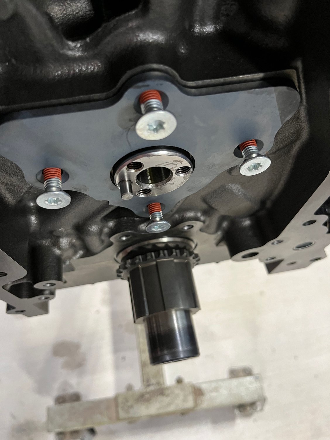

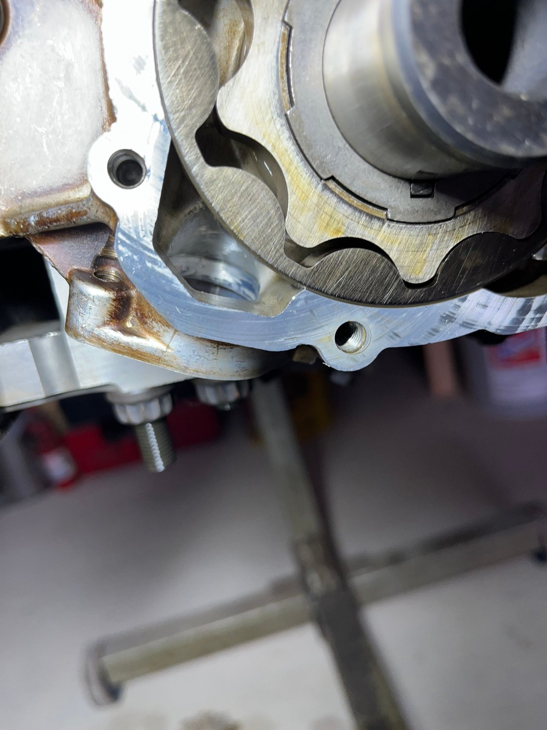

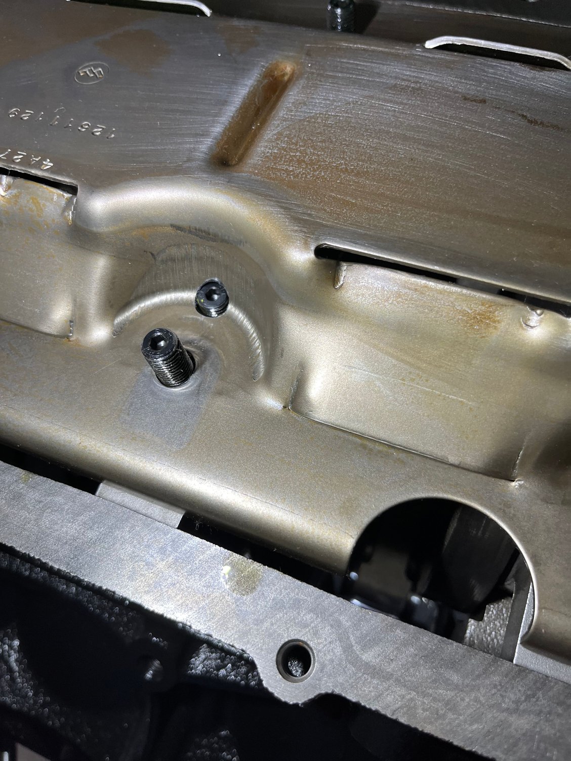

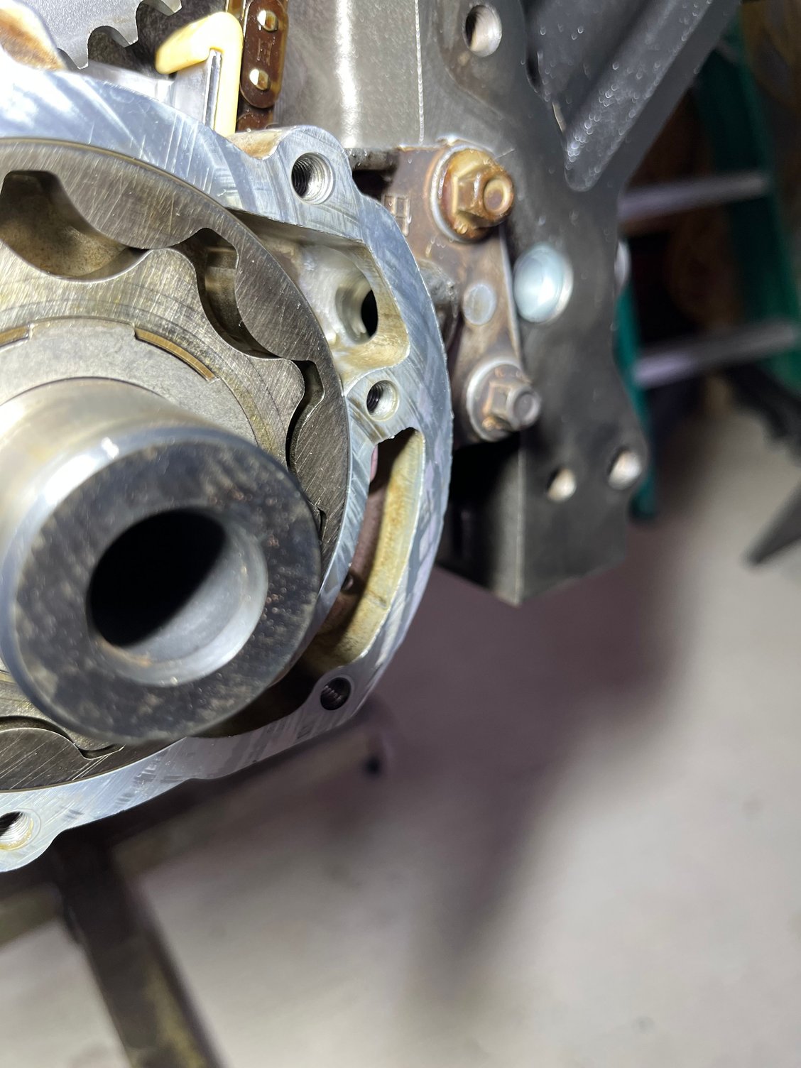

I still don't have power in my shop, but I was able to get a little work done. I also hit a big snag in the build. I'll get to that next. Here's what I got done so far: PTV Clearance test, and push rod length test (no photos), windage tray clearanced for main studs. I put the oil pump on, but that's where I ran into an issue.
PTV Clearance test results. Maybe I need more clay. lol.

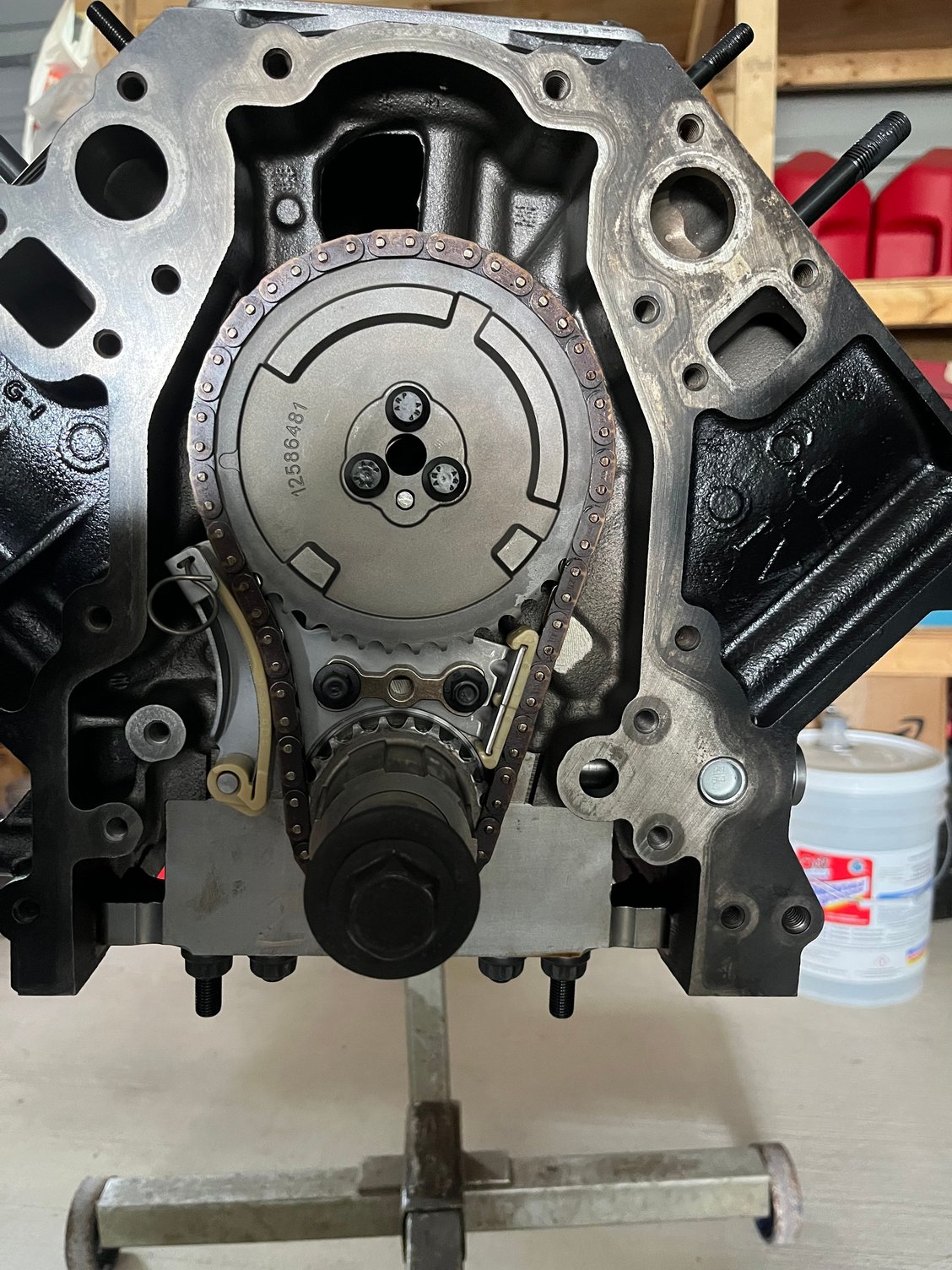

Correct cam gear installed.

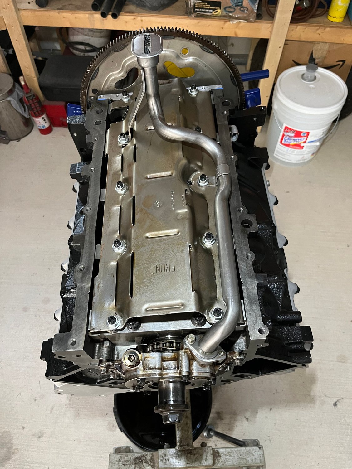

Oil Pump porting.
Oil pump porting.
Windage tray drilled/grinded for new main studs.

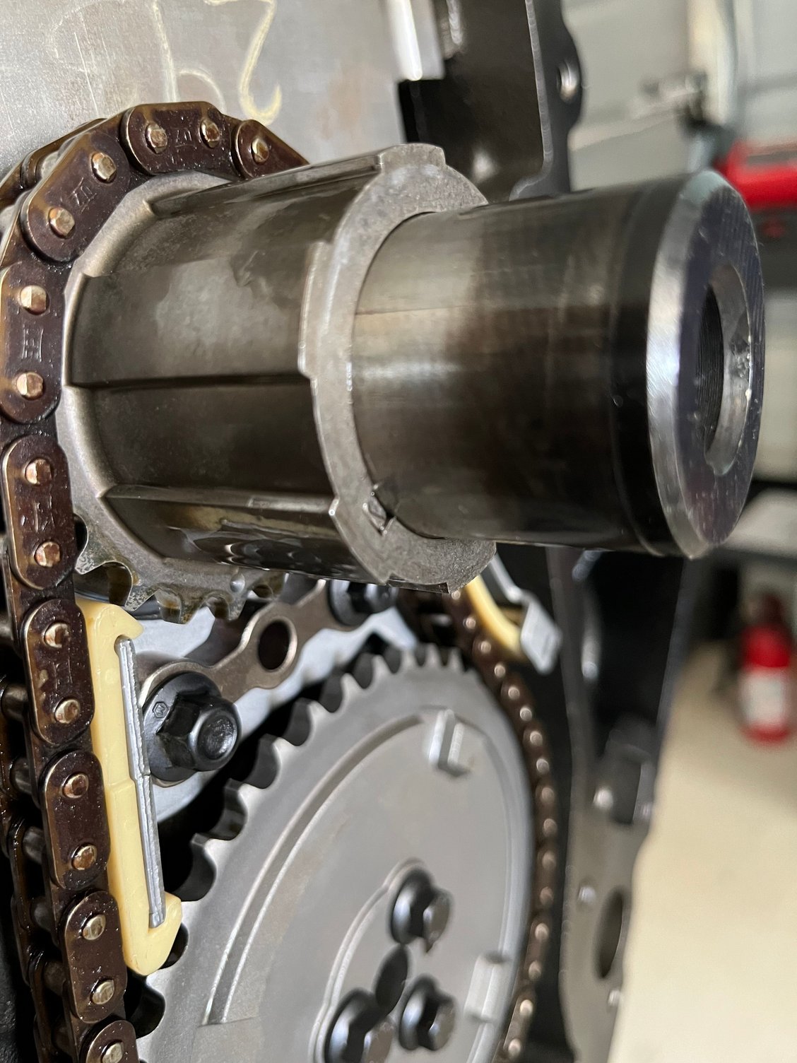

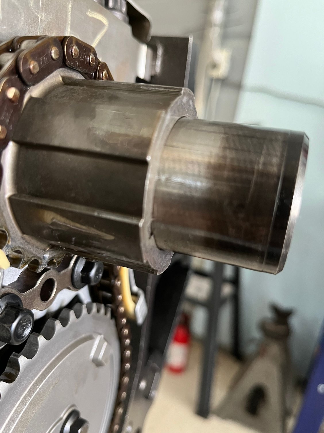

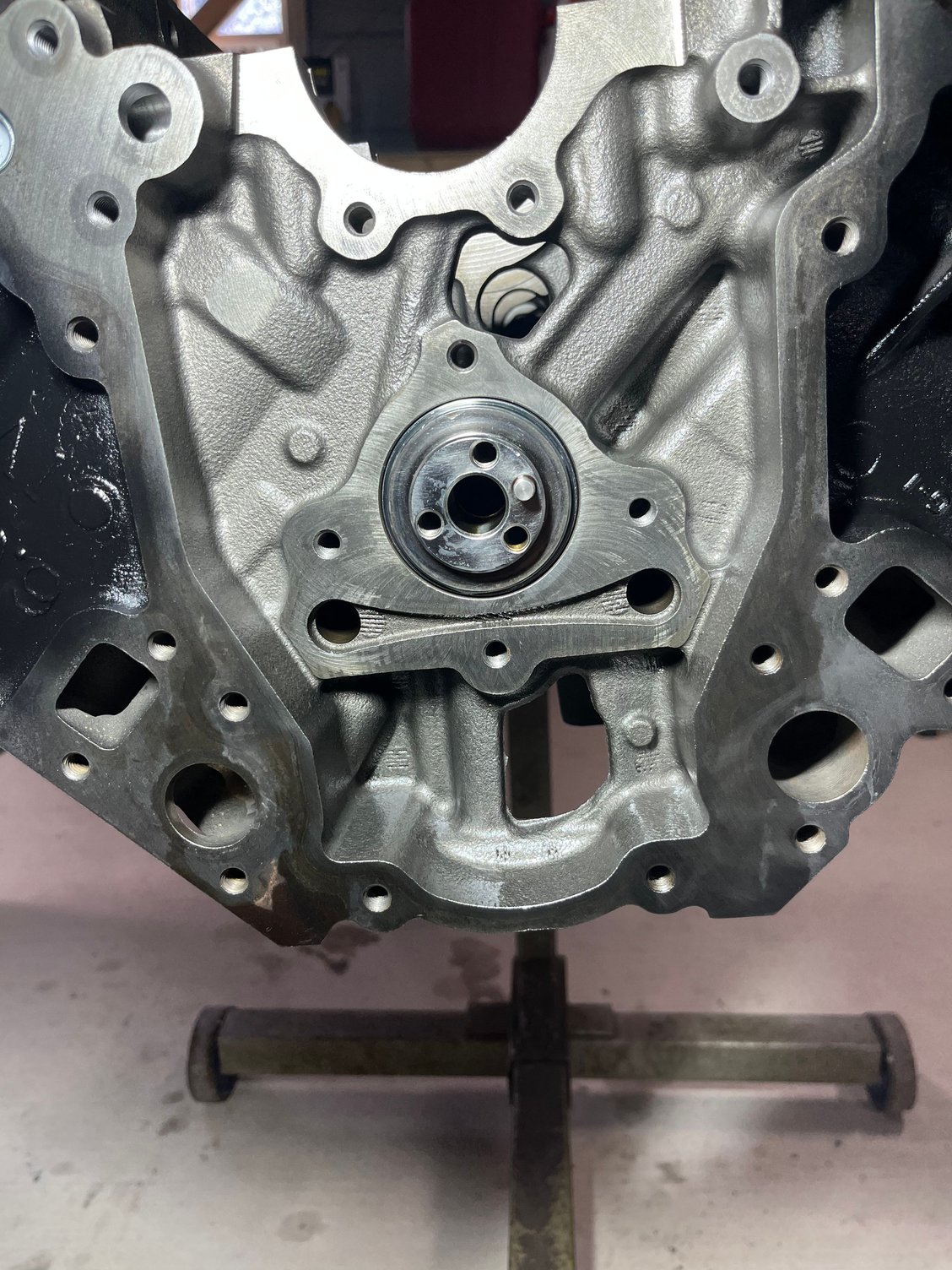

So, here's the issue. Once I put the oil pump on, I noticed that it was leaking from the center where the gears are. After removing it, I could see that the oil pump gear that is on the crankshaft, was sticking out too far. It doesn't allow the oil pump cover to go on all the way, thus, causing oil to leak from the center. I tried to "press" the oil gear on further with a harmonic balancer installer tool, but it wouldn't budge. It just needs to slide on about 1/10 of an inch more. Then, the oil pump cover would sit flush on the pump housing. I'm about ready to get a torch and try heating the oil gear. Maybe that would free it up enough to go on.
This is the same crank, oil gear, and oil pump that came off this engine. I have never had this problem before. How could it work before, but now it doesn't fit? Any ideas on how to fix this? It need to sit flush with the end of the woodruff key.

I got it. I just had to take everything apart and put it back together VERY loosely. It must have been misaligned the first time.
Oil pump primed

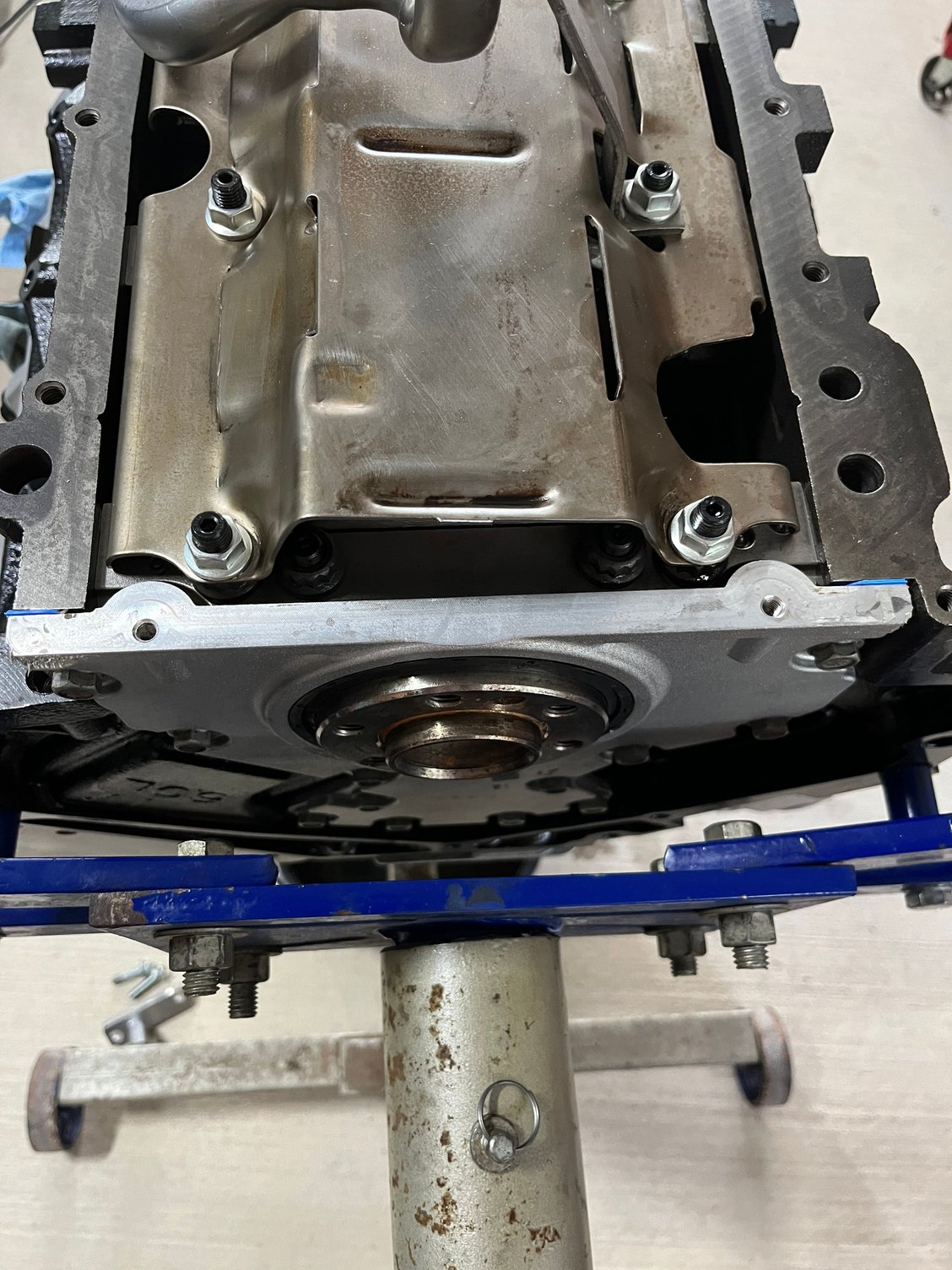

Windage tray and pickup tube installed…again

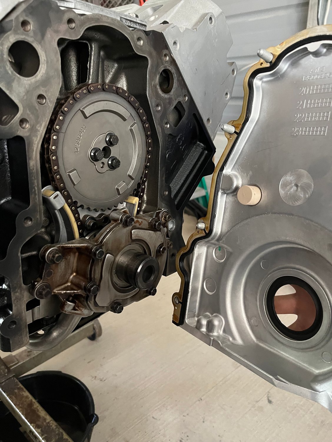

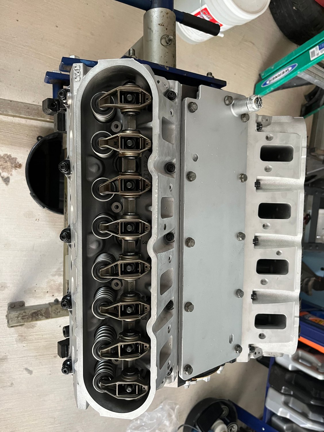

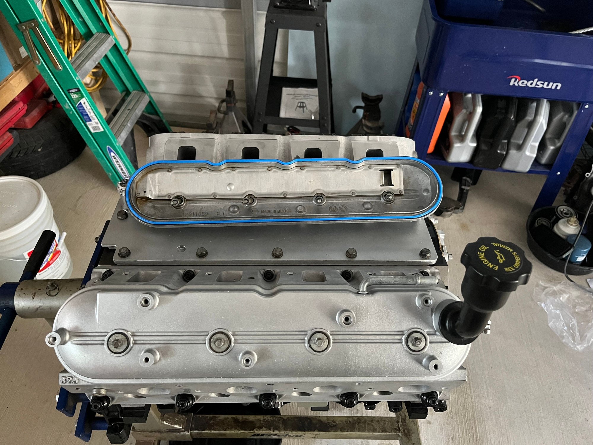

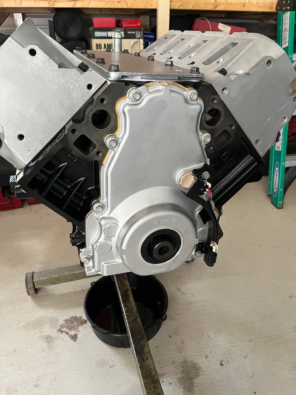

More progress! Heads on and torqued. Push rods, rocker arms, valve covers on and torqued. Front cover on loose. Intake just sitting there keeping bugs and dust out.
Brand new non-VVT cover from local Chevy dealer.
Front cover looking good. Heads on and torqued.
Rocker arms on and torqued.
Valve covers with new seals and oil filler neck.

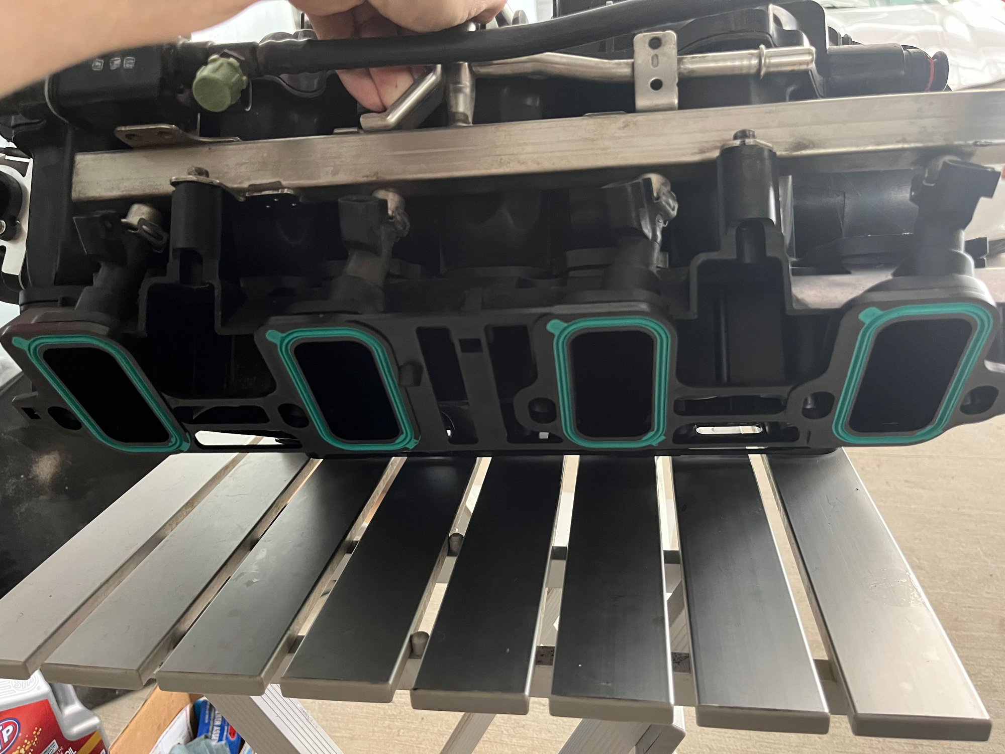

New intake seals ready to go.
It just needs a rear cover and oil pan. Almost done!

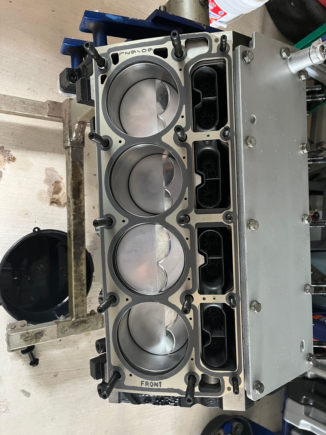

I forgot to post the head gasket pics. Of course I put the new ones on after the PTV clearance check. I don’t want anyone thinking I reused the old ones. Lol.
LS9 head gaskets on those ARP studs.

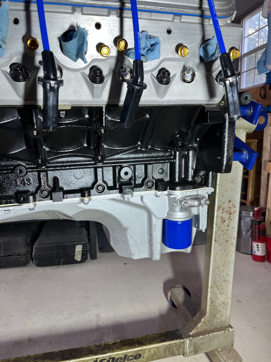

Got it ready to dyno.
Rear cover with new seals
Oil pan
Ready to run
Front cover, etc
New plugs and wires
AC Delco oil filter. New exhaust bolts.

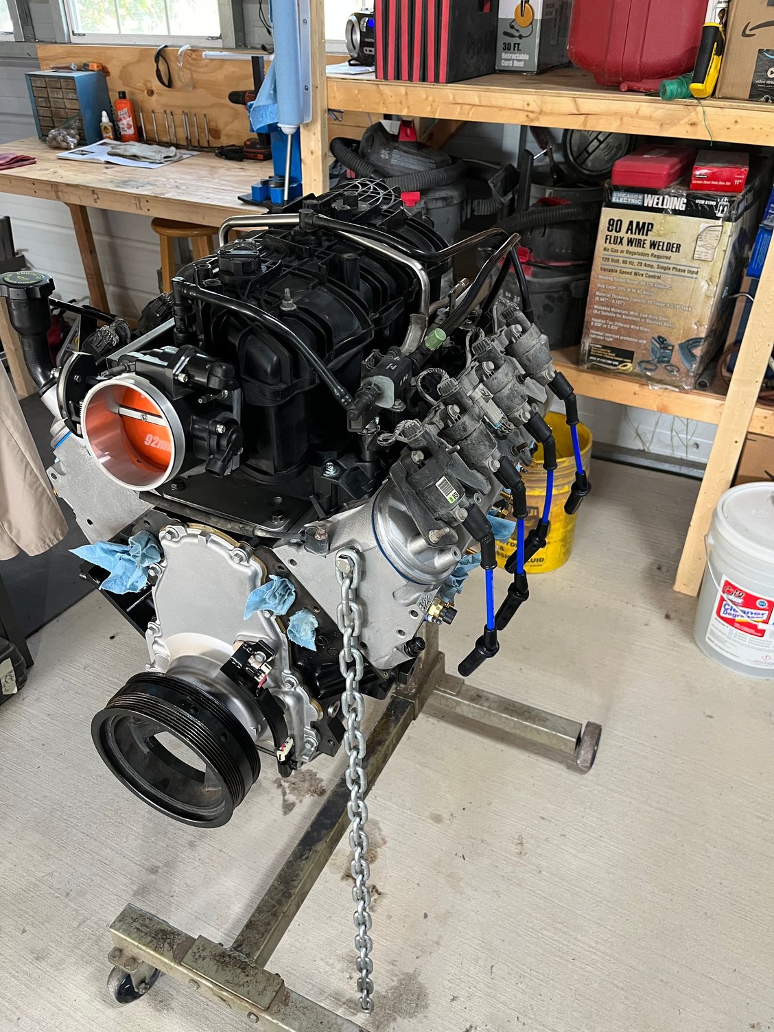

Loaded up and ready to roll! Headed to the dyno in the morning. Last chance for HP/Tq guesses.
Here's a summary of the build:
-Gen-4 6.0L bored to 4.030" (370 CID / 6.1L)
-823 heads (stock), but milled to 67cc (with dual springs)
-Summit Stage-1 turbo "Ghost" cam 222/234-115 (.600/.575)
-DSS Racing pistons, 5cc flat top w/valve reliefs
-LS9 head gasket, so about 10:1 compression
-stock intake (truck style) with 92mm throttle body

I thought it would make more, but it still did ok. I guess you can’t expect big N/A numbers from a small turbo cam. It should spool a turbo pretty quickly though.
490hp/463tq
