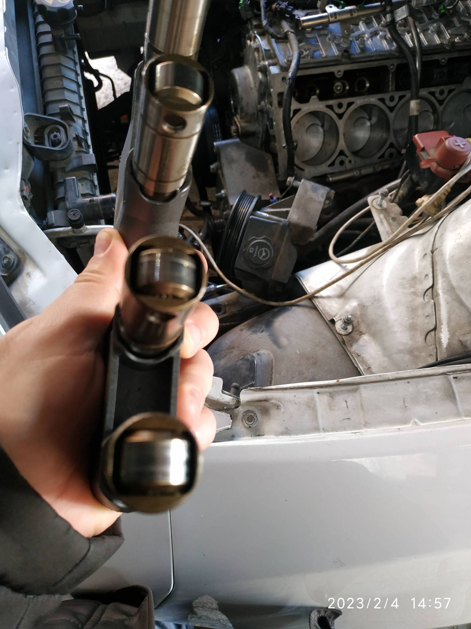

6 moth ago I pulled heads and cleaned lifters, please see attached. They all found good but after assembling engine in 2-3 weeks these "clicks" are came on.
Some of them had small scratches, but they can not be felt with a fingernail, normal wear and tear.
Lifters (Jan, 2023)
