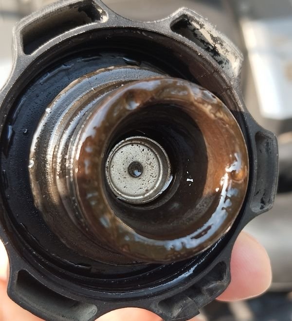

Hello. 2011 Camaro SS, L99 110K mileage. Week ago i've replaced VVT seal because it was leaking right onto the front main seal. That time after removal the coolant pump I replenished the "****" coolant fluid (vey cheap and strange color ). Today I added some discilled water and found that white signs appeared in the radiator refill hole.
With using cooling system cleaner I flushed antifreeze, then filled the water and flushed it, then added good coolant.
After driving a bit I found on the refill cap white spots again.
Could you please be so kind and advise that could be the reason ? As I understood, engine head could not be a reason due to its design.

Might be trans fluid. If it's engine oil might be the oil cooler in the radiator, if your car has one of those.
You're right, it would be very difficult, bordering on but not quite all the way to impossible, for anything internal to the engine to allow oil into the coolant. The other way, sure; but given that leeeeeks always occur FROM a place of high pressure TO a place of lower pressure, pressurized oil and coolant aren't close to each other in a way that oil would get into 16 psi coolant.

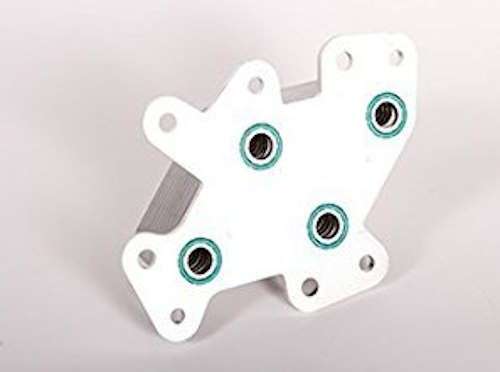

Yes I have separately oil cooler under the car.. unfortunately, an expensive part. Based on the photos, are you sure that this is oil? Could it be a reaction to antifreeze?
Can I temporarily shut off the antifreeze supply line to this radiator? Will the oil necessarily overheat in this case?

I am not sure that it is oil. It's "an oily substance", but EXACTLY what "oily" fluid it is/was, I can't be sure.
And:
Do you have an oil cooler in the radiator? What kind of car are we working on here? That's virtually THE ONLY way, in a LS series engine, that motor oil can find its way into the coolant. Only other possibility is a VERY low-probability crack in just the right place in the block (not even sure where that would be), all of which evidence ... forces one to follow paths of logic and reason, rather than blind wild speculation.
No. Not sure what that even means.
Of course not. Not any more than you can shut off the supply of fuel to the injectors, and it still run.
That would be among the least of your worries. With no cooling flow in the radiator, other things will overheat far worse and far sooner, which will park your car far before that becomes an issue.

-Can the round seals be the reason in my case ? I mean, can oil/coolant flow into each other or would I see it from the outside?
- I meant this T-hose that goes to the oil cooler (marked red and yellow). What if shut it off, drive several days and check the results ? Could the oil overheat in this case? I know that many LS engines do not have a separate oil cooler at all.

So not exactly "in" the radiator, but certainly, a point where water & oil come together.
Yes absolutely then, that can allow fluid exchange; in the direction of, FROM higher pressure (oil, 50 psi or whatever), TO coolant (16 psi or so). Coolant pressure is never higher than oil pressure except right after a hot shutdown, in this case, so you'd most likely never see coolant in the oil, at least not very much.
No the oil would not "overheat" if the cooler ceased to get coolant. Yes you are correct, the vast majority of LS engines don't have oil coolers, particularly not in the ½-ton trucks, of which there are about a billion, and they seem to get along just fine. The factory oil cooler is as much an oil WARMER as it is a cooler; oil needs to be hot, and engines suffer when it's cold, so factory oil coolers are intended in part to bring the oil up to temp quicker so that impatient people who want to romp on their cars before they're fully warmed up, will do minimal damage to them. Police cars are the object lesson in this situation.
That said, I wouldn't worry about any further troubleshooting. Seems like, since you have a water/oil setup, that it's highly likely to be the scene of the crime. Yes I'd suspect that if the seals are bad, you'd have a good chance of an external leeeek; but the cooler itself may have failed internally, like, cracked or something. O-rings, gaskets, etc. are cheeeep enough even if the cooler is kinda $$$; they'd be worth a try. When in doubt, swap em out. (say that 10 times as fast as you can ) I really don't see any practical way to "disconnect" the coolant from that; at least, not that's any less work than simply fixing it. Putting a truck oil cooler bypass block on the engine would be relatively eeeezzy though.

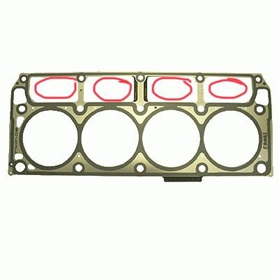

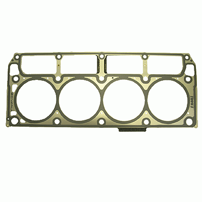

Where does the oil passes on this picture? I dropped both heads in January and replaced the gasket and bolts. I could not find the oil lines in the head. Some experts say that I have blown head gasket..

Pressurized oil does not pass through the head gasket; only drainback.
The gasket could leak coolant into the crankcase, but it's near impossible for it to go the other way.
I have put circles where oil drainback occurs. This is the only place oil passes through the gasket. Oil lines in the heads? Oil gets to the valvetrain via the pushrods.
