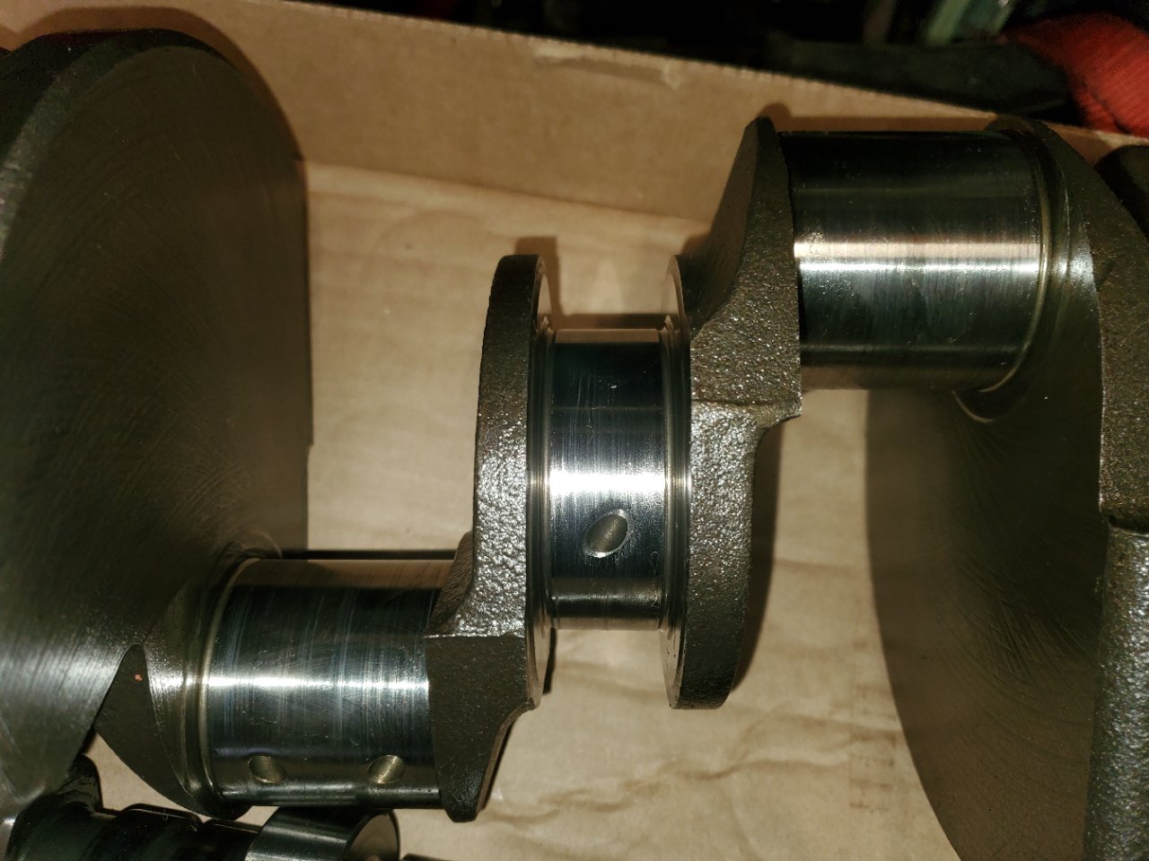

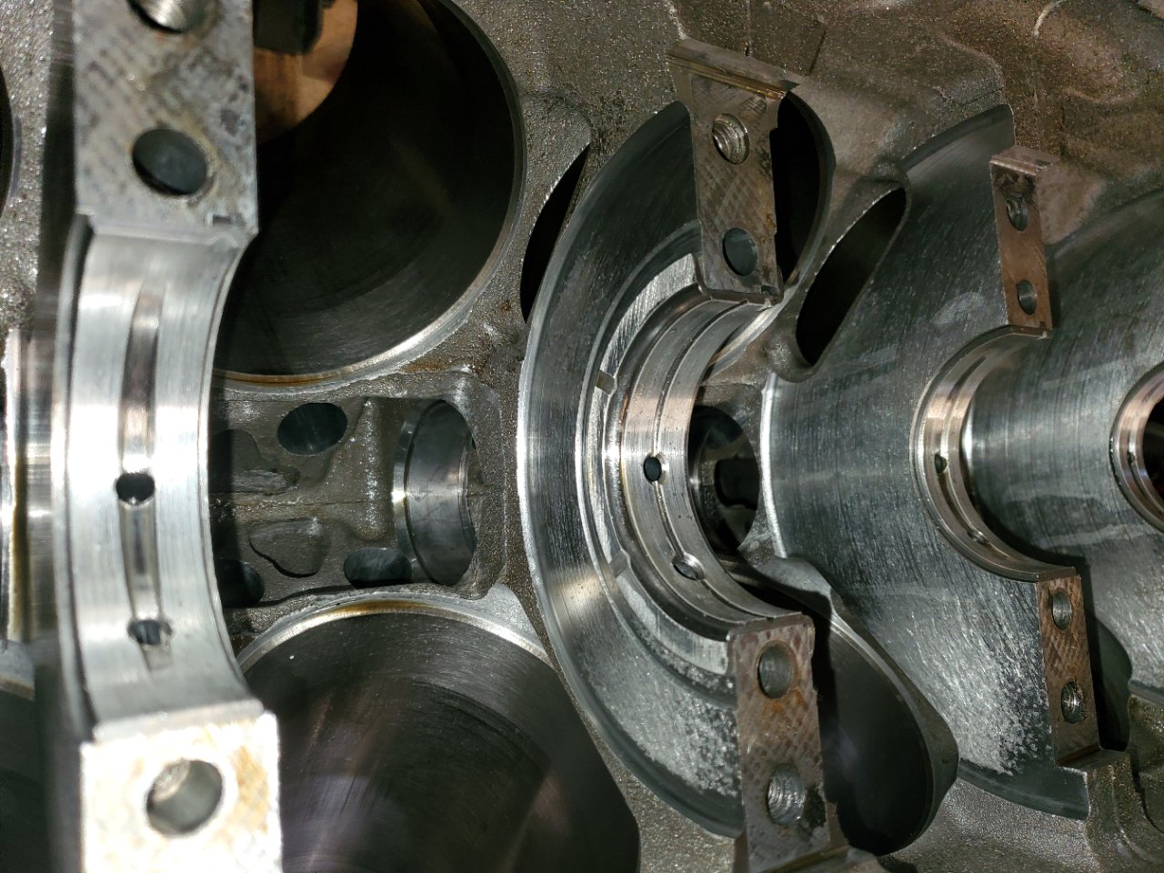

c5jako's Avatar
Joined: Nov 2020
Posts: 12
Wow-What # cam bearing is this?
It's #2 bearing. #4 also pushed out a little but not enough to obscure the oil hole. I'm surprised that there isn't more wear on the journals and bearings. This must have happened during break-in because I never noticed any metal in the pan bottom (it's a corvette pan so the bottom is removable) after the first oil change, and I was checking often when the pressure started to drop. Probably helps that I was changing the oil constantly, not proud of my carbon footprint last year. I attached a shot of the cam journal from that walked bearing and a couple shots of the crank and bearings. You can see more than normal wear on the cam lobe that was pushing that lifter.
