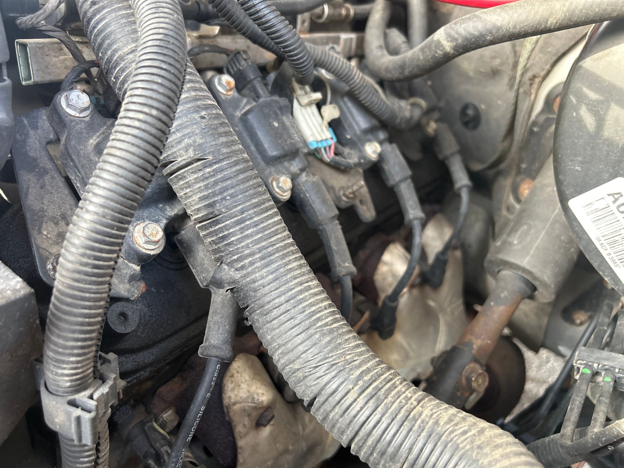

two lines coming from the front of the motor.
ill see if I can attach a picture.

The lines in the pic are the trans fluid cooler ones.
Not motor oil. Wrong side of the motor besides. Also you haven't taken off the plastic air shield thing like you've been told you need to do before car-washing the motor at the quarter car wash.
After you go to the quarter car wash with acoupla cans of "engine degreaser" (diesel fuel in a spray can) and clean your motor up to where you can actually SEE the metal, and the nice fresh new clean oil dripping in plain sight, instead of the funk of 10,000 years, look right above the oil filter for this little thing. https://www.gmpartscorp.com/p/Cadill.../12577903.html That's the part that has the 2 bolt holes that always strip when Stimpy tightens up the bolts to stop the leeeeeeks.

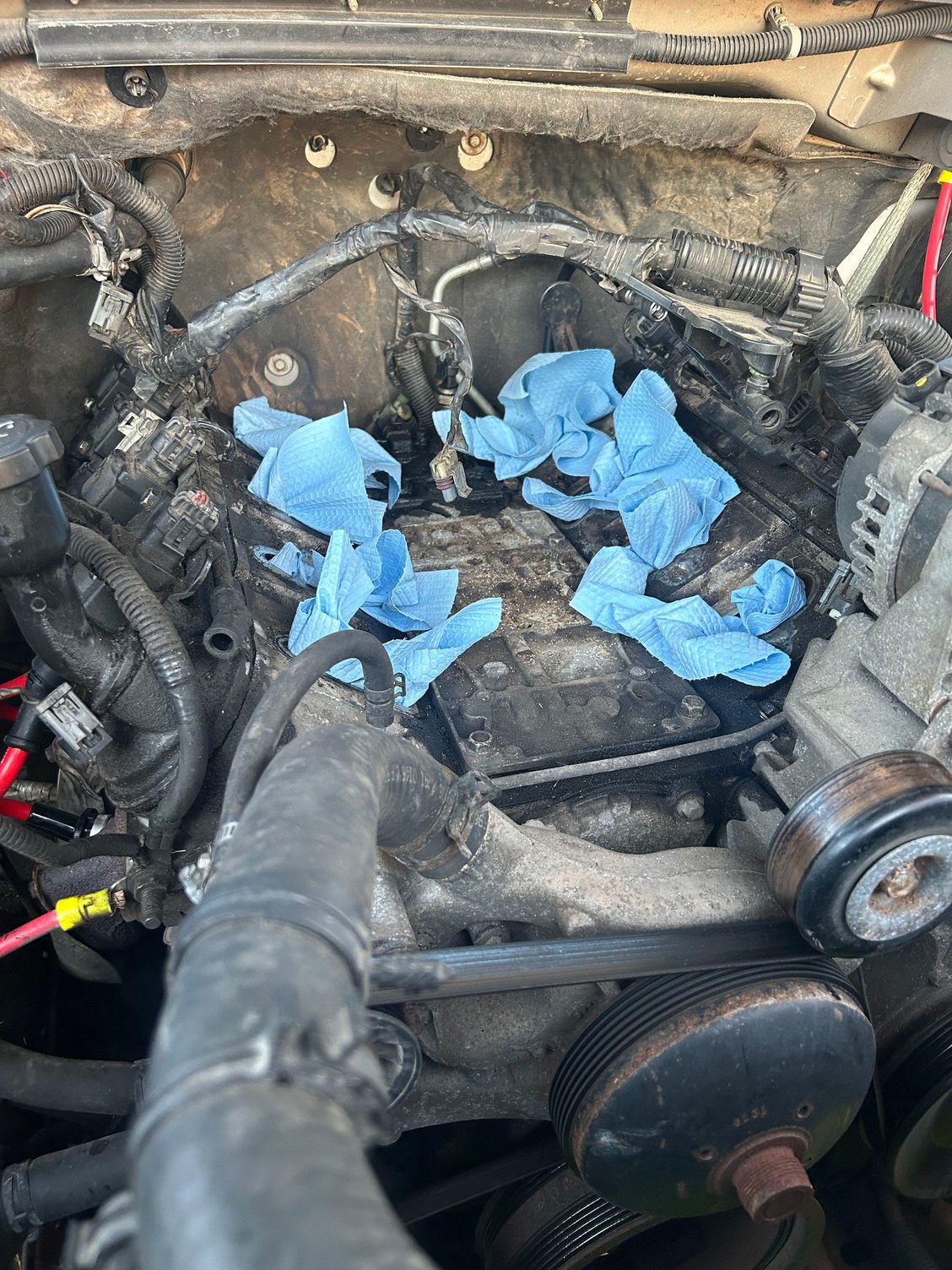

The 2nd pic looks OK; pretty normal for the most part. Looks like you haven't been to the quarter car wash yet, meaning, not taking the advice you've been given. If you're not going to follow instructions, why bother asking? All I see is just a giant blibbet of filth, dust, etc.; totally uninformative. Not sure what you wanted us to see? (beyond that you haven't done what you've been told you need to do)

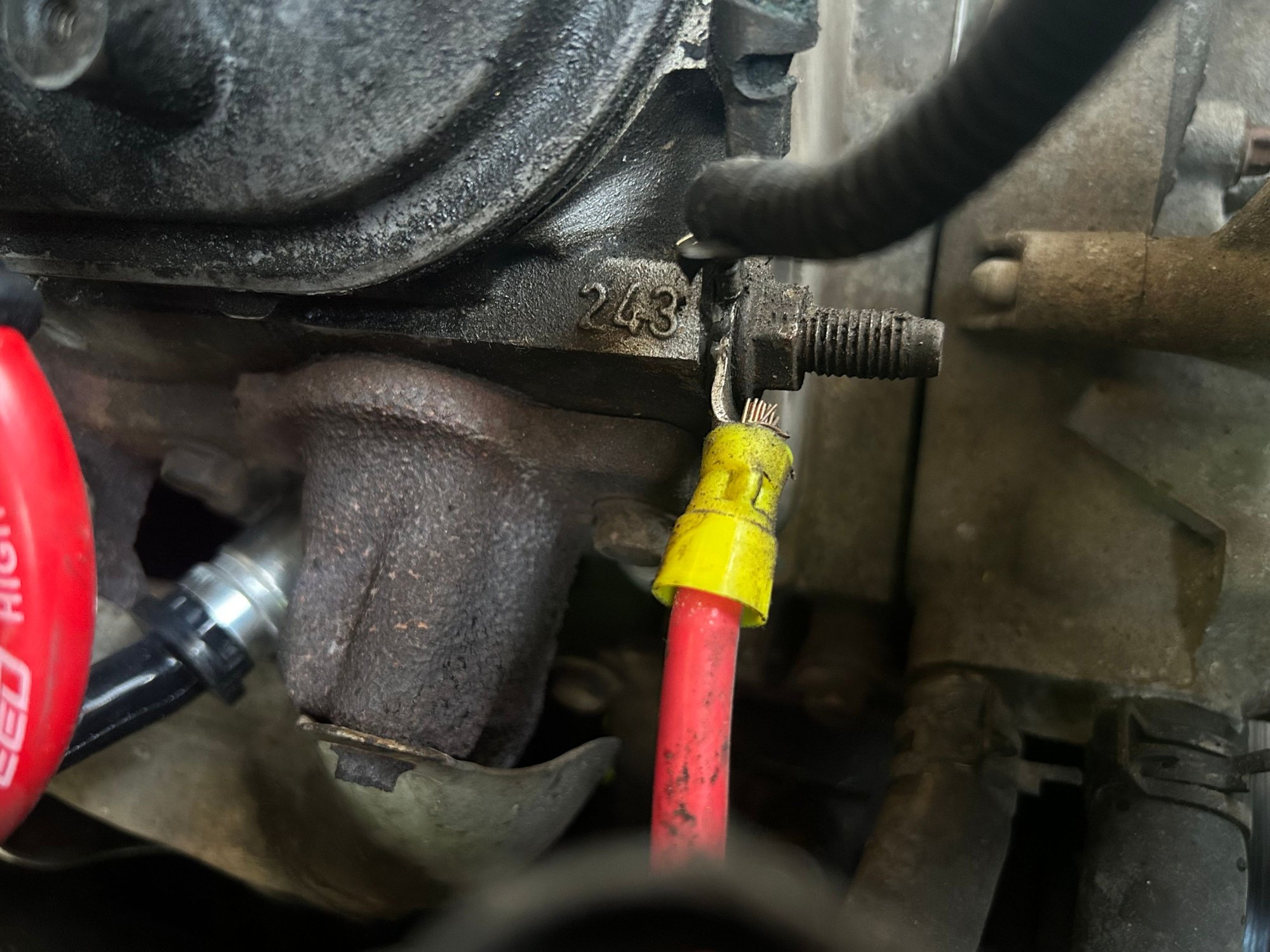

Wouldn't hurt also, to tell us which head castings you have. Look at the pass side head, front outer corner, immediately below the oil filler tube, and below the valve cover flange. There'll be a 3 digit number. Might be 243, 706, or some such. Tell us which number you have.

ok pulled the manifold today, new gaskets arriving tomorrow….
new valve cover gaskets on Friday.
still gotta address the pcv system. Will reread comments, because got a bit of oil
in the manifold.
Head stamp
