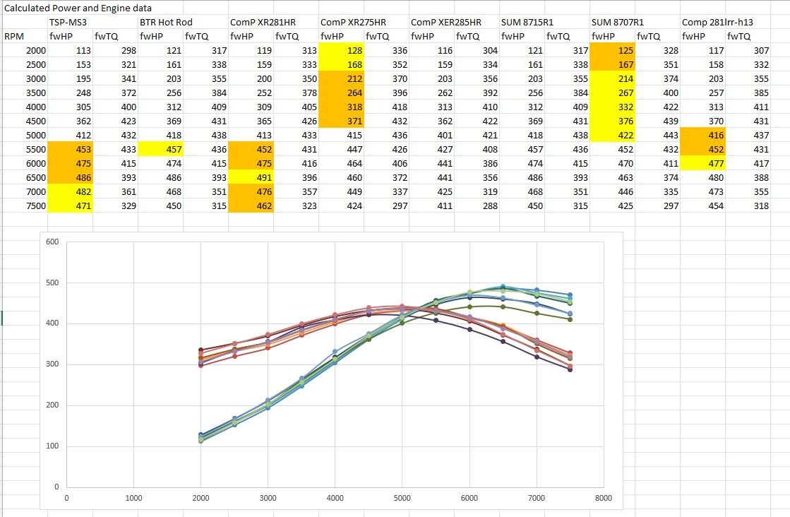

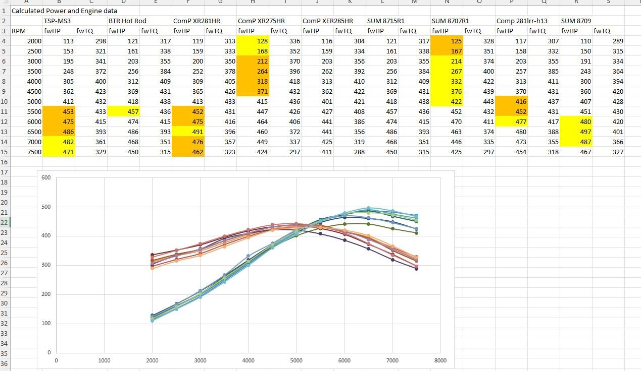

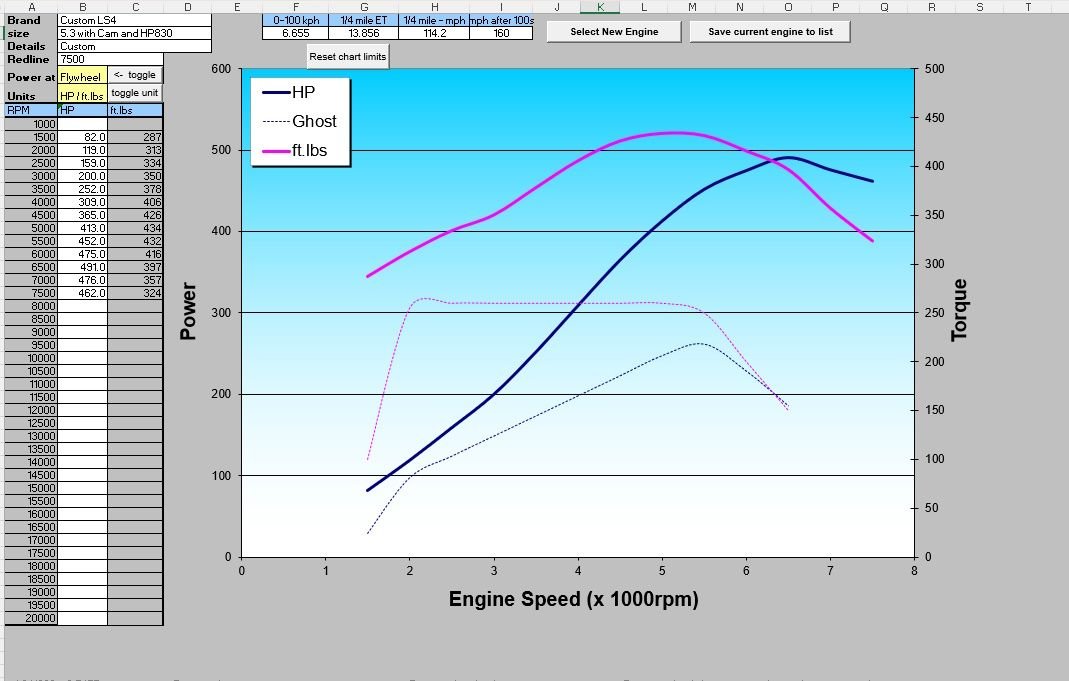

So I dumped all the cam specs into Dyno 2000 just to compare. (some of the comparisons match Richard Holdners vids)
This is using 243 head flow data off of a few builds on here.
based on this, I think the two choices are TSP MS3 and the comp XR281HR
The Summit 8707R1 falls off too quickly, the famed 54-459-11 cam that some have offered does have a peak in the 5-6k range.

Gut check says something is wrong with the 8707 data. Peaks @ only 6k in a 5.3? And then drops off faster than the 8715? Neither makes sense.
could be, however I cant find any actual dyno data on these cams anywhere like I can with the MS3, the BTR hotrod, etc. so I can only go off the simulation software. Keep in mind, the flow data is for stock 243 heads with bowl blending and a mild gasket matching.
Usually the sims will differ in terms of overall values from actual, but at least trend similar to real. For example, if you look at the Comp 275 to the 8715, I'd expect the results to compare the way they do. But the 8707 results don't fit at all. I think either an input was changed, or the cam data is not inputted correctly. I know some programs you can input both advertised and .050" cam specs and then select which one you want to use as the main basis; which can yield different results. Or maybe you were trying a different throttle body size or headers ,or compression, etc. and forgot to match the other cams when you selected the data for graphing, Or maybe something was fat-fingered.
Try making a copy of the 8715 file, input the 8707 data again independently (instead copying from the cam file you created) and see if the results change.

Not sure. even the 8709 tends to fall off quickly in the sim software.
yet, I am lightyears ahead of the LNF in the Solstice which weighs in at 3100.
Not sure I need to keep spelunking down the rabbit hole as sim software is just a guide. will review a few more of the holdener vids and compare those numbers next...... then attempt to iron out the whole balancer issue
