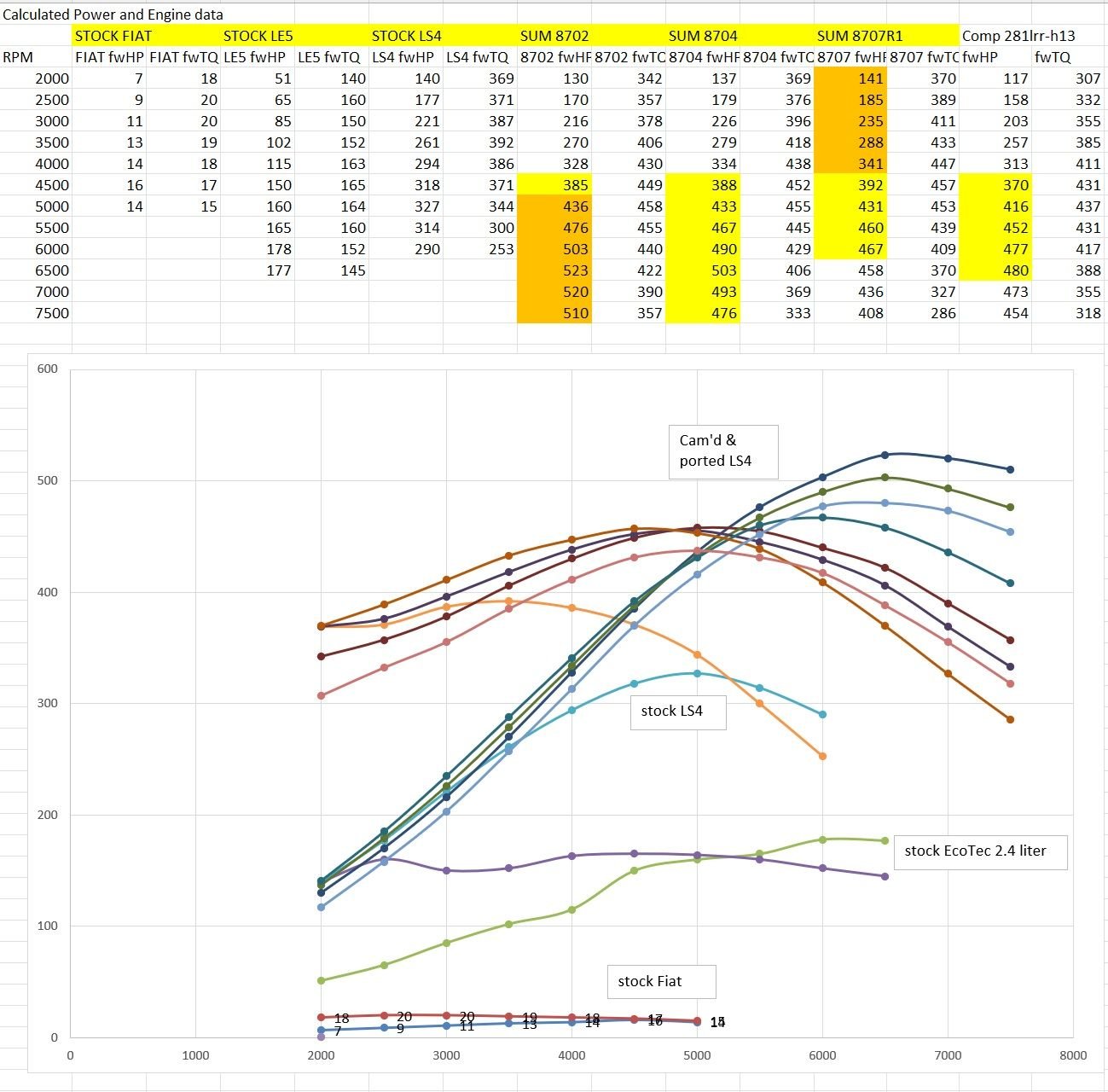

Using sim software, there is only a few HP swing in both directions that correlates with your comment. Still havent finished up the holdener video rabbit hole data mining, however still thinking the TSP MS3 or the XR-281-HR. plenty available new and used from people chasing that last 10hp.
agree with the feather weight, not sure one cam will matter over the other that much as I will have under 5#/HP weight/power ratio with most of the cams looked at in this thread and I get into plenty of trouble with 10#/HP of the daily whip

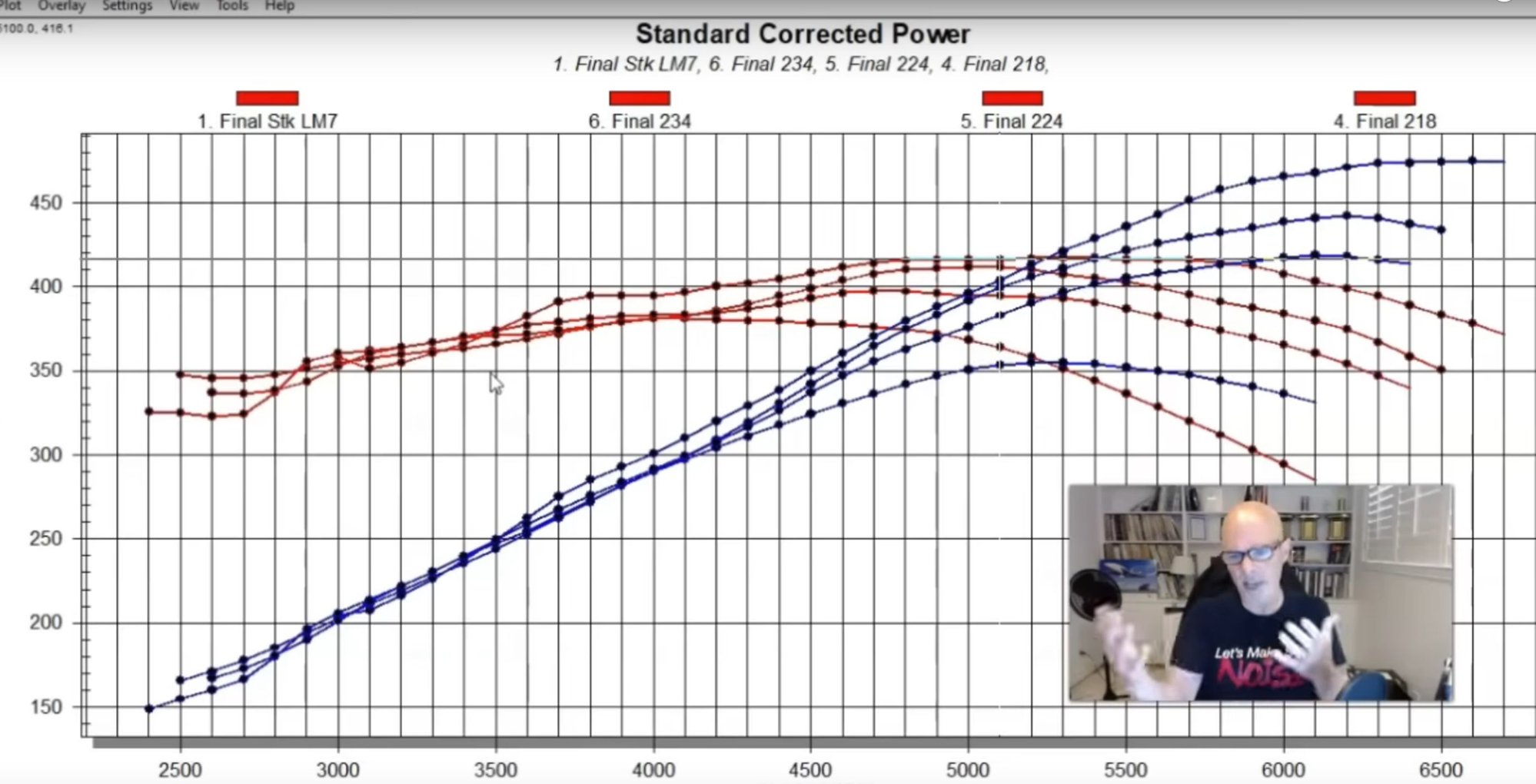

so went down a holdener rabbit hole.
this cam.
made this hp
and the graph stops at 6700 RPM where the others fall off.

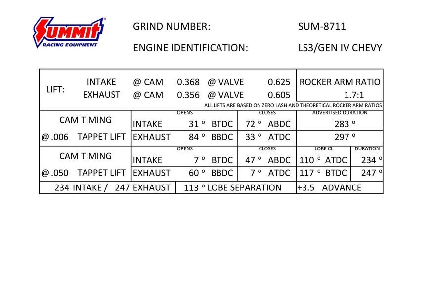

so basically, based on speculation, the summit 8711 should have a bit more than the Comp 281LRR-H13 (54-469-11) which should be a tad more than the 277LRR-H13 (54-454-11) . The dyno video rabbit hole shows slight advantage to the comp 277LRR over the "stage 4" cam of 8711.

going with the 8702 cam. chatted with a member that had the 8702 and 243 heads on flat tops with a carb and loved it.
so to close this out, I put labels on the curves.
with the 2000# vehicle weight, actually any of the cams would work, however I like tight LSA's and do not need any power down low as stock, the car had only 16hp
