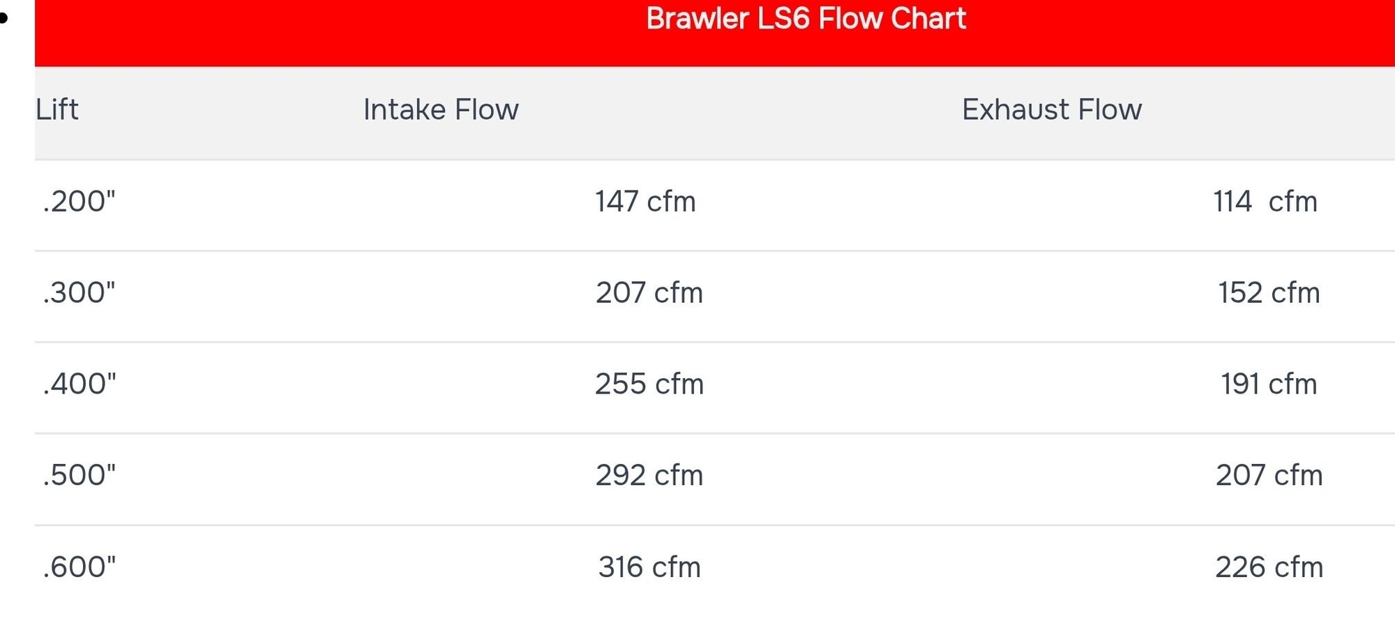

Guys the flow numbers from GPI aren’t promising….Tonys 243 heads flow more than the BTR rectangle ports do. This endeavor isn’t a whole lot different from a GM LT head. Me and Tony have been been discussing this….I’m not sure this is going to be everything we hoped for. Time will tell. Hopefully I’m terribly wrong here.
can you share the mamo 243 flow numbers? I dont think ive ever seen a 243 head flow much over 320cfms if at all. The cathedral canted valve heads flow over 350 at .650. I dont think a 243 head is capable of that.
Here are PRC ported 243s for reference. not doubting tonys skills, i just dont think 243s can be modified to get near 350cfm on the intake.

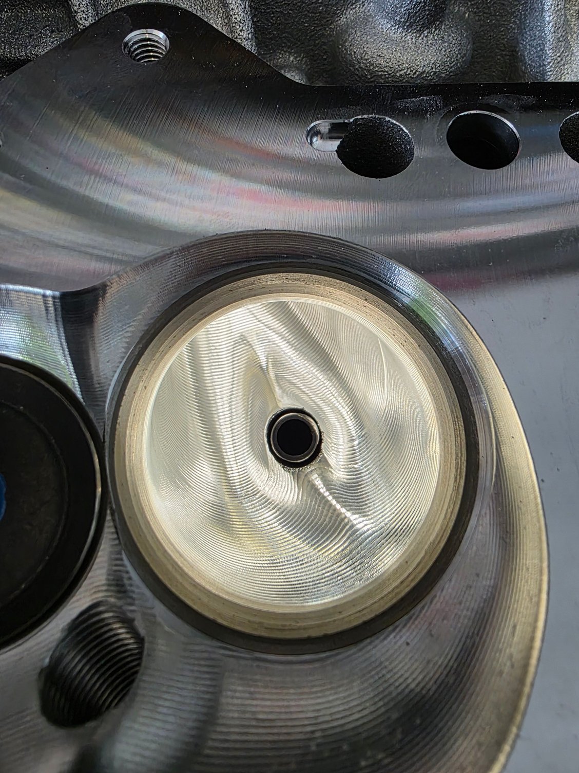

Canted valve combustion chamber
Canted valve exhaust port

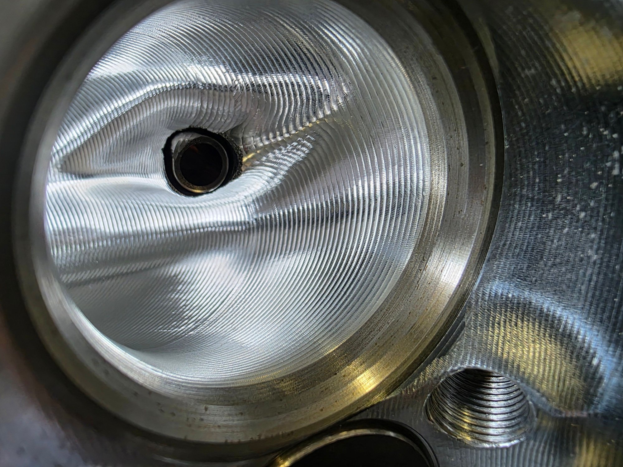

I bought the btr heads after seeing the horrible port alignment the tfs 235 had on my single plane.
so far these look very promising and come standard with iron guides.
they call them powdered metal, which is also what is in GM OE heads. I think that's different than iron

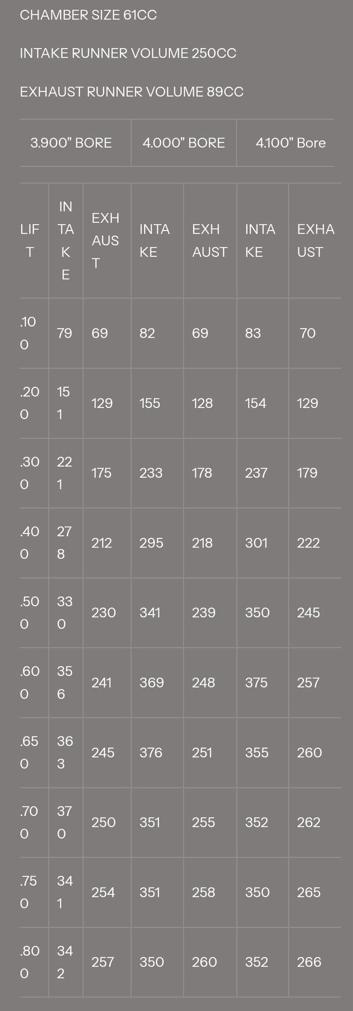

Here are some interesting tidbits I found while searching past posts on Facebook earlier
Cathedral port flow numbers based on the version ported by Late Model Engines

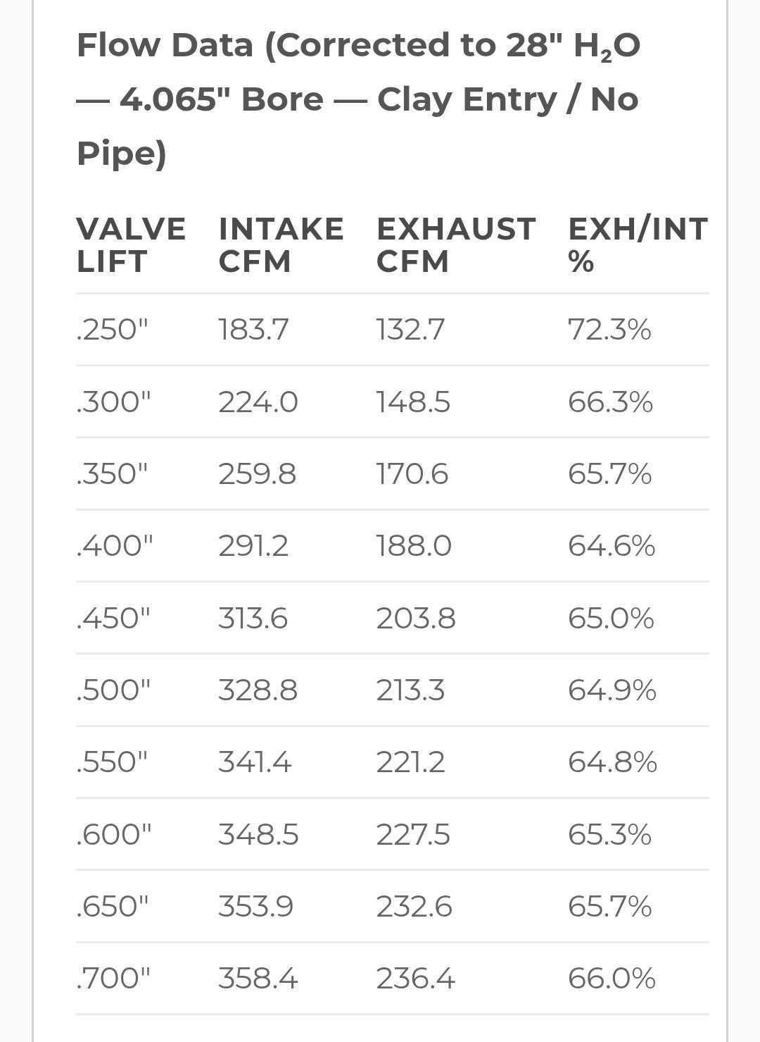

I've been seeing around 360 cfm at .650 lift.
More and more I dont think flow bench numbers at the end of the day mean as much as what alot of people think.
Steve Morris has said the same recently and Tooley also.

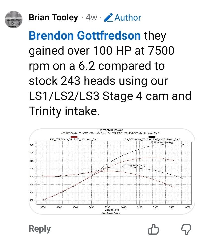

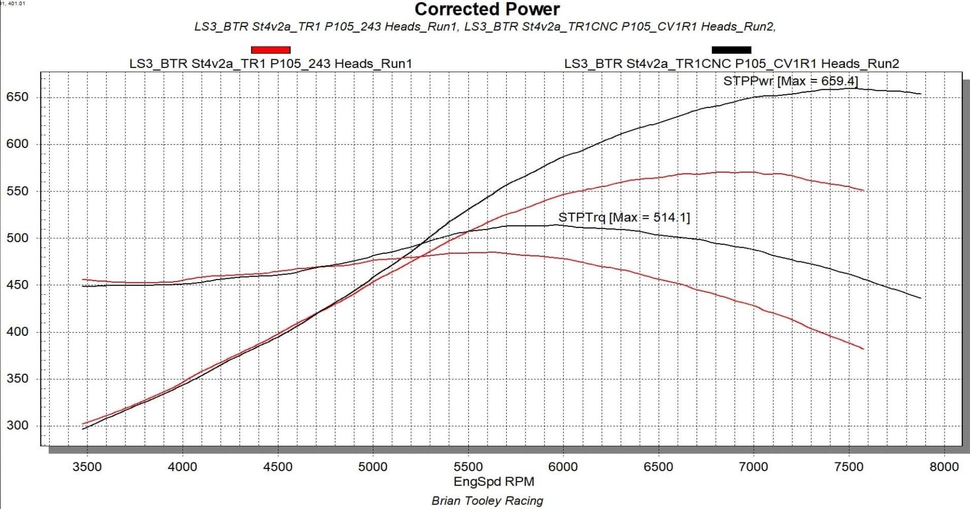

Once they have the CNC program figured out (all the final tweak have been done - sounds like they have), it would be interesting to see a true just change the heads (an only the heads) dyno test.

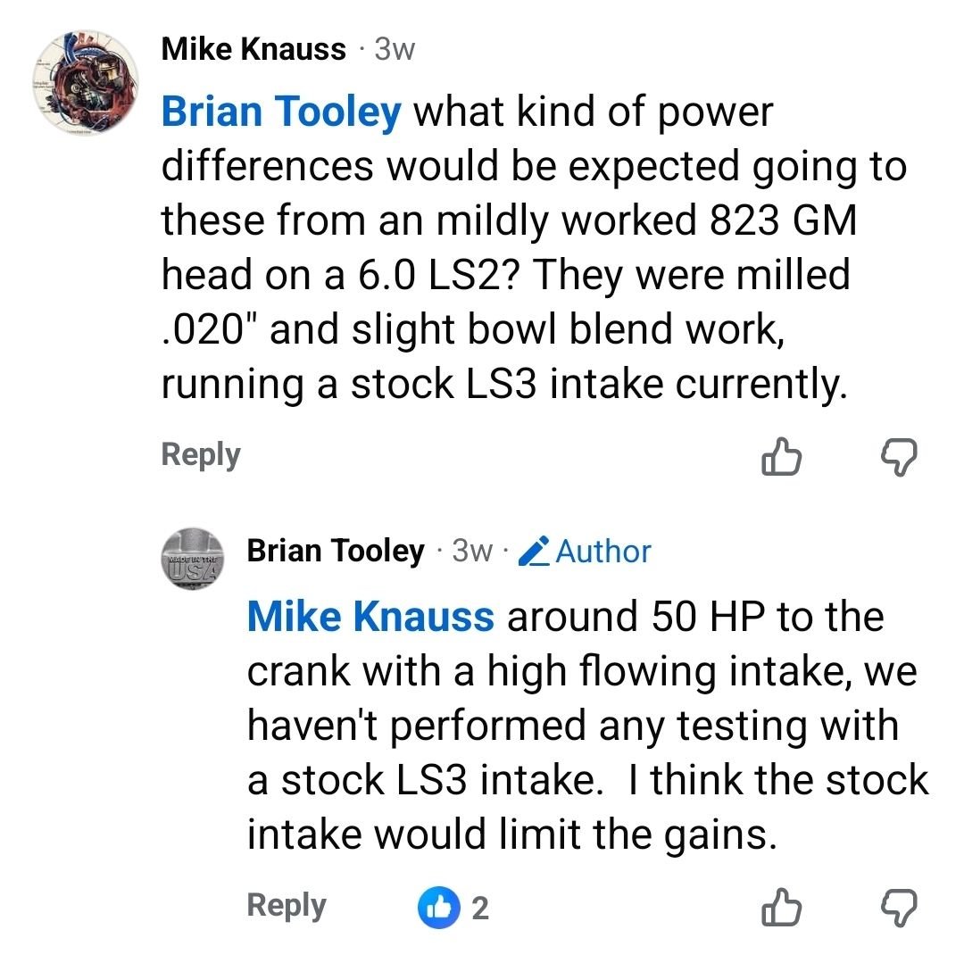

Brian posted on facebook to check out Gwatney Performance. They've got a program for these heads.
This is from GPI
This is from GPI
