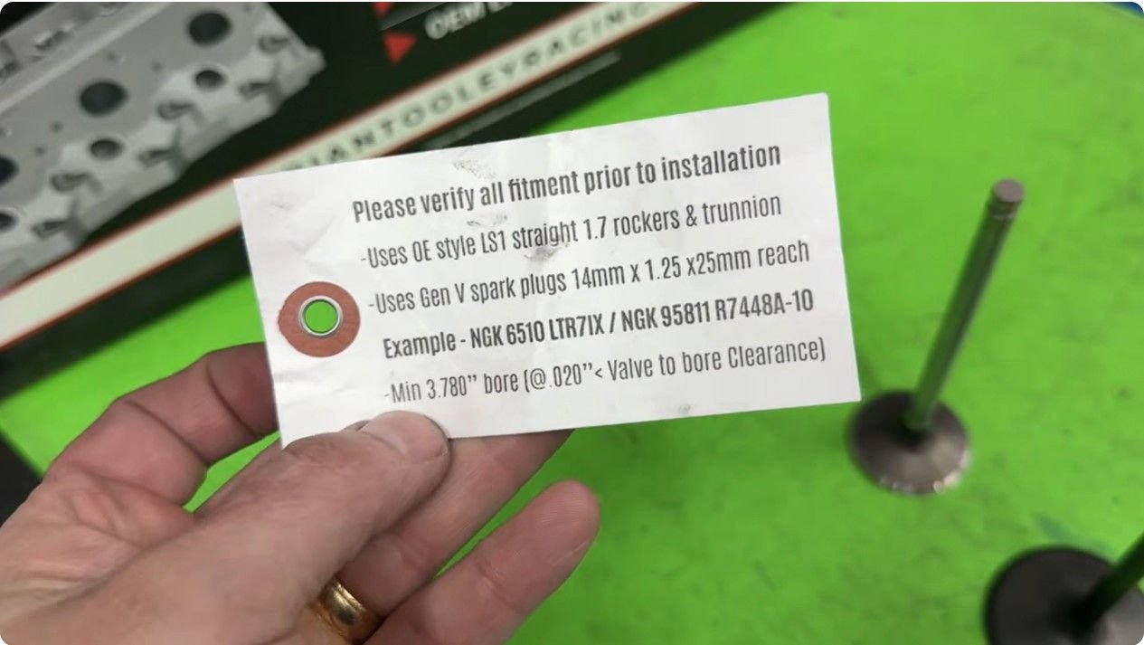

Interesting, Eric said the heads came with a tag that said they'd fit a 3.780" bore, but all of BTR's info on the rec port heads say they need a minimum of a 3.820" bore.

What rockers work on these heads?
Old May 27, 2026 | 09:44 AM
  #107
02EBC5Z06's Avatar
Joined: Sep 2017
Posts: 764
Likes: 437
From: Massillon, OH
Stock ls1
I noticed that too. I have no answer and I am Far to lazy to call and see if any one can answer why.

I think the heads were designed from the outset to have the potential for larger valves on the rec port versions, which is why BTR's info on them says the cathedrals are a 3.780" minimum bore @.020" valve clearance and the rec ports are a 3.820" minimum bore. Until I see solid proof to the contrary, my assumption is the valve spacing is actually wider on the rec ports. BTR knows the majority of people going all in on a set of heads are going to use rec ports, so those ones were made to be upgraded.
