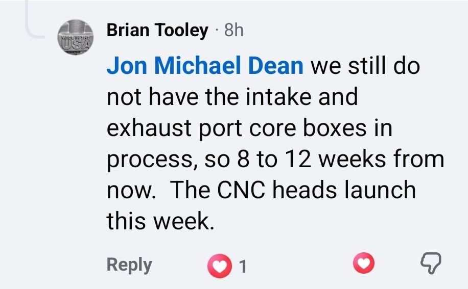

I asked about As cast heads and he said this. Do you think he means they don't have the moldings yet for the as cast?
Good news about the cnc heads, but that might annoy the companies like GPI who wanted this business from them for all customers. Most people will probably just buy the heads straight from btr and cut out the cnc companies.
Very curious as to the price. Bare heads are 899 a piece. Fully loaded and cnc probably 3k?
