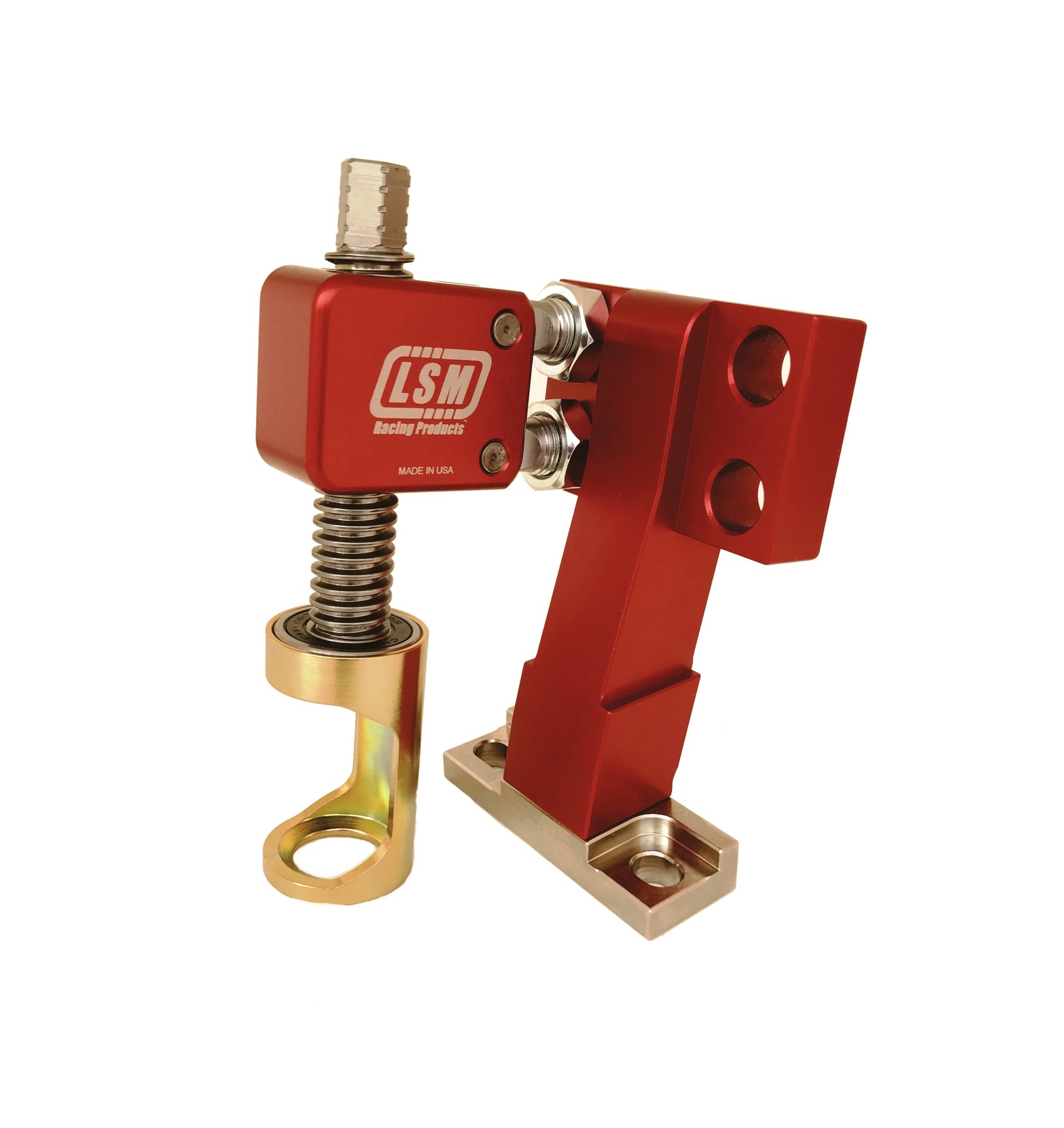

Okay I spoke with Tim at LSM and he suggested that I try and utilize the extender that came with the tool which will raise it up some and to make a spacer to sit on the rocker arm pedestals and see if that will work. We also talked about this tool but he wasn't real sure if it would work under the cowl of a 4th Gen Fbody.

I like the idea of that second tool, but I'm not seeing how it would bolt on to the head, wouldn't you need a head without rocker pedestals cast into it?
It's supposed to work with LS7 heads also.

Just an FYI the LSM Racing SC-125 wil work with the exception of the back two cylinders on 4th Gen F-bodies due to the windshield cowl. LSM SC-167 does not fit onto the Brodix BR7 heads due to interference with the tool and the centerbolt valve cover bosses. You could grind on the bosses or grind on the tool in order for it sit flush on the boss but I spoke with Logan at LSM and he suggested using some washers or a spacer between the tool to raise it up just enough so it would not interfere with the boss and then use their extender which I do have. I decided to try the CompCams or the Powerhouse POW352001 valve spring compressor tool and it actually does work on the BR7 heads.

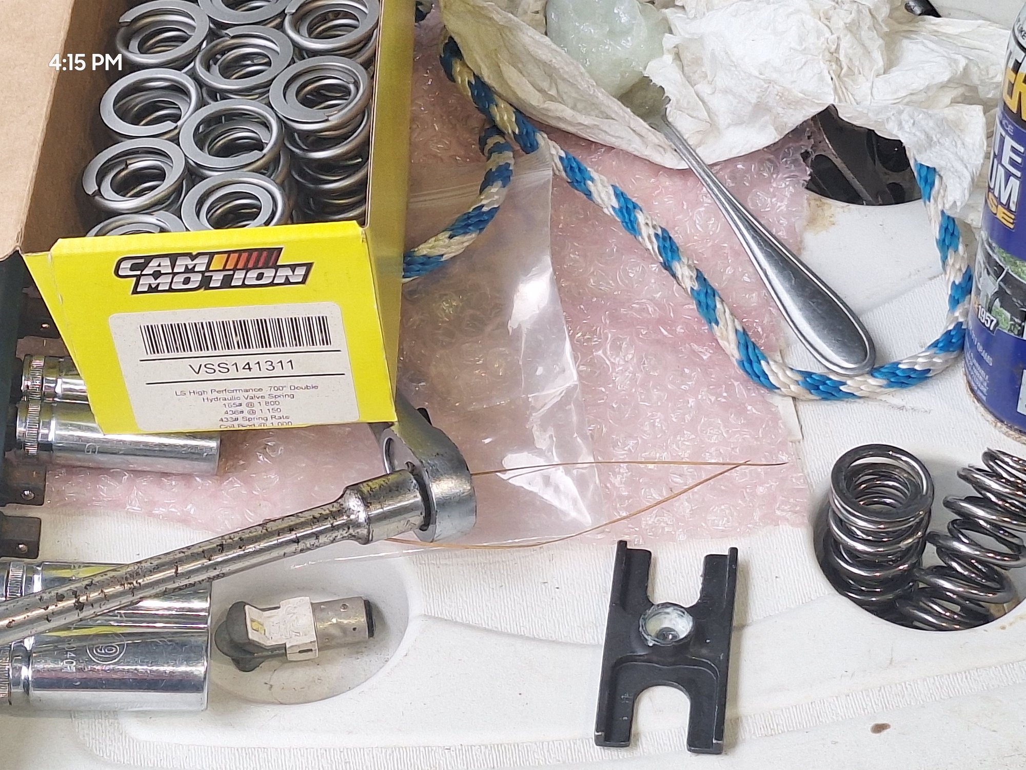

Got one side finished today.
Got one side finished today and surprisingly No. 7 went without complication. Did end up going to a longer length rope BTW.

Are you using air to hold up valves or rotating the engine till the cylinder your working on is at tdc?
Old Oct 20, 2025 | 10:17 AM
  #74
cammednnbs's Avatar
Joined: Jul 2019
Posts: 201
Likes: 20
Nevermind i enlarged the pic and i see your using the rope method. You really should look into hooking air to the cylinder much safer.

No time to work on the car during the week but when I do I'll be going straight to No. 8 and getting it out of the way. I can't see air being safer than the rope method. Everything is being done with hand tools and as long as the cylinder you're working on is @ TDC on the compression stroke I should be fine right? What are the pitfalls of using the rope method?
Old Oct 20, 2025 | 08:37 PM
  #77
Posts: 7,848
Likes: 5,198
Rope method is fail safe. Just use clean nylon “para” style…military rope. Stuff 18-20” in the spark plug hole while remotely close to TDC and it works well. Air is ok in the shop and if you’re in no hurry. Just make sure you’ve got some form of gauge on the inlet nozzle, and keep it below 30-40 psi. I’ve seen headgaskets get hurt…basically head lifted….by guys using too much air pressure while piston is at BDC. If piston isn’t at BDC while using air, it will be pretty quick once you put too much pressure in the cylinder. Then your pressure goes to nothing, and the valves have nothing holding them back from falling, other than the seal friction. We always used rope at the track while changing stuff in a hurry.
