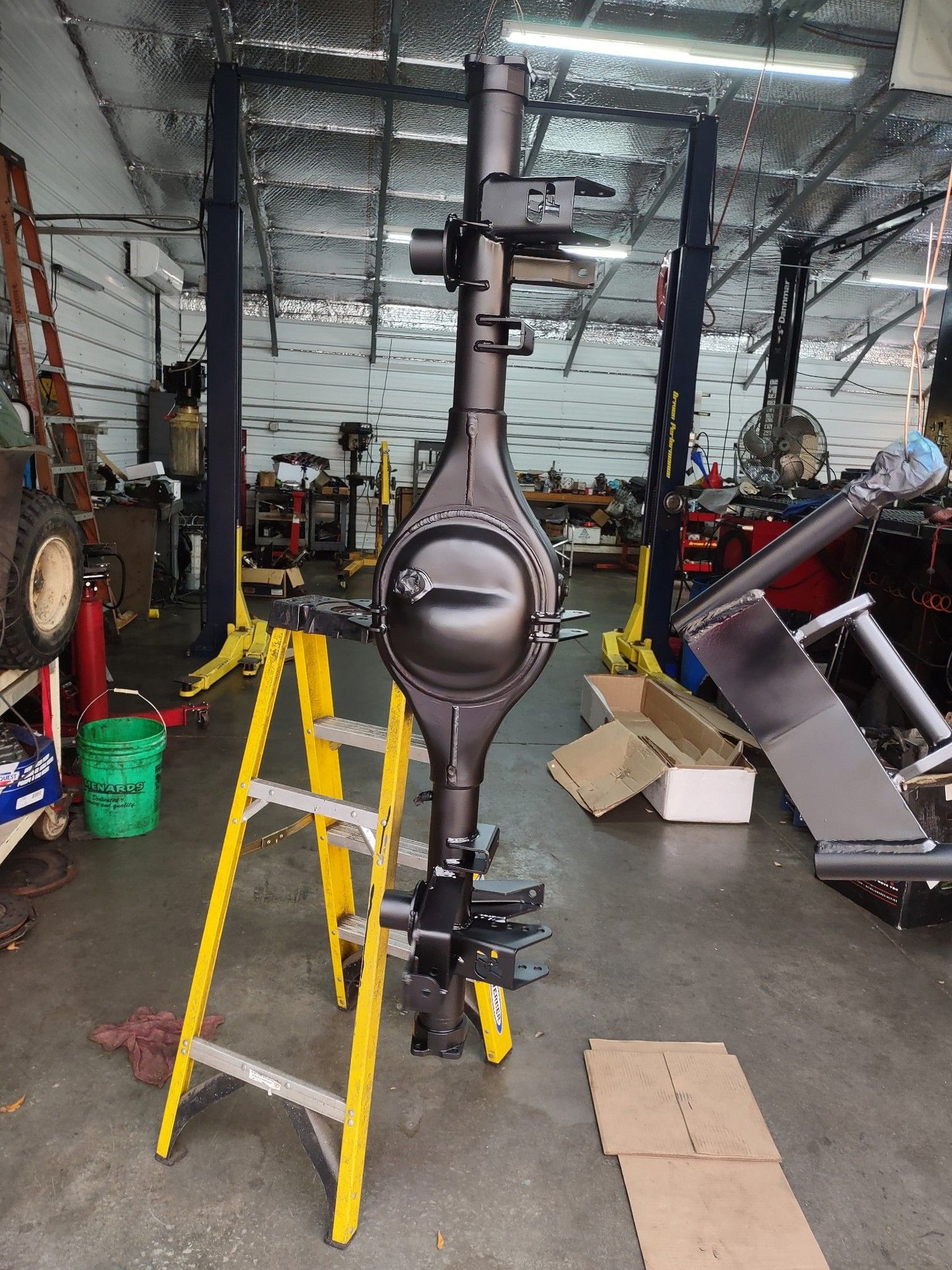

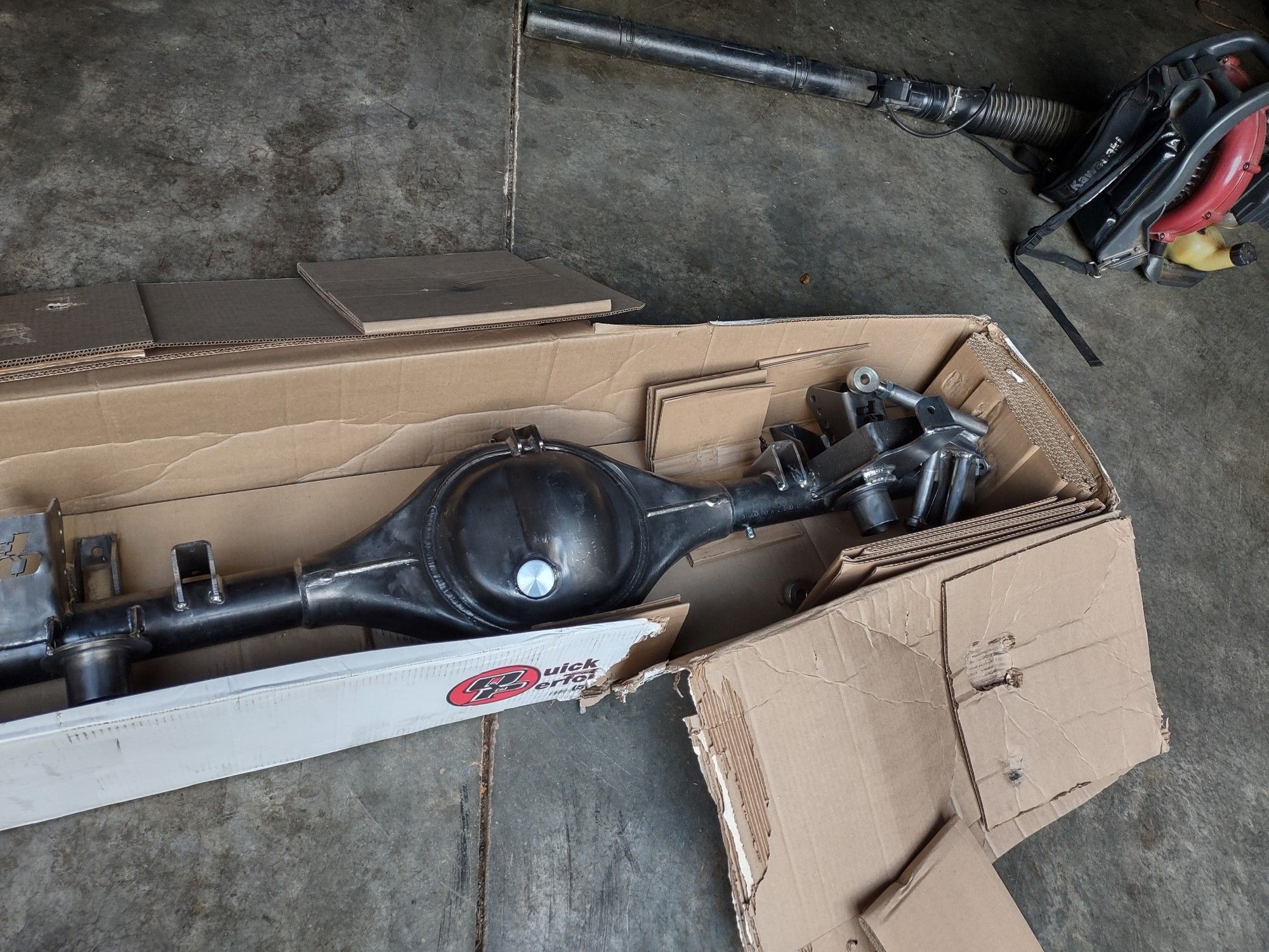

Update on build... PST driveshaft ordered, and the 9 inch is under the car.
Next is suspension.

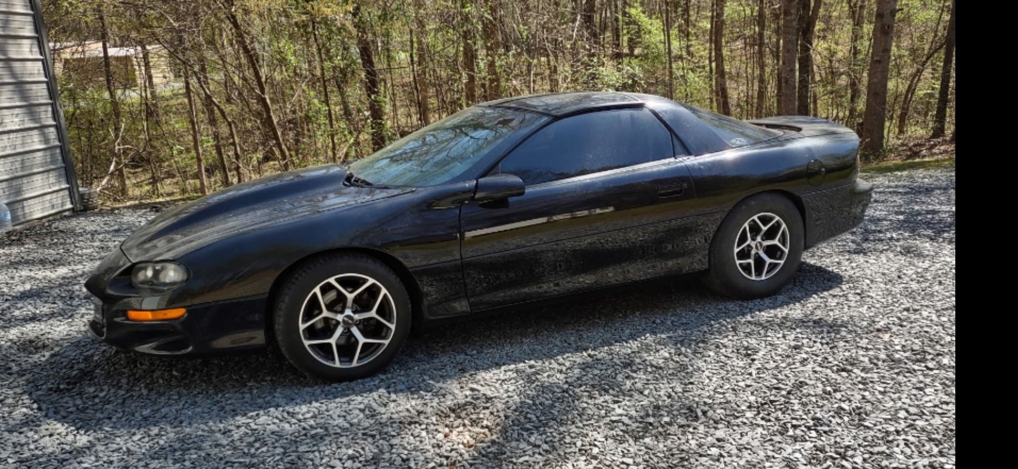

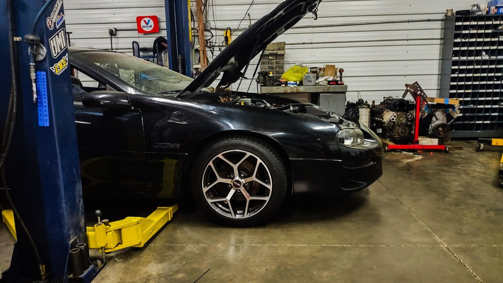

Update... the car is just about done. It looks different now due to a slight wheel and tire change. ZZ came across this setup. First i was skepital on how it was go look but it turned out better than i thought on the wheels.
Old Apr 9, 2025 | 07:03 PM
  #59
Posts: 22,293
Likes: 3,617
Gotta say, I LIKE those wheels! Lookin' GOOD!
