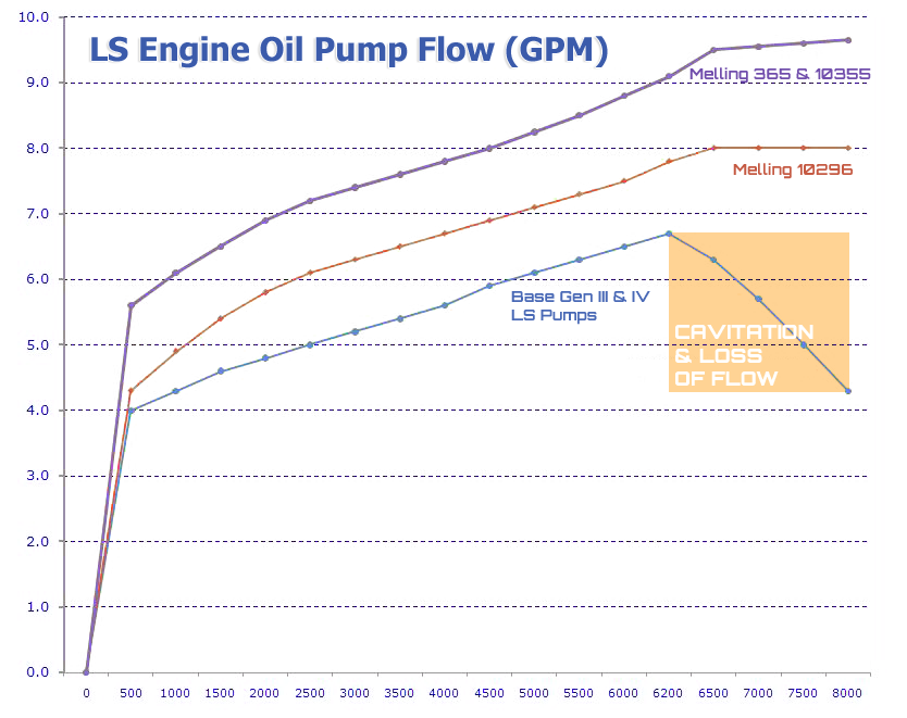

Ok guys, I have a question. As some here know I'm rebuilding (again) my LS7 heads. I ran a Melling 10296 oil pump previously. Block has 8 piston squirters, which lowered the hot oil pressure@7,000rpm to approximately 50lbs. Pump is worn some (80,000 miles in 19 years), so I was going to buy a new 10296. I talked to @Che70velle about this and we agreed this should be good. New pump might bring pressure up 3-4lbs. BUT, something has changed since I talked to Scott. Tony Mamo is doing the heads/cam. But what has changed is Tony is recommending Johnson 2110 drop in lifters. I've researched these and it seems they tend to bleed off maybe 5lbs of oil pressure. This would put pressure down even a bit more, probably just under 45lbs@7,000rpm. I'm thinking thats a bit too low. Wondering if I should get the 10296 and run the high pressure spring, or get the Melling 10355?? What do you guys think? Thanks, I value your inputs.......

I'm far from being any kind of expert here, but one thing I've always heard is, it's more about flow than pressure.
A lot of flow at a slightly lower pressure shouldn't be TOO big a deal.

If you have piston squirters, you may want to look into whatever people are running on Gen 2 CTS-Vs and 5th gen ZL1s with the LSA block. I'm not sure what those guys are using but I know they need more volume because of the factory piston squirters.

I have a 10296, not a 10295. I think it's a standard pressure spring, IIRC, as it has been in there for 19 years. Yes, the batwing C5 pan. Pre-filter pressure is 10lbs higher according to my mechanical gauge. So, 50lbs at 210° after the filter means pump is actually making 60lbs. before filter@7,000rpm. 10lb. diff I expect reflects the 8 piston squirters bleeding off pressure. Cold pressure is 50lbs AT IDLE. Cold pressure, IMHO, means little. I'm thinking of ordering the high pressure spring from Melling, and comparing it to the spring in my pump. Then I'd know for certain what I have........

I talked to Tony last night. He wants to go with the M365 pump. He also recommended porting it, so ported M365 pump it is.....
