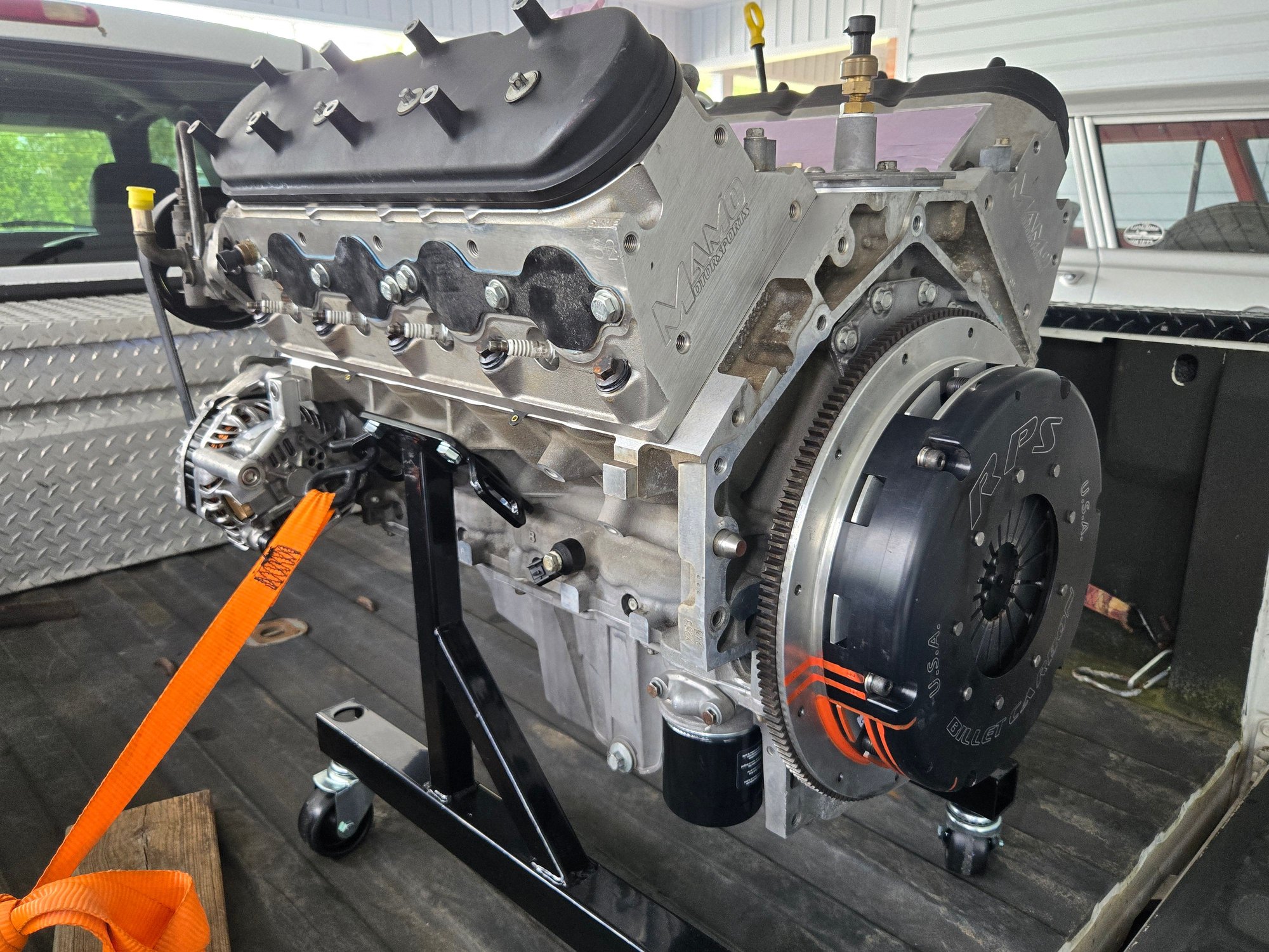

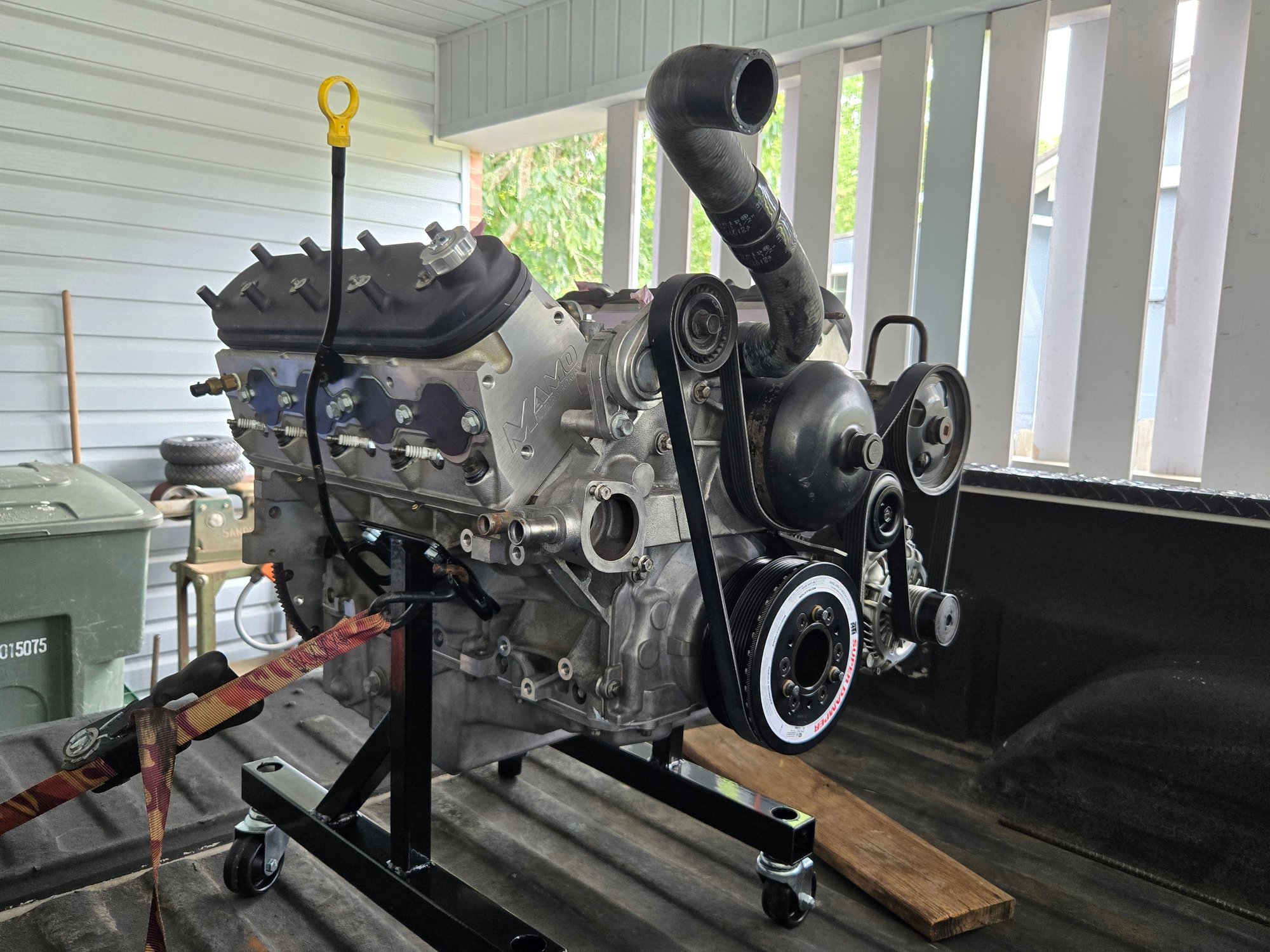

It's close!!!

You're going to love that clutch.

I got a killer deal on the clutch!!! $1000 and I had Rob(RPS) put new hubs in for $200. Used but zero wear on the disc.
