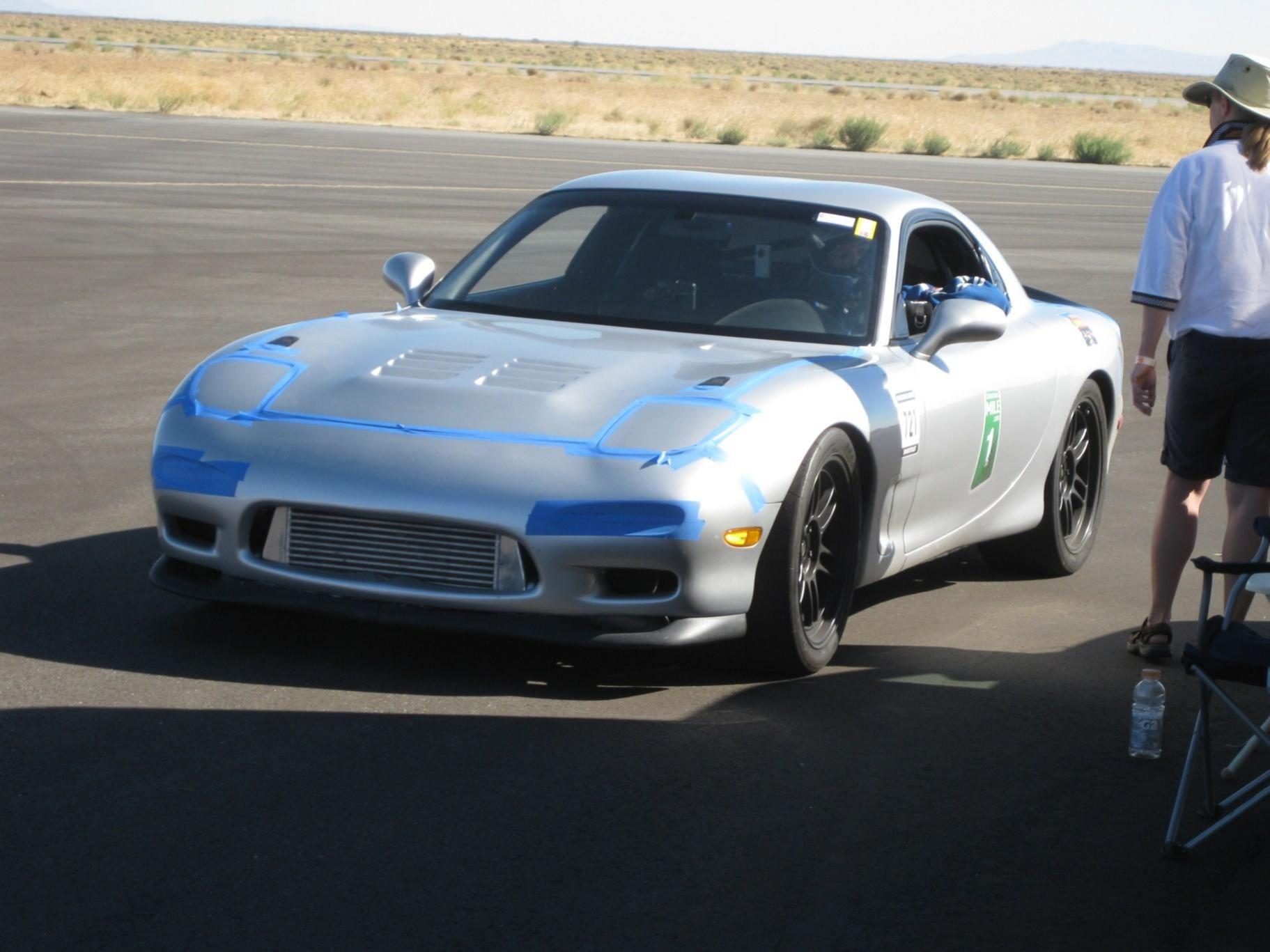

We used an LG Motorsports Executive cam (sleeper cam) with basically stock sounding idle in a 376ci LS running Precision GTS76 turbo. On 14psi it made 1060rwhp and drives like a kitten until you make boost. On 22psi this thing rips in a 2900lb RX-7.
You can see the power falling off after peaking which we found out on the dyno was from not enough wastegate spring. We would command 14psi and then after hitting it ..... boost would fall off. We solved that and she's a beast.
