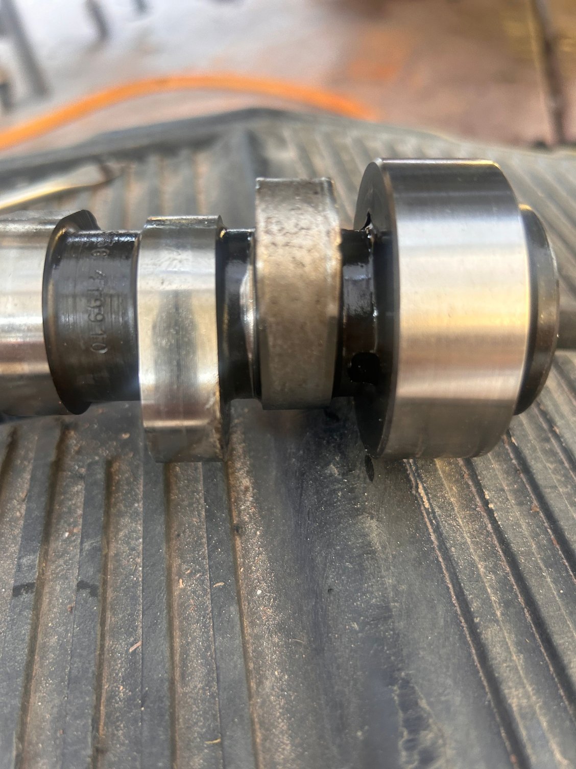

Hello, I have a 2015 Camaro Ss 6 speed and about 4 months ago I tore one of the lifters and the one can live was ate and 1 lifter destroyed I got a shop to fix the lifter bore and a cracked cylinder sleeve and I told him to replace also the cam bearing but he didn’t he told me they were good and there was no need to change them so I trusted him because he should know more than me I put the engine back together Johnson lifters, gpi ss4 nfc cam, new piston rings, all new gaskets, 10295 oil pump, put rivets on oil valley, plugged oil bypass valve on oil pan, new oil barbell, Che trunions, comp cam pushrods, when I went to start it up it started up great like nothing happened some ticking but went away after couple of seconds but I got 45 psi cold 15 psi hot😭 pressure will go up with rpm I tried almost everything changed pump and o ring, checked with mechanical gauge, but still the same I’m guessing it’s the cam bearings, maybe the little part of the cam bearing that is hit it’s the problem.
i also found white stuff at the bottom of the oil pan after rebuild maybe condensation since it’s really cold?
5w-30 móbil 1 oil
Attached Thumbnails Ls3 Bad oil pressure-img_5375.jpeg   Ls3 Bad oil pressure-56a34114-0e87-46b8-9772-2bf73cb24c3e.jpeg   Ls3 Bad oil pressure-3c08fb3e-e36a-4600-b6ef-0df64c3e5f9b.jpeg

Do you have a pic of the new lifter bushing, from another angle? I’d like to see how he drilled the oil circuit hole through it. If no picture of that, did you confirm that the oil circuit was drilled through the bushing body, left to right?

Do you have a pic of the new lifter bushing, from a closer angle?

here’s a closer look at the lifter bushing and the cam bearing

I don't see anything wrong with the cam bearing. It does however look like that broke-off bit of the block might be exposing that passage, between the 2 lifter bores. Should be welded up if so.
It would have been easy enough to run a long drill into the oil passage from the front or rear of the block to drill the hole in the bore bushing. Can't tell whether that was done or not.
White paste looks like some kind of build lube. No idea what. I've seen moly grease accumulate like that, butt it's kinda bluish-gray, not white.
