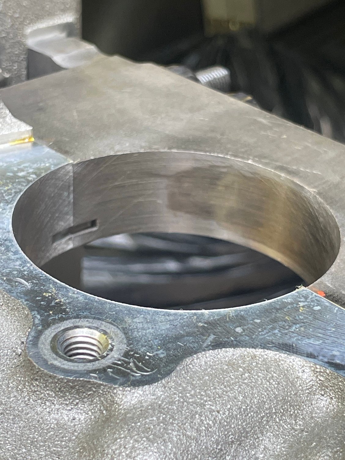

Years ago, when Wheel to Wheel was around (world class builders), I had them assemble a 427 Darton sleeved LS1 block. They told me that when running the ARP main studs some blocks needed the mains align honed, and some didn't. Mine didn't. HOWEVER-Che70velle recently posted some pics on here that showed what the mains looked like after align honing. It showed some of the blocks main saddles didn't quite clean up completely. I'm sure the block he showed would've been OK. However, without the honing, maybe the crank would've been tight in areas when you'd spin it. But who knows if that would've been an issue 75,000 miles down the road. The only way to know for sure if you need align honing is to torque the caps and measure the I.D. with a dial bore gauge. Even then, this still won't tell you if all the mains are perfectly in line. After seeing his pics, I've decided that, for me personally, I'd have the mains align honed.

That pic is always worth showing again. This hone was a super quickly, just enough to get the journals back to round. Pay attention to the side of the journal, which is where material was actually removed, which proves that using ARP main studs takes the journal out of round…but any fastener that introduces more clamping force will do the same in any situation. This journal measured 2.7504, and all 5 were within .0002. We measure out to the .0001….
