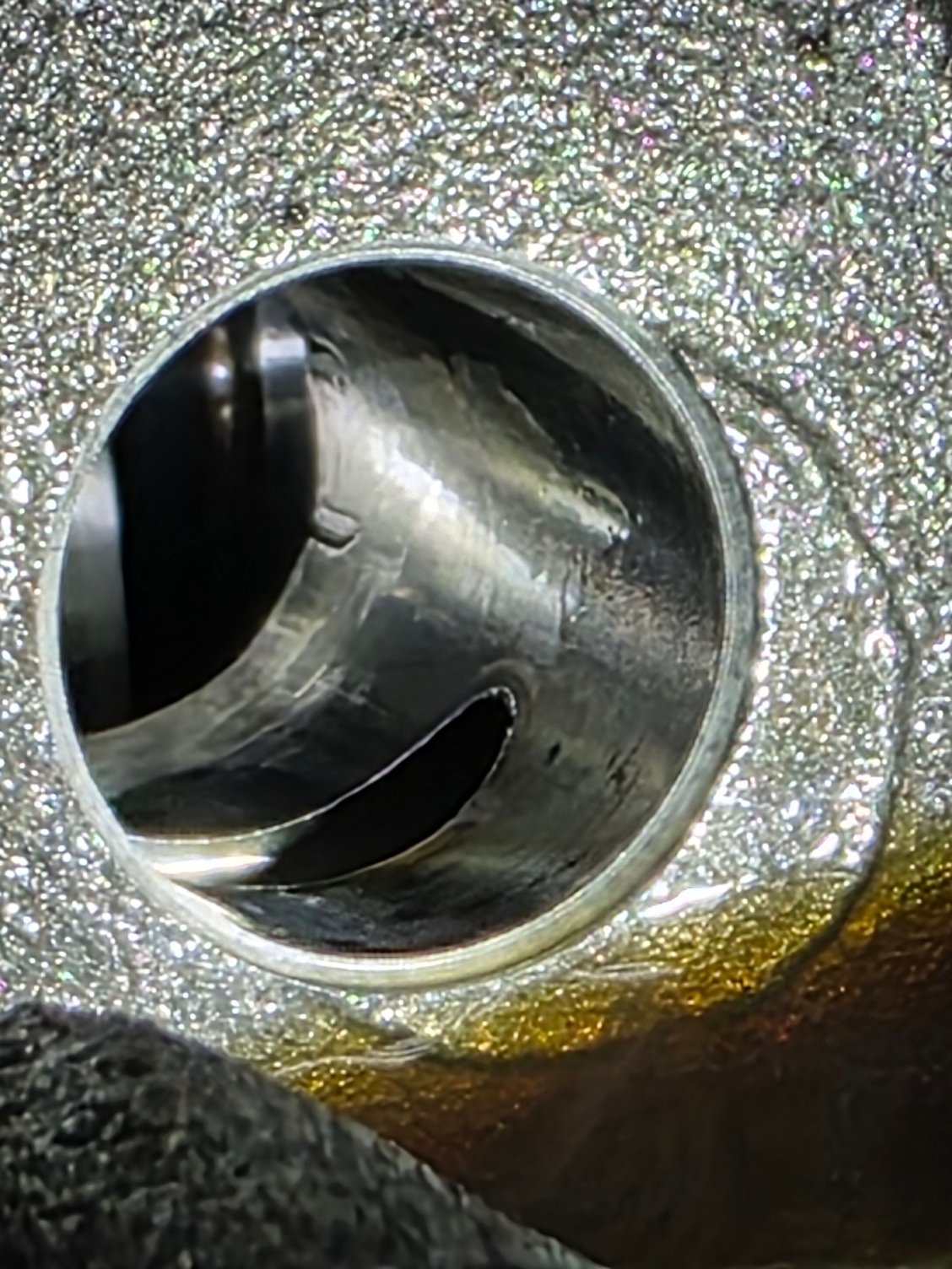

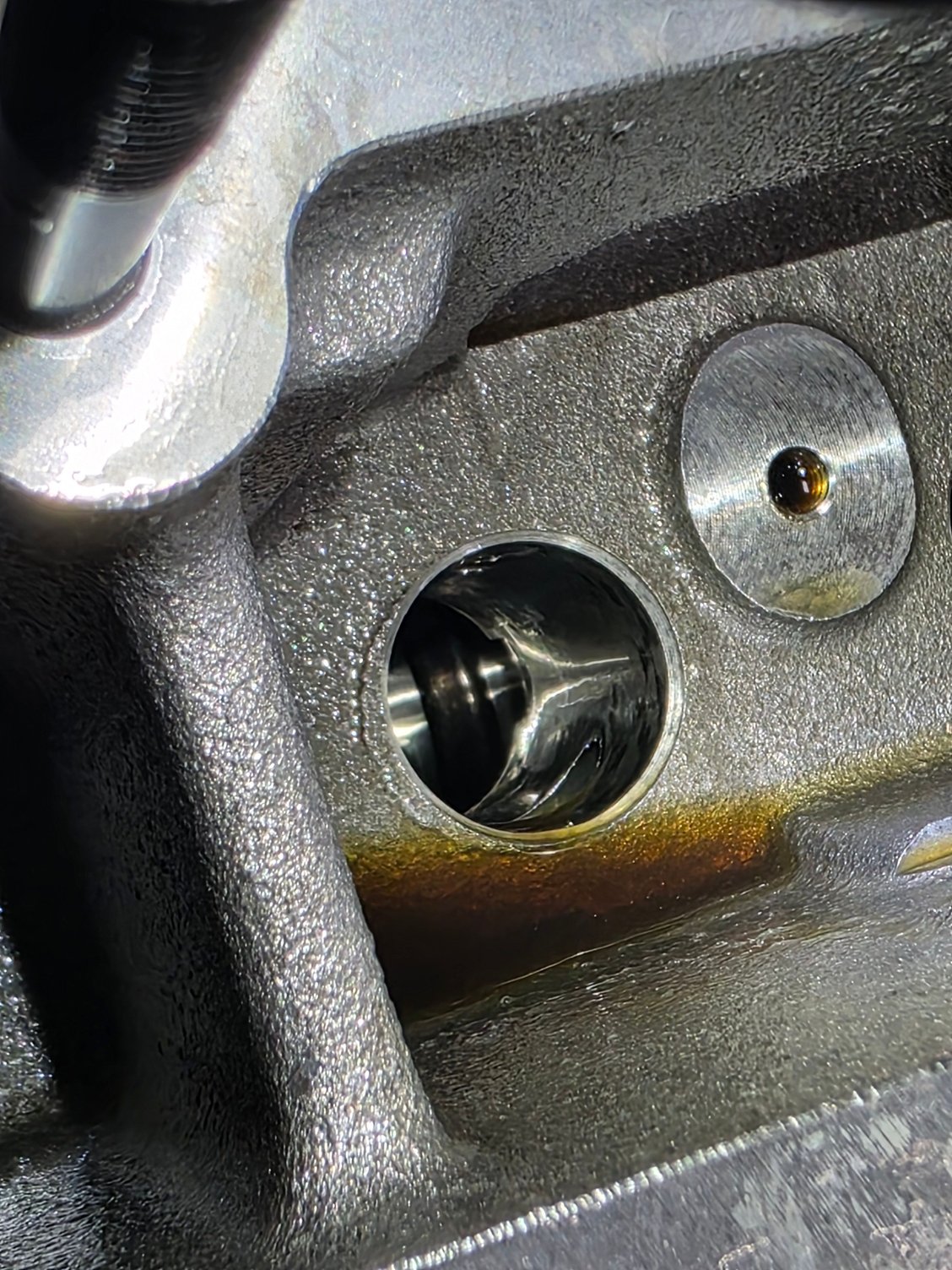

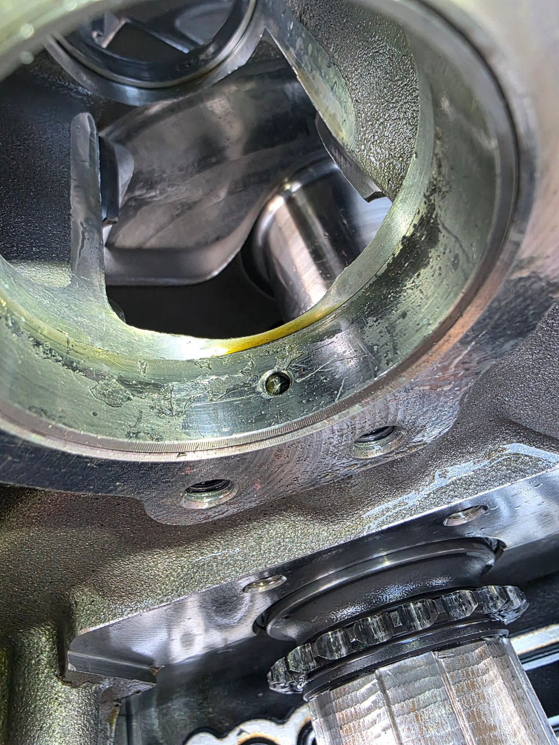

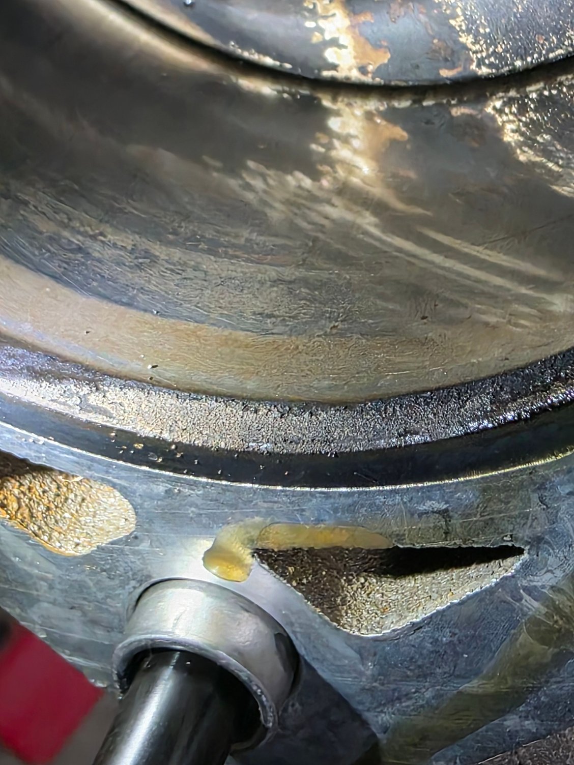

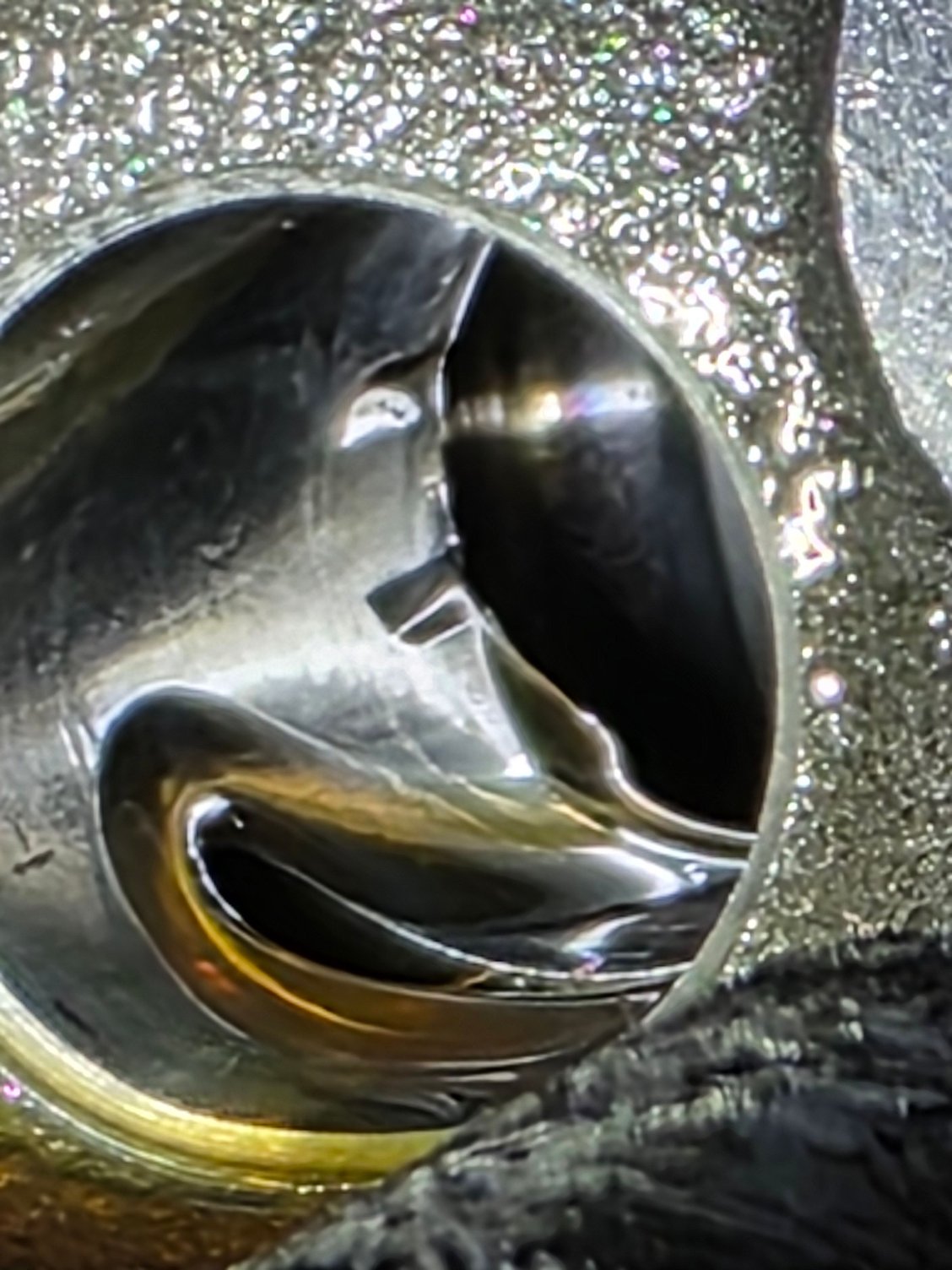

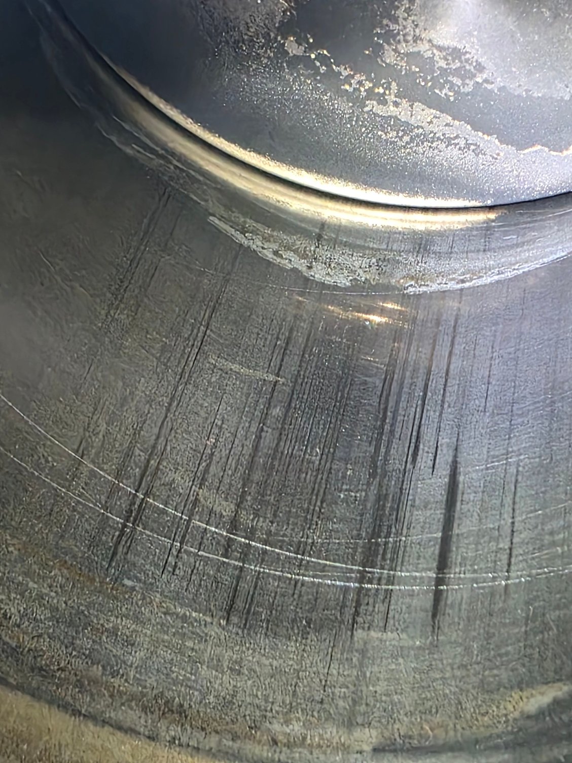

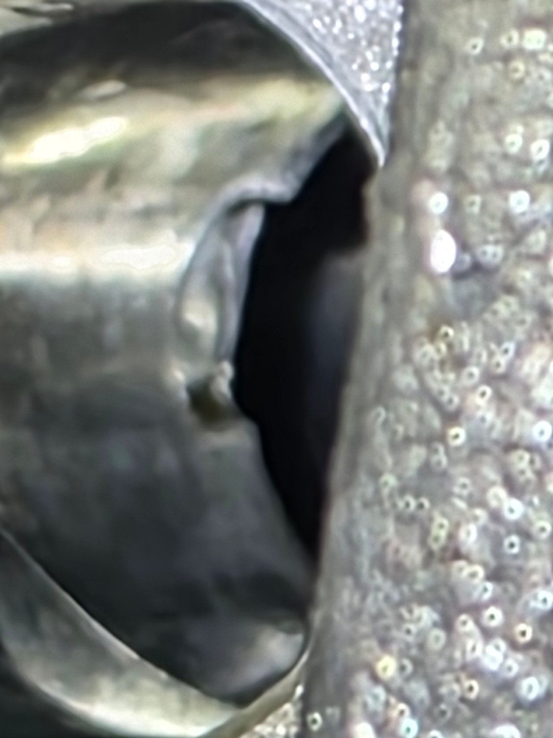

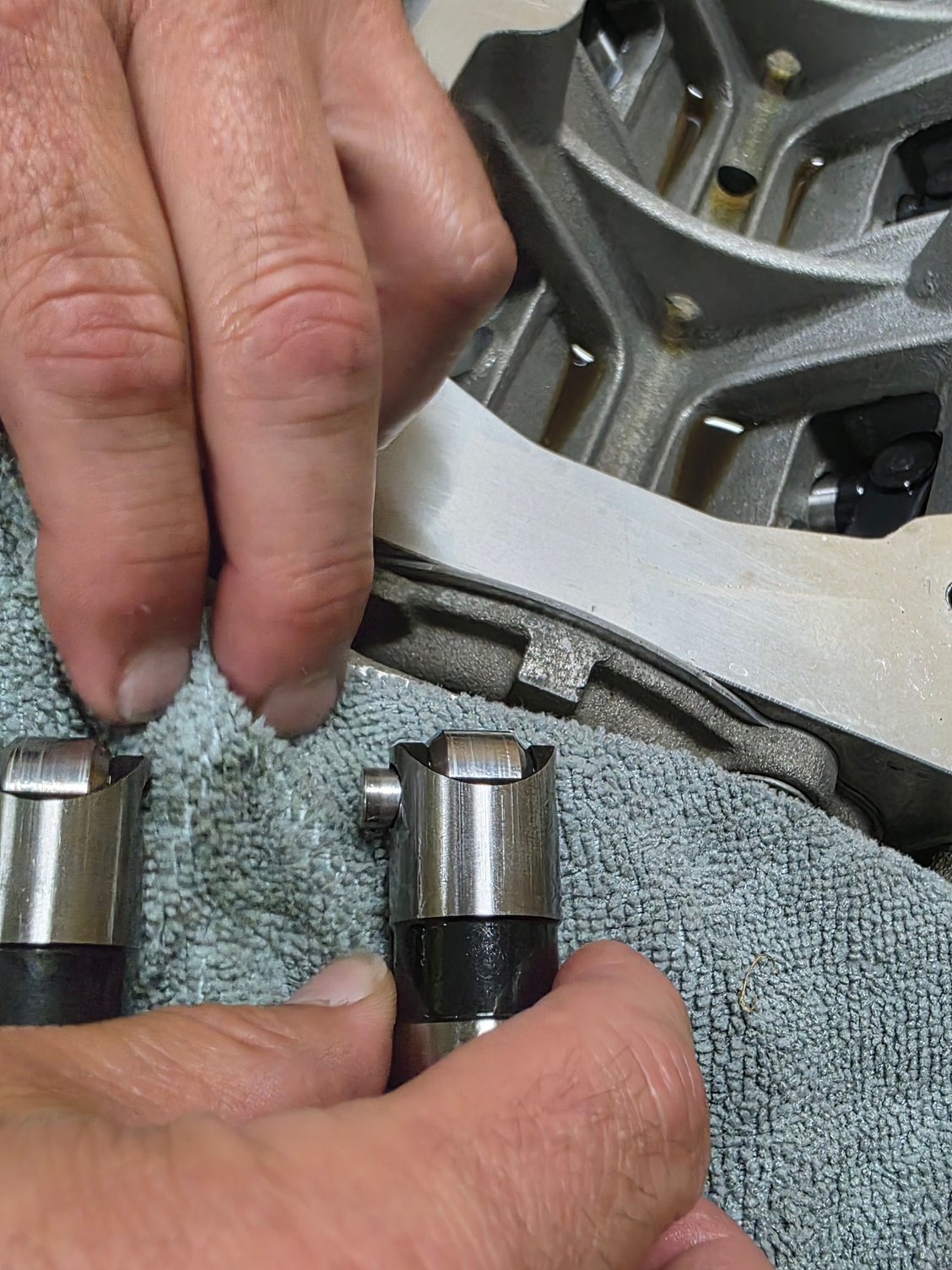

For anyone wondering about this... Tore into this engine completely to see about some suspicions that other parties involved did not care to look for and found a few reasons for lack of power and rpm.

So what do you think happened here. Is there enough room on LSR block to pull the lifters out without taking off heads?
Old Sep 18, 2025 | 08:05 AM
02EBC5Z06's Avatar
Joined: Sep 2017
Posts: 764
Likes: 437
From: Massillon, OH
No, need to pull the heads. I looked them over, there was no sign of valvetrain abuse. I think it was just part of a bad batch of lifters from Johnson. They replaced them though.
But the metal from that is all through the motor. Some in the cylinders.

More updates... The motor is at BES getting some love. Cylinders were honed/cleaned up. Pistons, rods, crank will be reused with a new set of bearings and rings. Heads just got back from Cesar at CT Porting. Had some tiny tiny cracks between the intake runners and valve cover bolt holes. Cesar ended up just cleaning the ports up until the bolt holes were completely through, so the valve cover bolts will just need thread sealant (not a big deal).
The two lifter bores need to be bushed still I believe.
