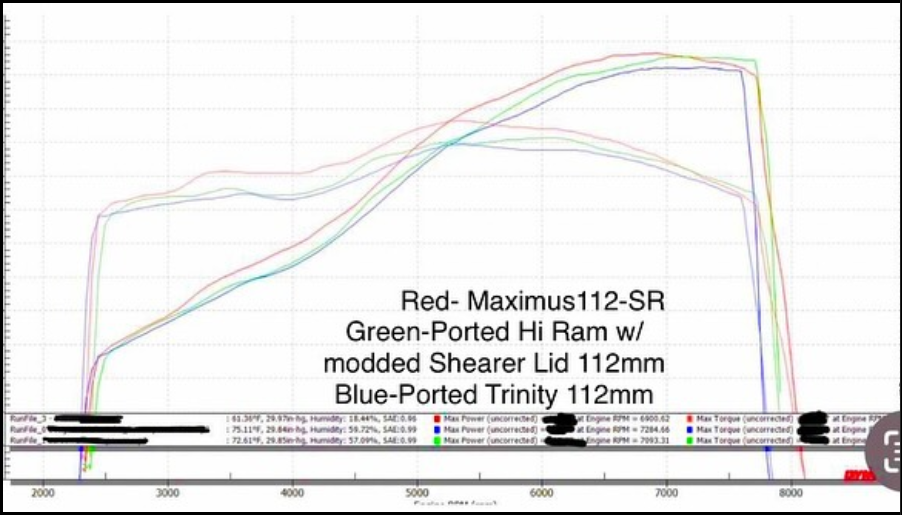

Trinity won't outpace an Ironmask short runner MSD until closer to 7k. His modded MSD basically mimics a standard hi-ram, but with better down low torque.

Even over 7000 it still might not catch up. Ironmask posted a dyno graph on Instagram about a year ago that showed the Maximus 112SR beating a ported Trinity with a 112mm throttle body all the way out to 7500 or 7600 where they were about to intersect. No idea if it had V1 or V2 runners on it though or how big of a difference that would make. I also have no idea what the rest of the setup was, but I'm guessing it was a pretty hot setup.
