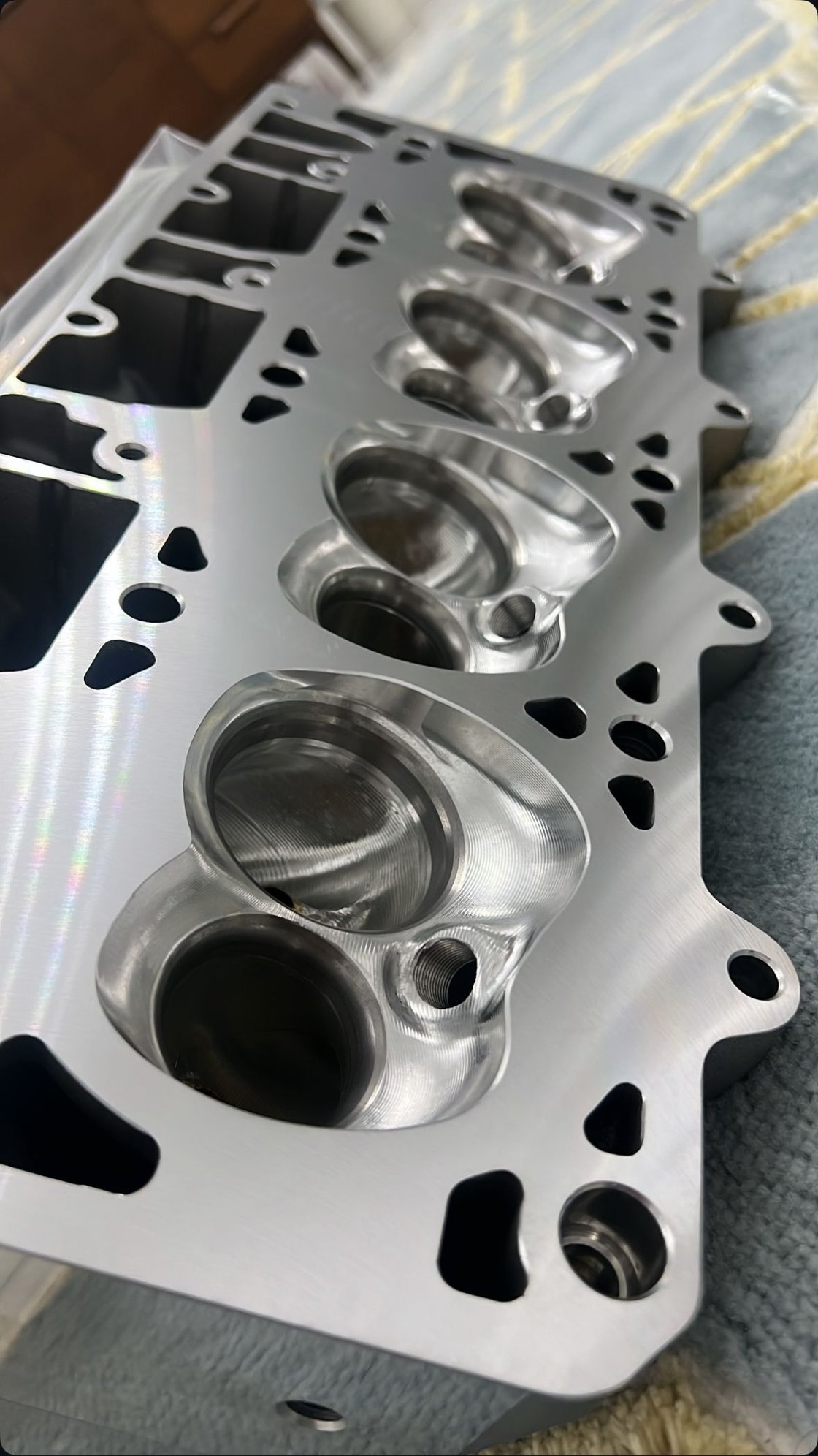

Thanks man, solid input. This one’s built for time attack so I’m more worried about staying alive at RPM than chasing a dyno number. Running a Low Ram with a Nick Williams 102, and stuck with Ferrea hollow-stem stock valves for endurance—trying to keep guides and seats happy over long sessions.
Cam is 235/242 .621/.592 111+3, should give me the mid/top I need , on 1.8 rockers it should be .657/.627 lift
And yeah, it’s a short stroke setup on purpose—keeps piston speed down and lets it live at higher RPM. I’ll trade some torque off the corner for that reliability

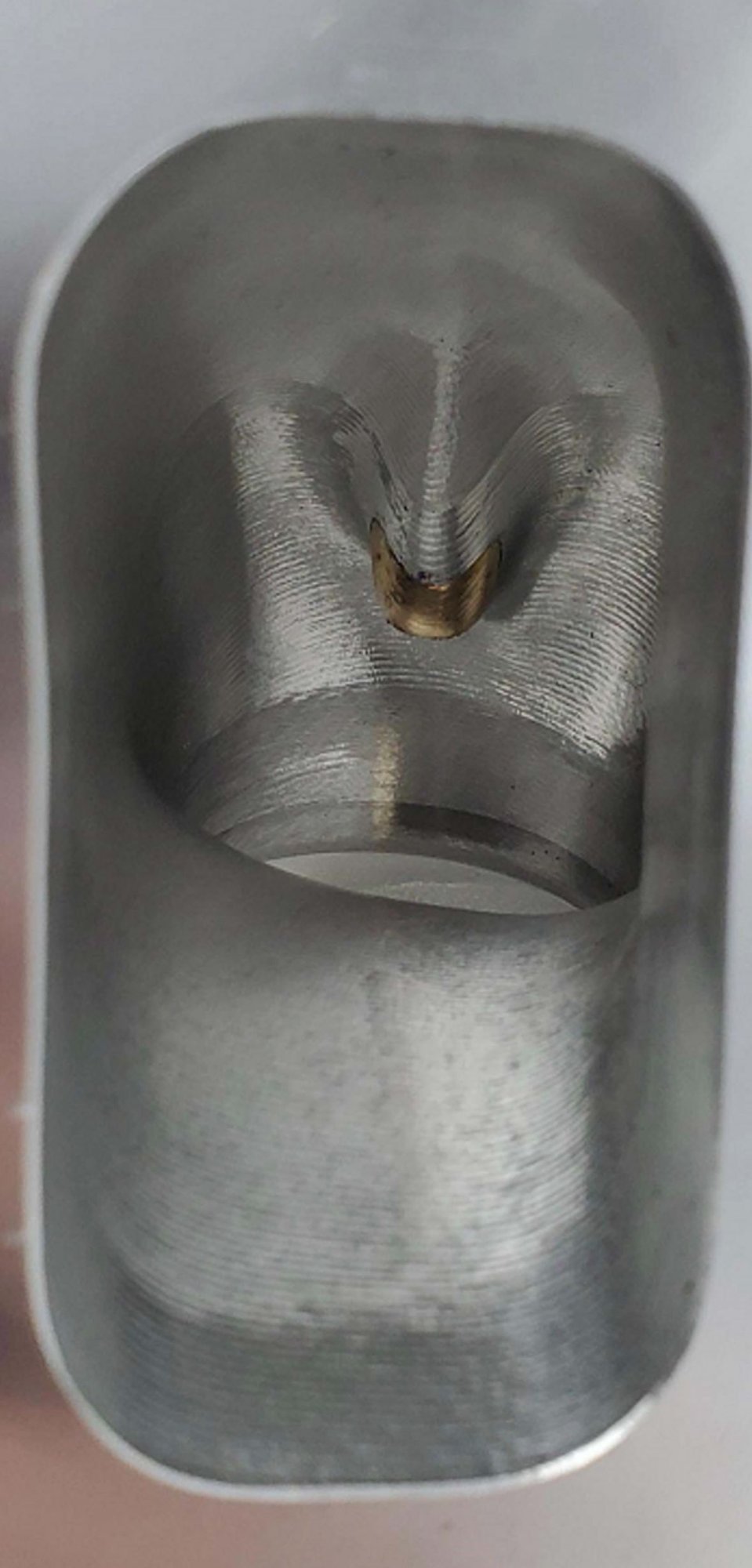

The heads are LS3-style, CNC’d by a local vendor here in Dubai. For initial running I’ll be on Johnson short-travel link bar lifters with Axle Oiling, just to get the combo dialed in. Down the road I’ll step up to Jesel or another big-body option—either by machining the stock block to accept the larger lifters, or moving to an aftermarket block and get the extra benefit from mains oiling priority
During the early phase the engine won’t be spun past low to mid 8k rpm, but once everything’s proven I’ll start pushing higher. That way I can shake it down without turning the dyno room into a parts shower.
