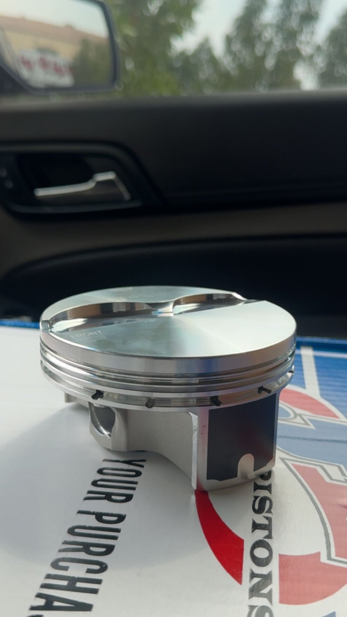

The pistons in your pic…post up the data sheet on them please. Curious about the CH….
part number 311969 from JE
2618 pistons 1.304 comp hight
-5cc flat top bore 4.125
this made to go with 6.125 rods and 3.622 stroke
but if you compare it with 3.267 stroke and 6.3 rods + half the stroke you will get 9.2375 which is 0.0025 below deck surface

R35, I gotta say I LOVE the wording on that piston!! Similar to the biker jacket "if you can read this the b...h fell off!!

You’ve got a very mis-matched setup here. You need a piston with a 1.2655 CH, to be at zero deck height. Do you have a builder, or are you doing this yourself?
Old Oct 20, 2025 | 08:44 PM
  #40
Keith's Avatar
Joined: Oct 2002
Posts: 2,782
Likes: 95
From: Mefis
What connecting rods are you running?
