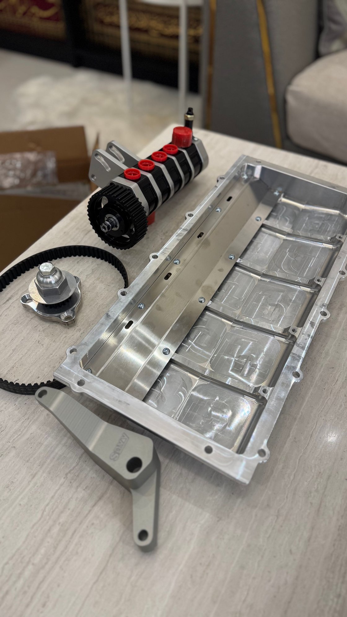

Old Jan 31, 2026 | 04:13 PM
  #49
R35Q8's Avatar
Joined: Jul 2025
Posts: 36
update
after 4 months of waiting finally the drysump arrived
Old Jan 31, 2026 | 08:19 PM
  #50
Posts: 7,799
Likes: 5,133
Nice!!
