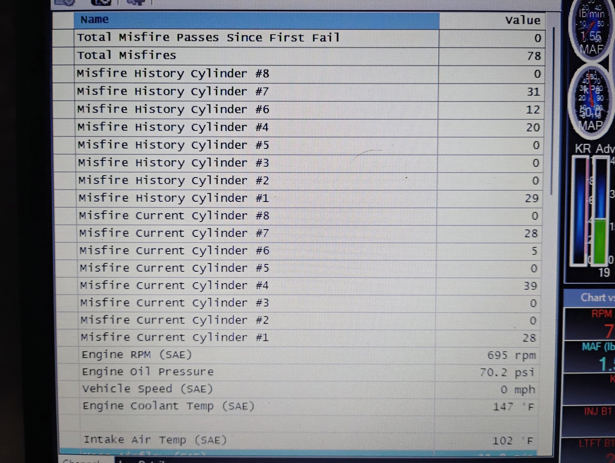

Registers about a 100 random misfires (mainly 1,4 and 7) in the first 15 seconds of running then clearing out as it idles
When decelerating it might buck then misfire but might or clear on its own or with a rev.
Let from lunch and it missed in start up and the light came on (first since putting pushrods,) I cleared it and the counts seemed to stop.Drove a few blocks it did it again , I got on the go pedal a quick rip and the let it idle and seemed to have little to no counts.
When to park as a slowed for the dip to pull in there was a flare of misfires about 60 then parked and idled. The idling cleared out the register misfire counts.

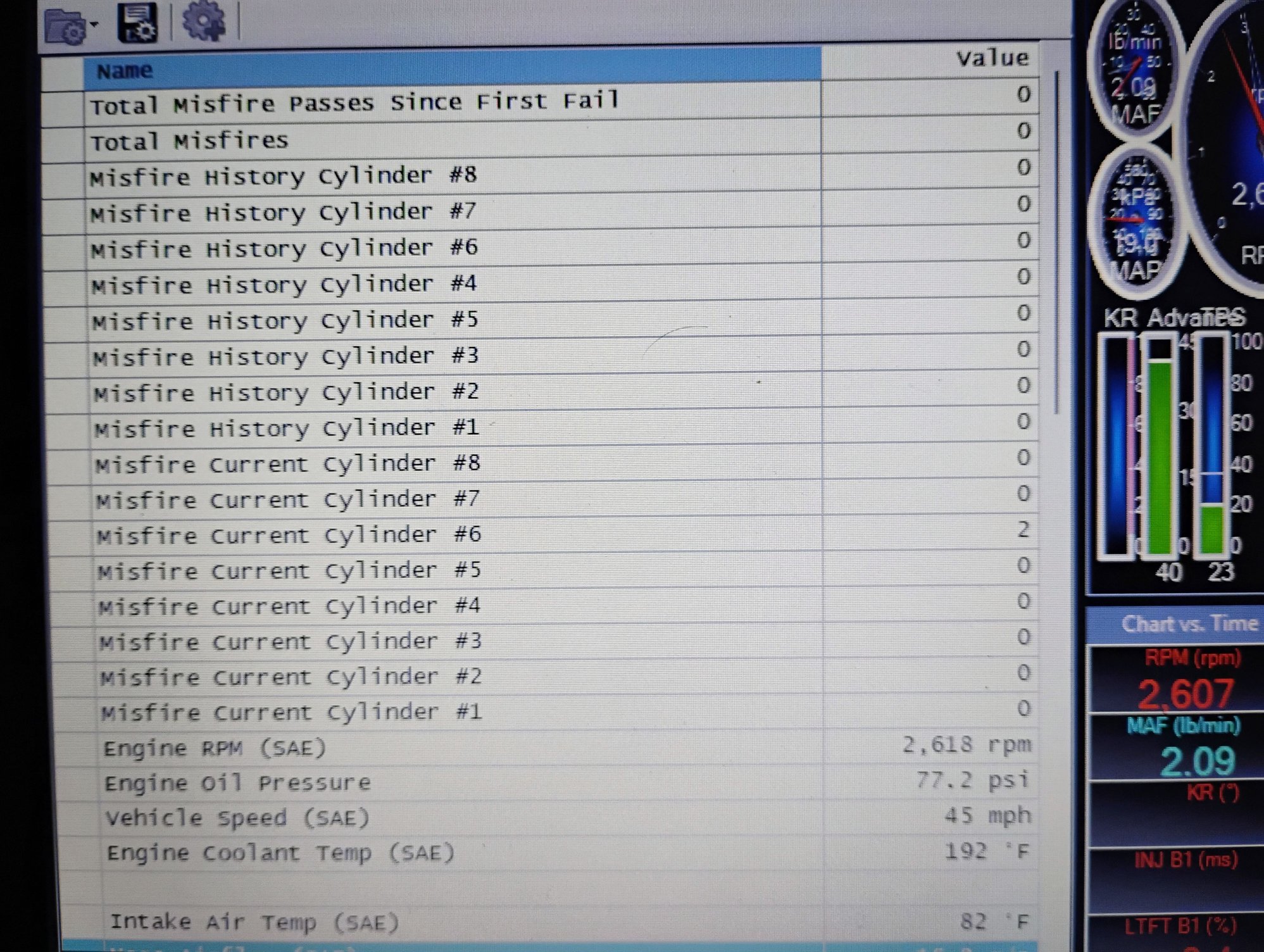

Before starting leaving work

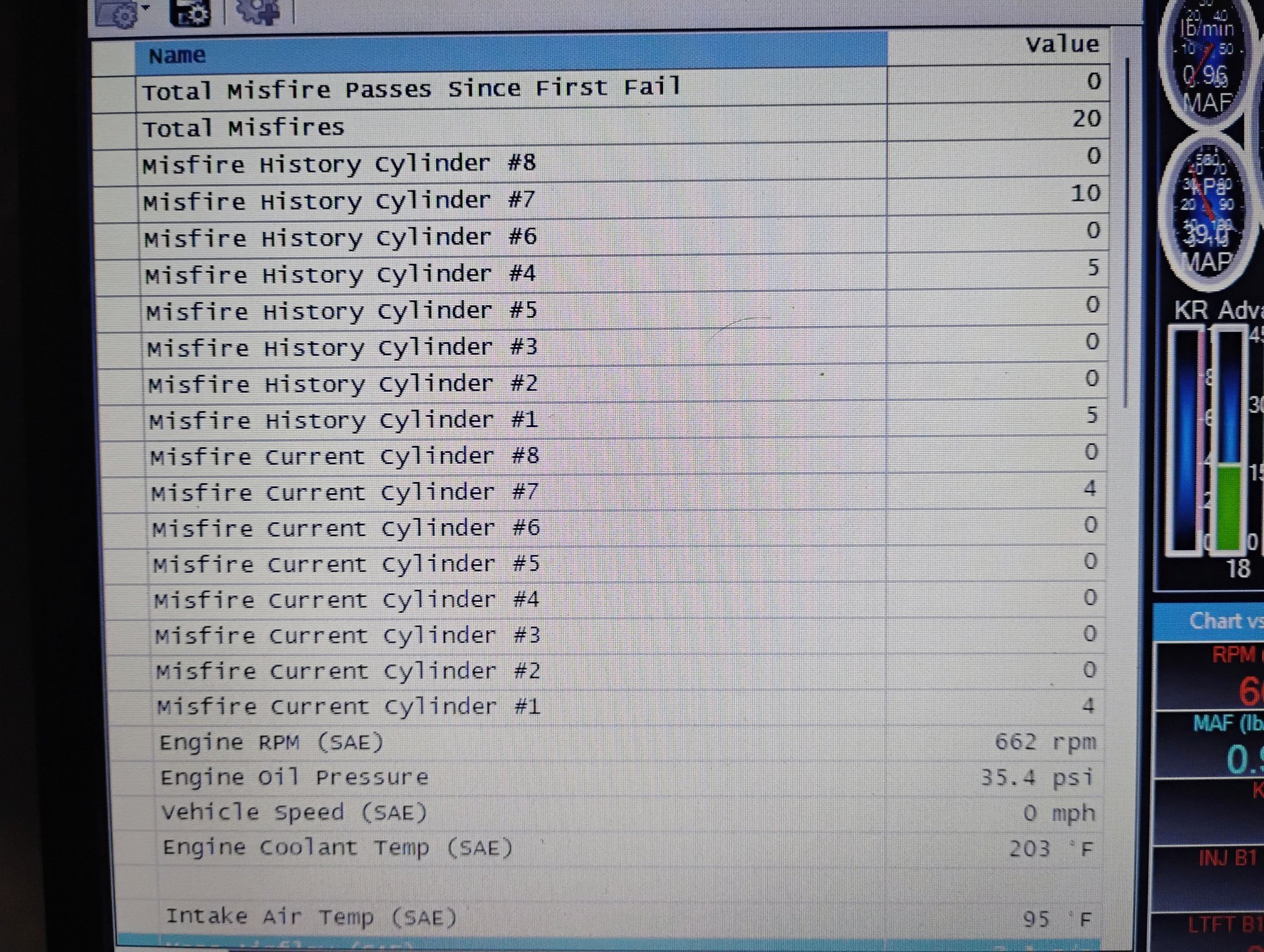

Hiccup when pulling out
Cleared out
Cleared out

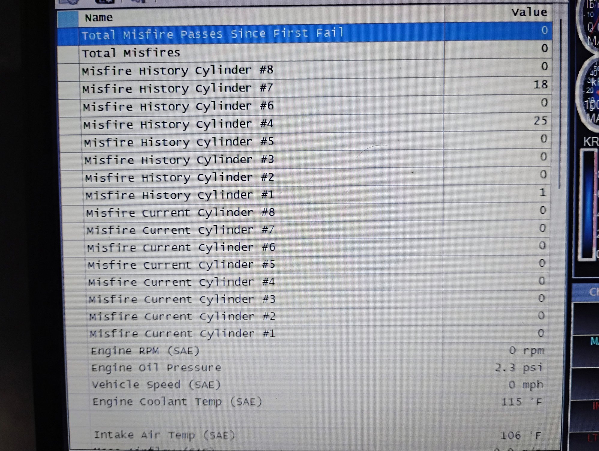

Did another slight stumble miss when pulling in. Pulled up the driveway aggressive when stopping suddenly it surged a little then smoothened out and cleared out the counts on its own. A few hair counts.
Lil by little improving.
Cleared it self out idling in driveway
