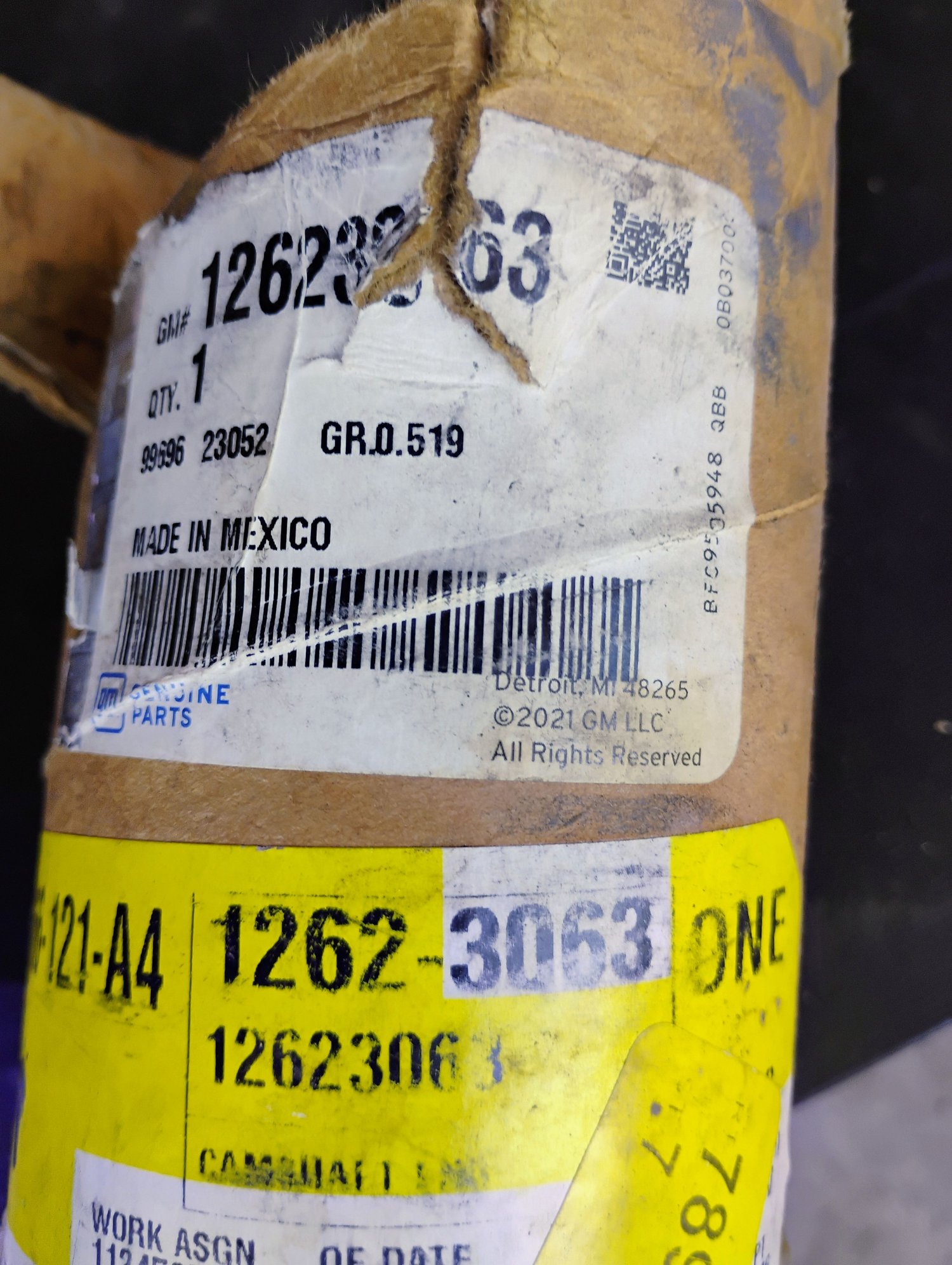

A DOD cam has different base circle/lobe numbers on 1-4-6-7…vs…2-4-6-8. DOD lifters are lobe specific in that regard. I realize that you posted that you installed an LS3 camshaft, but are you 100% sure that you didn’t install a DOD camshaft instead? Maybe check the part number of your camshaft to make sure. It sure sounds like you’ve got a DOD camshaft with standard lifters installed.

Yes sir ordered a regular ls3 cam from Chevy
When messing with the pushrods last weekend #1 and #7 logged back in with great compression, I moved to 4 and 6 could get compression to go up unless I loosened rockers to the point where any more would have lash. Compression test showed about 30 psi more. Couldn't do anything to raise compression besides that. Tested 1 and 7 again after finishing and 1 stated 210 psi like 3 and 5 but 7 dropped to 150 psi.
