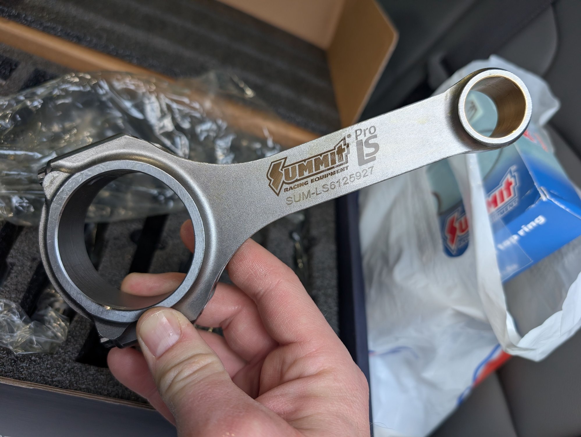

Not a big update, but rotating assembly is at the machine shop this week. We are using Summit pistons, rods, rings, and bearings. The crank will be an OE LS3 long nose crank and I am using a C7 dry sump tank with a C6Z oil pump and pan. I installed a billet 24x wheel on the crank to keep using the factory PCM in the C5. I was originally working with a company to develop a new dry sump system for the C5, but that got delayed. I had some of these parts already as a back up to the 3qt accumulator I was running so the factory style dry sump became the new plan for now. I also picked up an ARE LS7 pan for cheap which looks to have better oil control and scavenge. Still debating on using it or not at this point, as I would lose a drain plug, and I would need to plumb in a remote oil filter.
Summit mini dome pistons should be around 11.7:1 compression, assuming the deck is flat and using a thinner Cometic head gasket.

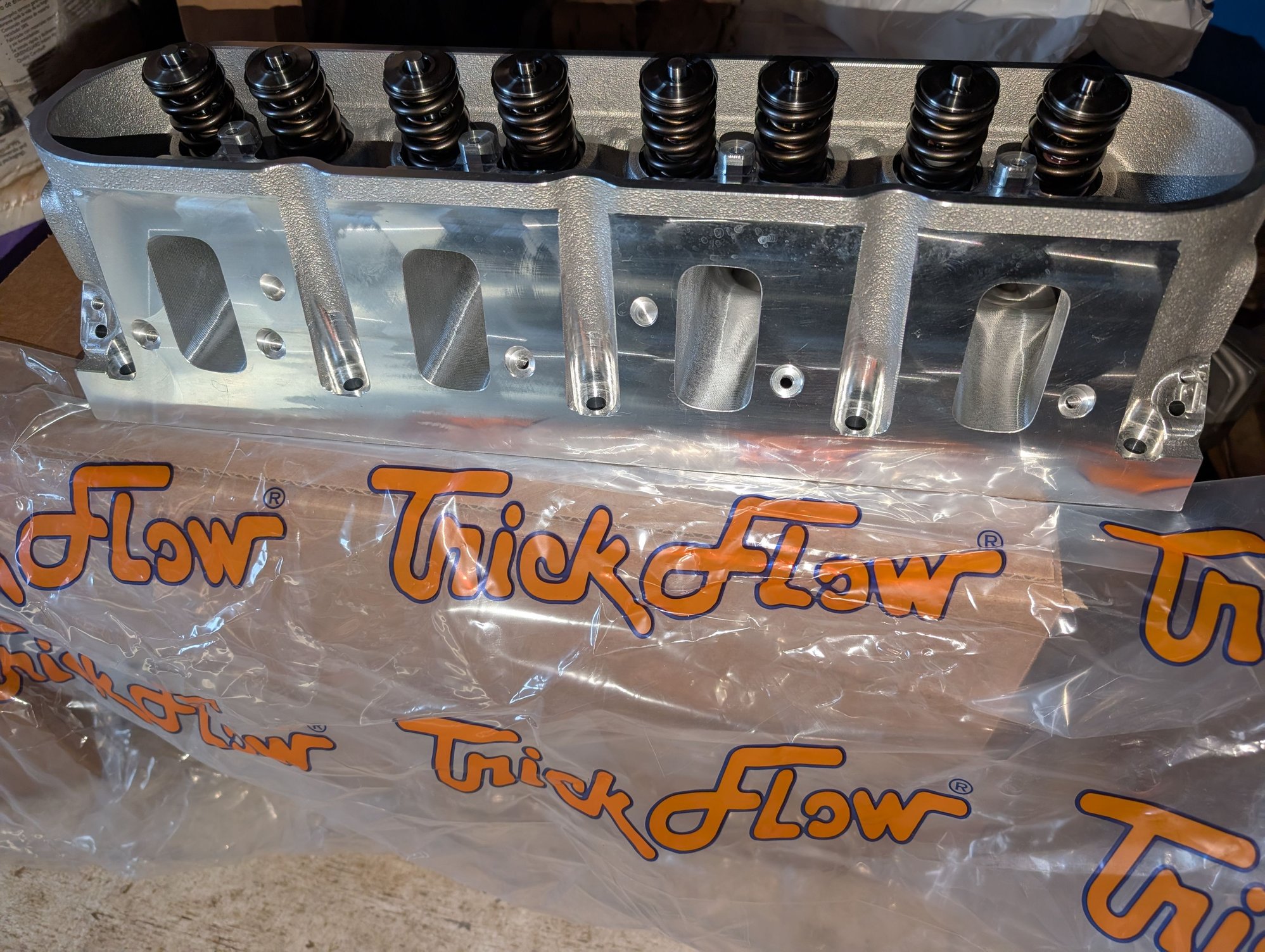

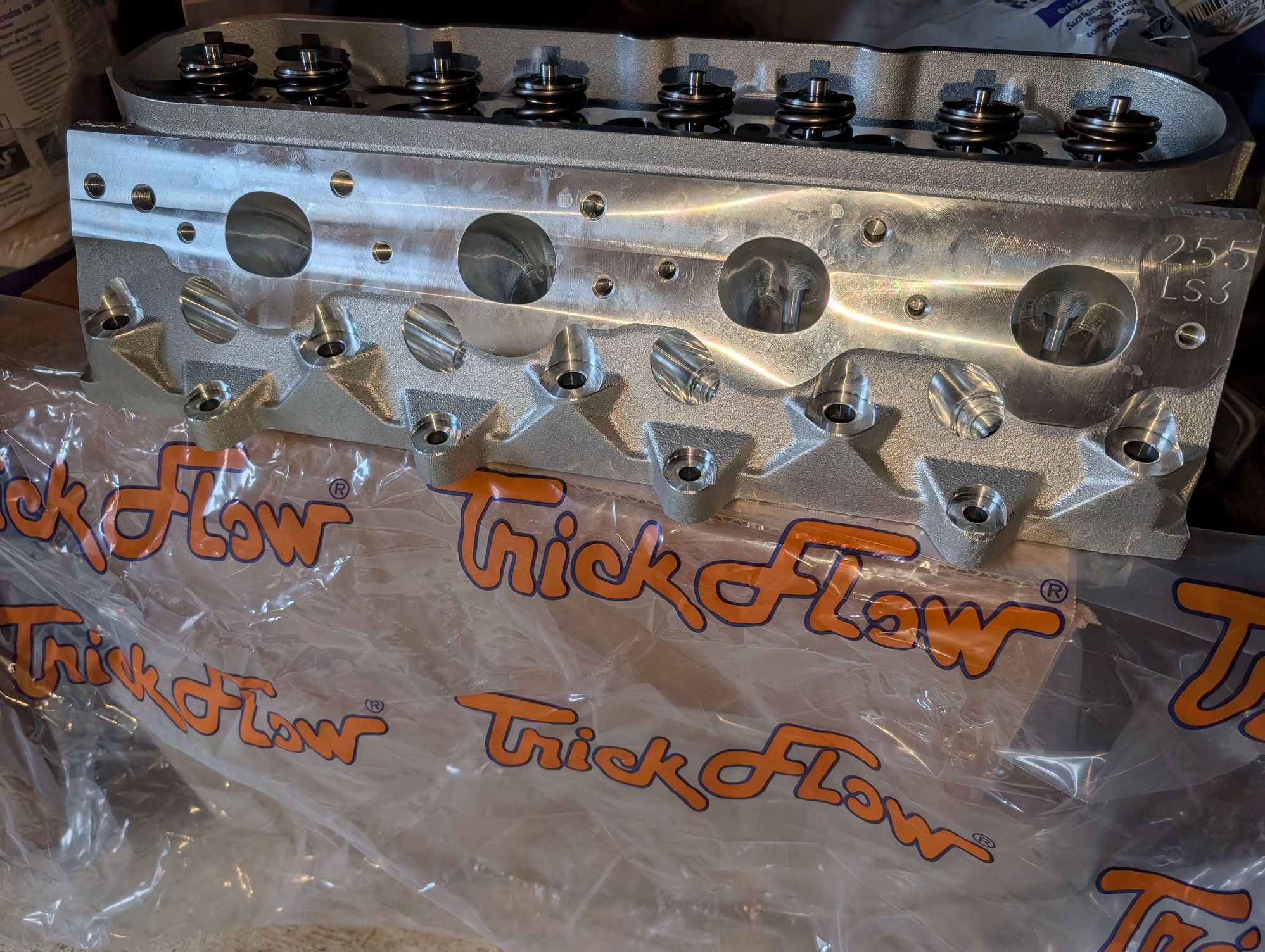

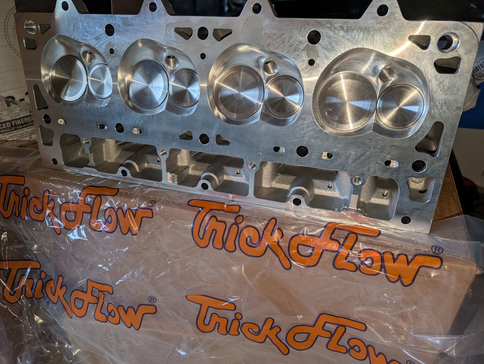

Another small update. I picked up the heads for the build yesterday (hot topic in here I know, lol). After some discussion, and due to availability I went with the 255 head. Primarily due to availability at this point. The 280 castings were still a few weeks out yet, and that would put me too far into the start of the season. Brian believes their new 280 casting would still show benefits up top vs the 255, but the 255 is still a great head! It would have been interesting to see on the dyno, and might still be a test we do later on down the road.
We went with the HD version though which has the heavy duty valves and smaller 67cc chamber to keep compression close to 12:1. Final number will be decided when the block is back and I pick a head gasket thickness.

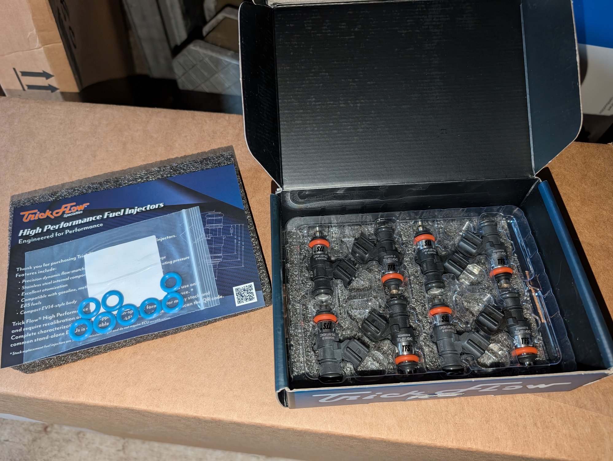

I also went with some flow matched 42lb LS3 injectors by Trick Flow.

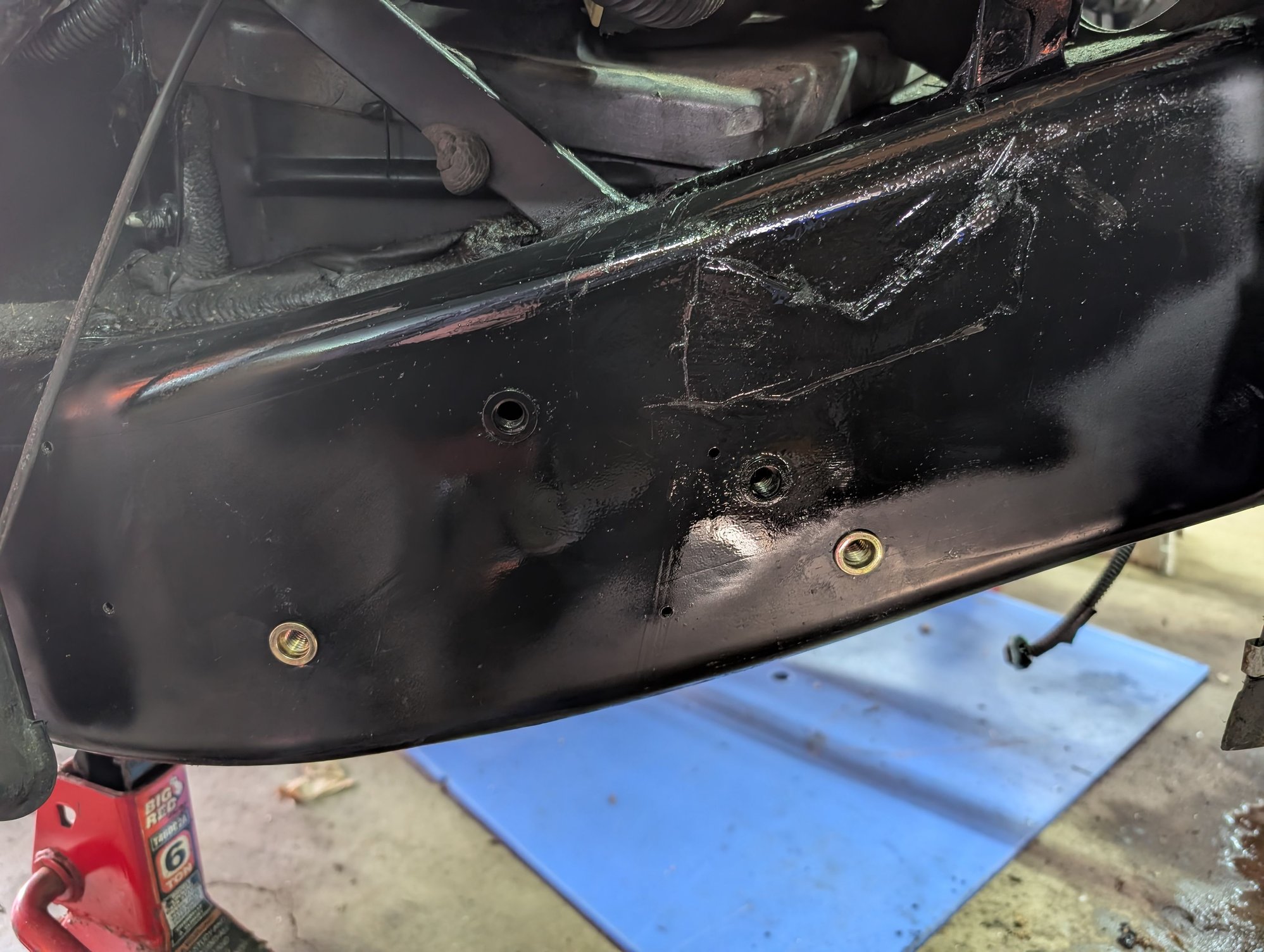

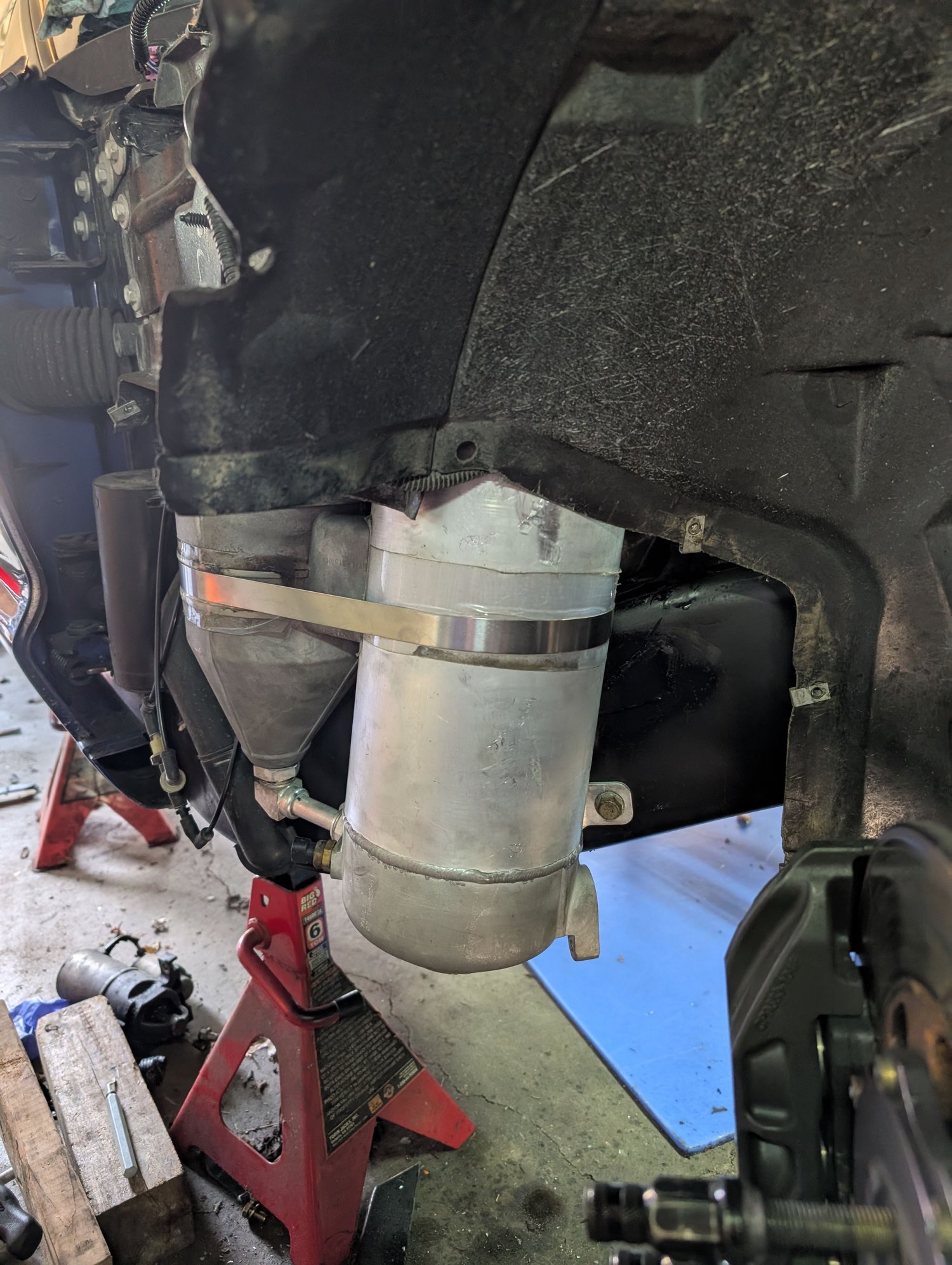

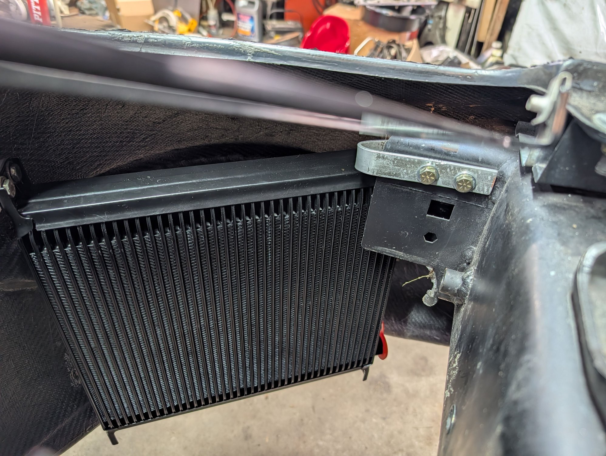

Another small update. Got the C7 dry sump tank mounted on the passenger frame rail. I previously had my accusump mounted here so the frame has some extra "lightening" holes now. This tank is a tight fit!
I also made brackets for a larger oil cooler. It fits inside the bumper behind the brake duct opening.
I had to move the PCM out of the way for the oil tank. Its mounted to the frame from the factory. There was enough room for the accusump and PCM under the cowl area, but the C7 is so much bigger I had to bring the PCM into th passenger foot well.
I had to move the PCM out of the way for the oil tank. It's mounted to the frame from the factory. There was enough room for the accusump and PCM under the cowl area, but the C7 is so much bigger I had to bring the PCM into th passenger foot well.

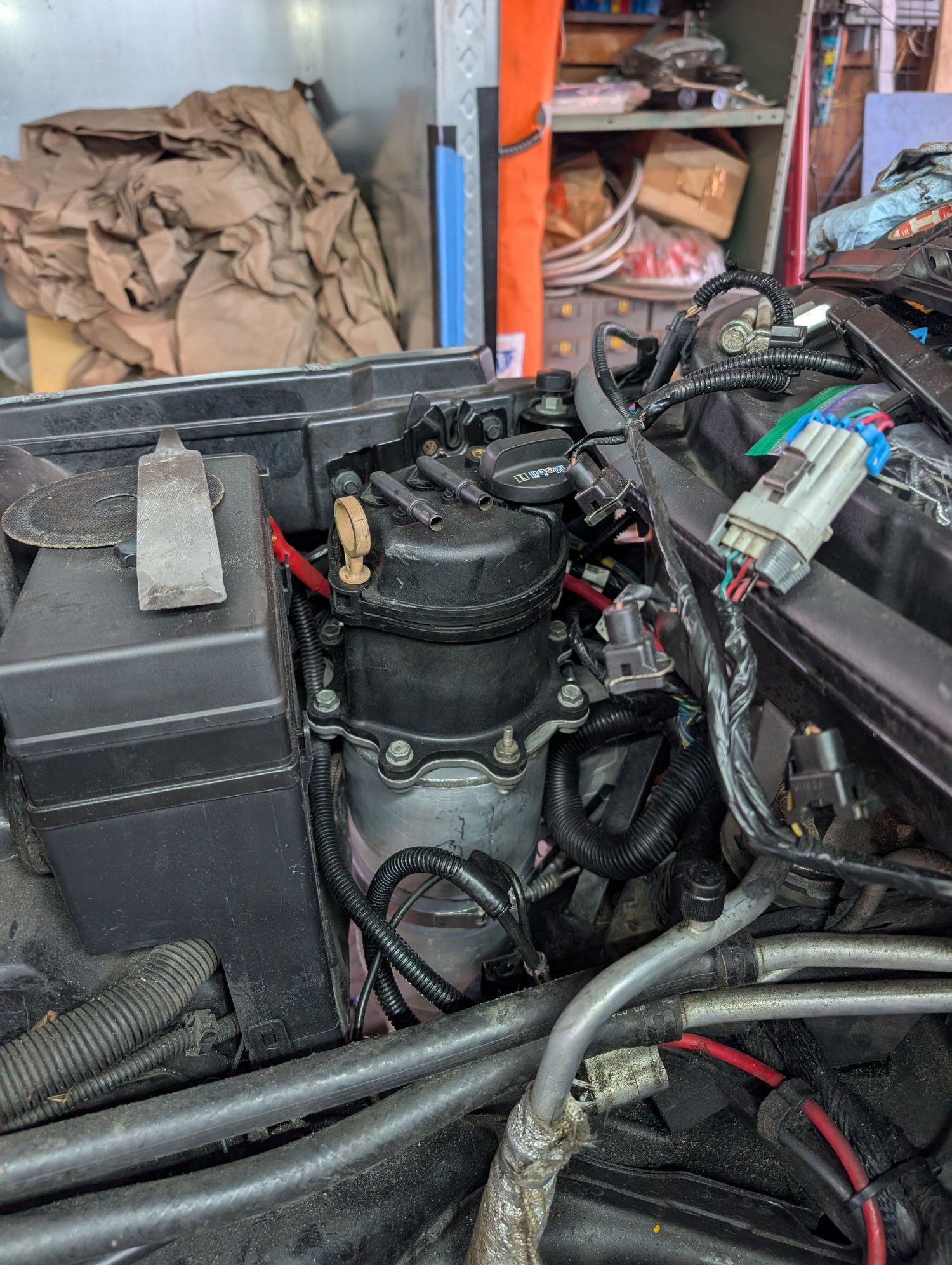

Last night I changed fuel pumps and ran the Racetronix "Hot-wire" harness up through the driver rocker. Since I have a a stupid '03.5 it has the newer C6 style fuel system and not a ton of aftermarket support without spending big bucks. I used a C6Z pump (which seems to just be the common consolidated replacement for all models now I guess) since it will provide more volume than the C5 pump. Not as big as a Walbro 450 but more than the stock C5. Lots of C6s running 600+ wheel HP on a stock pump without having to do a return style system. The pre '08 uses the same sending unit for the gauge also.
The hot wire kit is something I fell upon looking for pump stuff. It replaces the small gauge factory wiring, and uses a direct wire off the alternator for power. Keeps a constant 14v to the pump so it's more consistently making good pressure. The factory trigger for the pump now just runs a relay for the alternator power. Supposedly as the pump and car get hot the amp draw is more and actual voltage drops through the small gauge factory wiring. Meaning the pump starts losing pressure. The wire kits were like $120 shipped, so cheap insurance I can get max voltage all the time. Didnt want to risk the new engine going lean.
You can see the wire gauge compared to the factory connector here.
