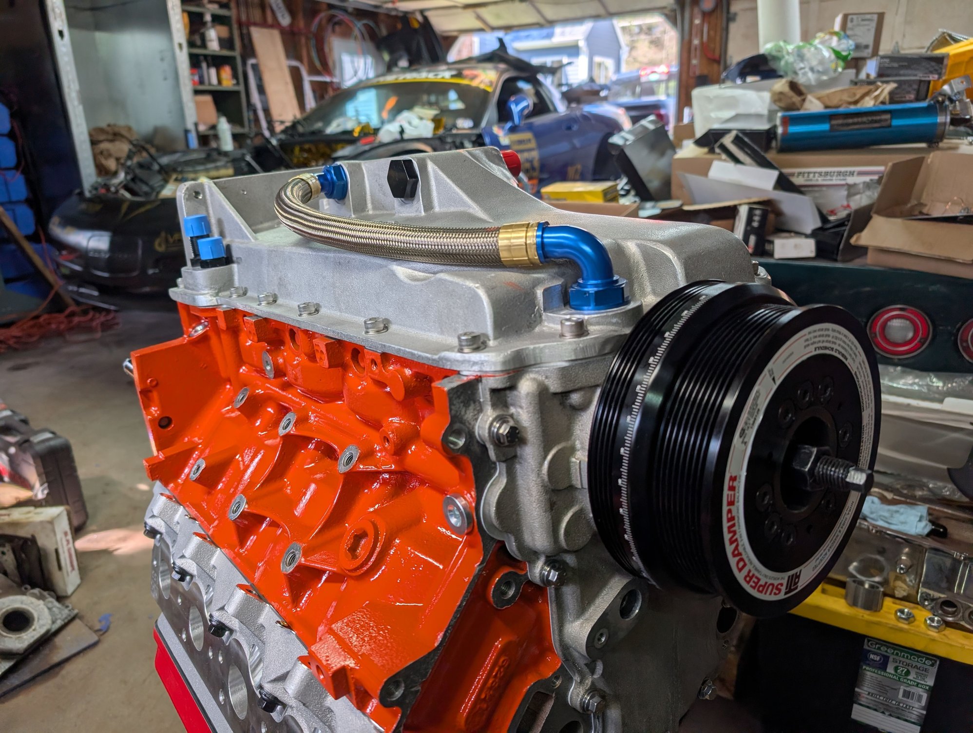

Not a whole lot accomplished this weekend, but productive none the less. Keeping the updates going on here though.

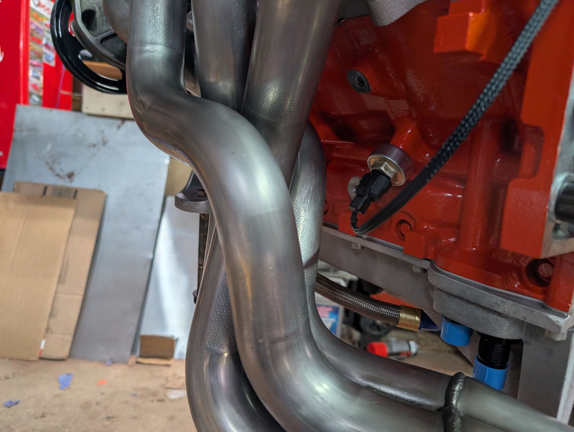

I'm using an ARE aftermarket LS7 oil pan and it requires a remote oil filter. I decided to put it away from heat and still pretty accessible in the driver side fender. I had to extend the wiring for the temp sensor, and just got a longer AN hose for my pressure sensor which was already relocated.

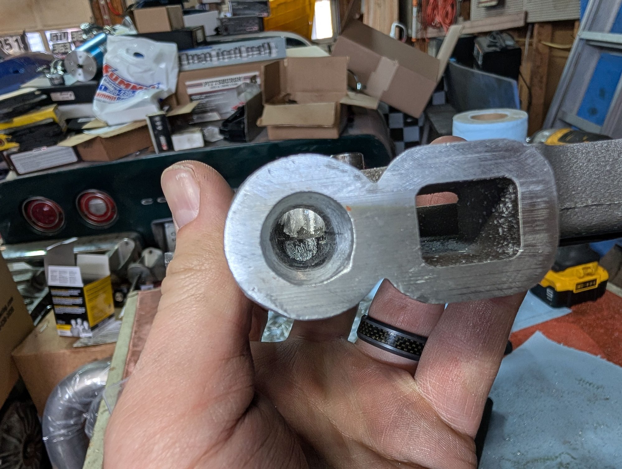

Then I worked on porting the LS7 pump for about 3 hours. Just cleaned up some sharp edges and transitions. Worked mostly on the scavenge side to keep oil out of the pan as much as possible.

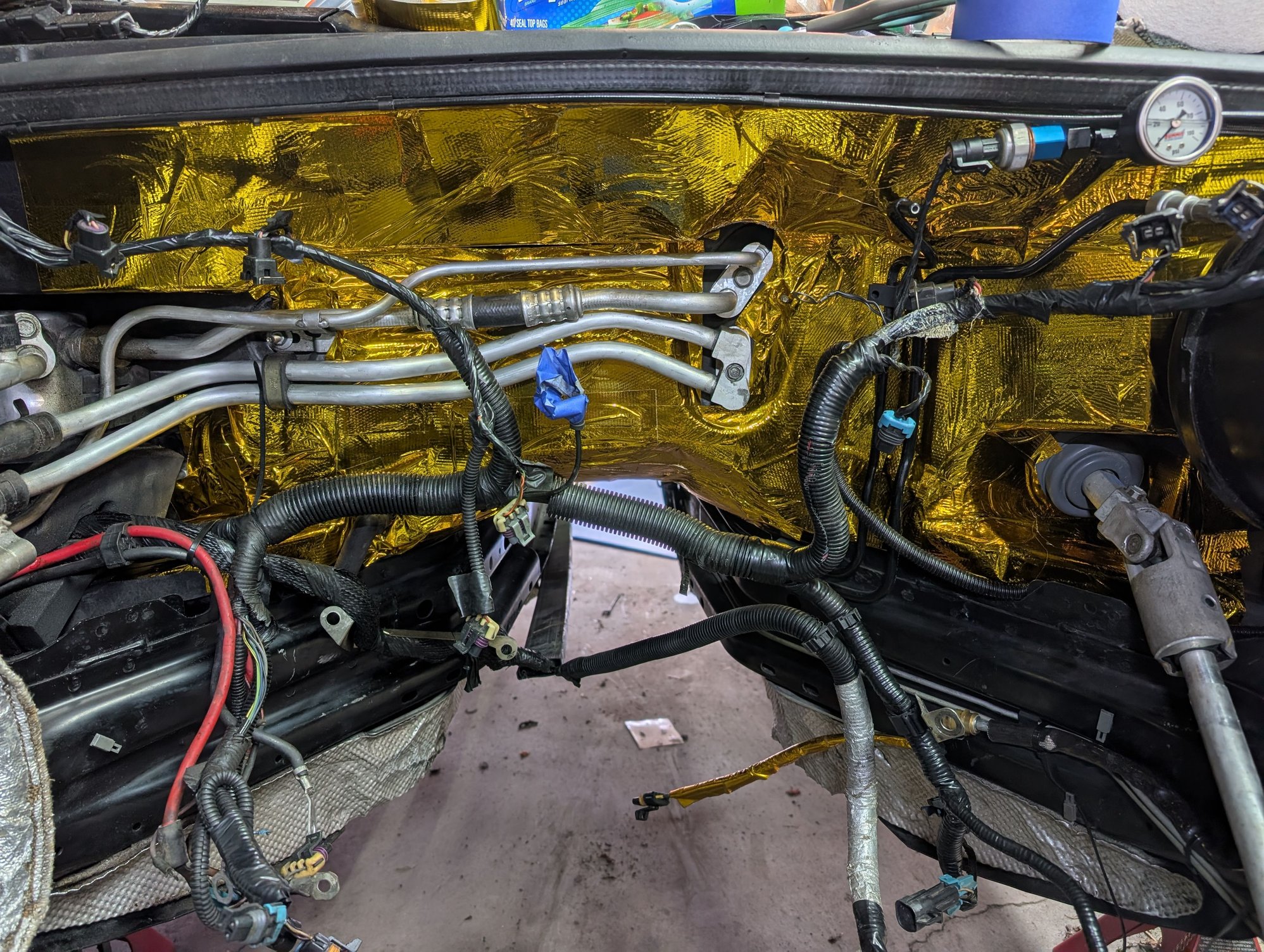

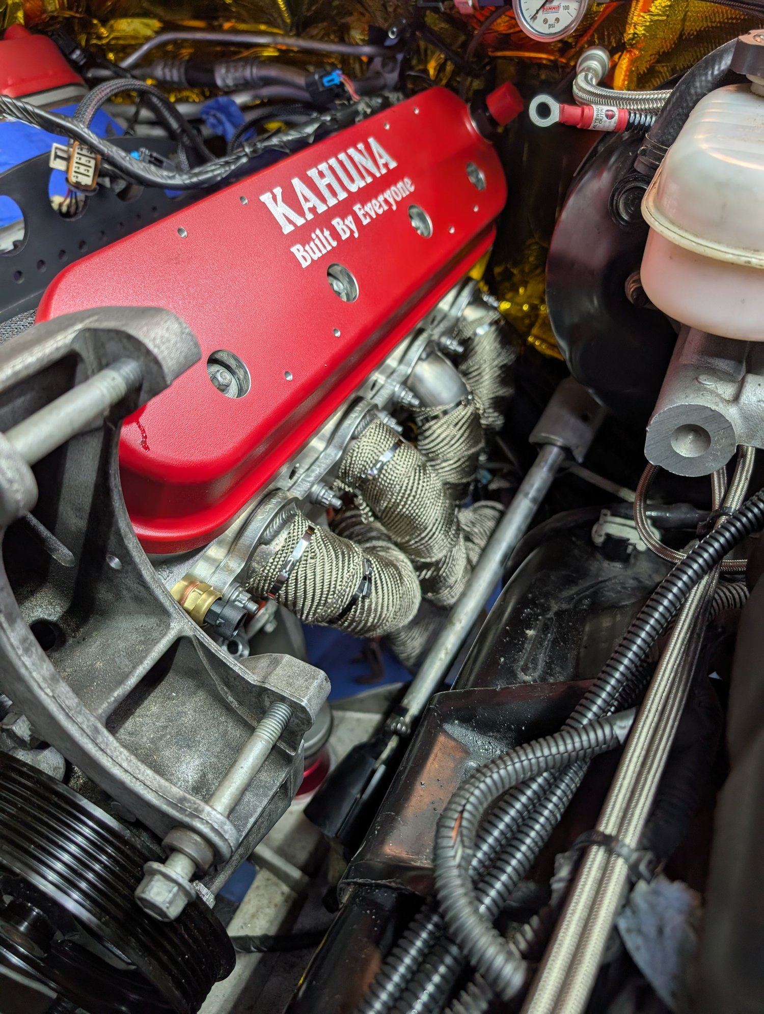

I finally cut the tub out for the C6 exhaust, and cleaned the firewall for some DEI reflect a gold heat shield.
