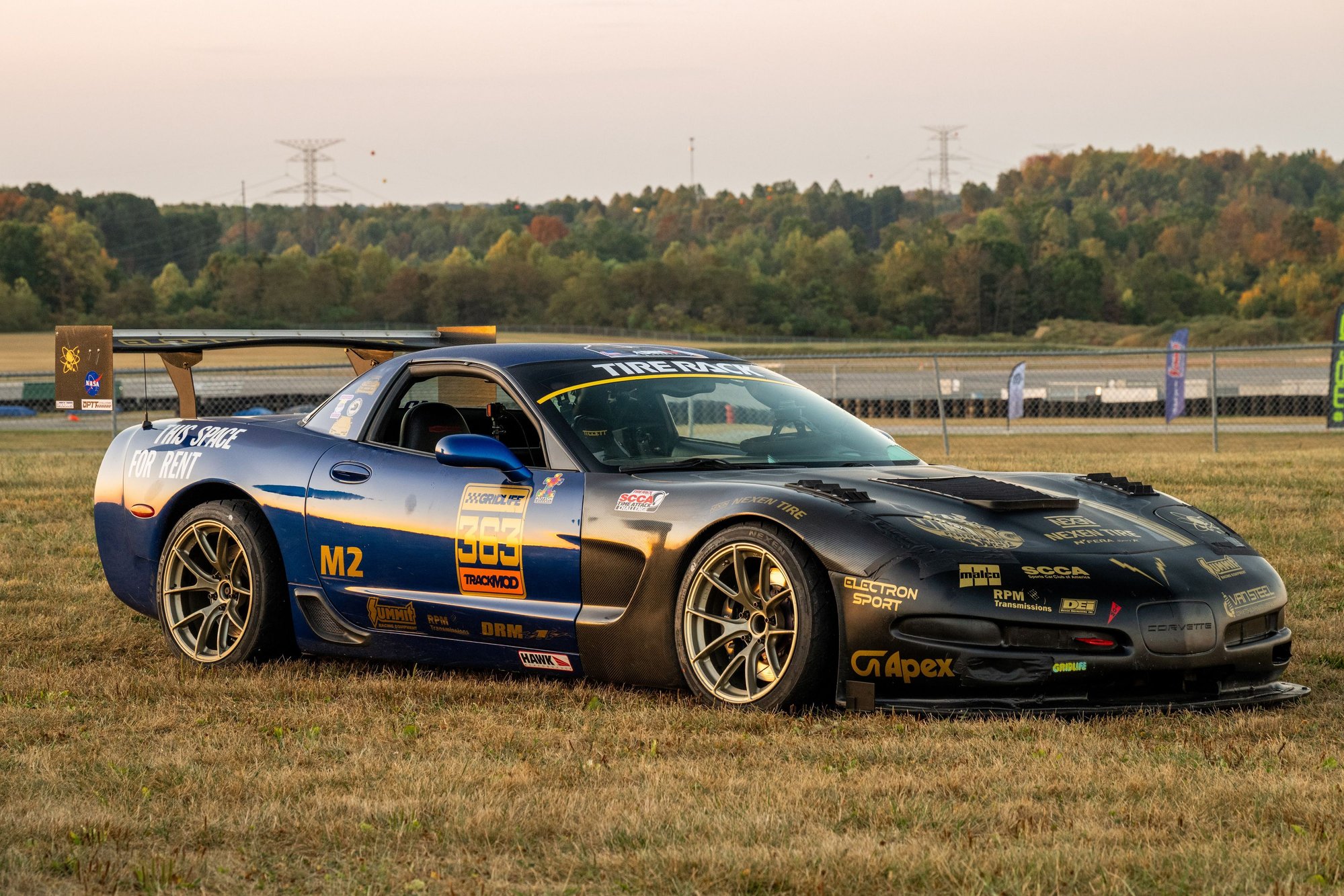

I am a long time lurker, but getting more active recently. I have used this forum to answer a lot of questions over the years (thank you!) but never had much to post about. I had a C4 Corvette for a long time and have just been doing LS stuff in the last 10 years or so, buying my C5 in 2020 to replace the C4 track car. I decided to start a build thread as Im changing things up a little for next year.
I have been competing in SCCA Time Trials and some GridLife events in Street GT and Track Mod (most recently). I have been running the stock LS6 (for the most part) since I bought the car in 2020. In 2022 I added headers and an intake manifold which was all I could do within the class rules for each series. This year the car has felt slower and slower without any changes from last year. At the end of the year I was about 3-5mph down in Vmax on all the straights at Pitt Race, and about 2.5sec off my personal best there. I think 12k track miles and occasional runs past 7000rpm has made the original engine a bit tired.
For 2026 I am building an engine with the help of Summit Racing, Cometic Gaskets and Klotz lubricants. The class rules for Max 2 limit NA engine displacement to 6.4L or less. This makes an LS3 build the perfect fit. I found an L92 truck block to use as the base for the build. Then we are going to fill it with the full line of Summit Pro LS parts (crank, rods, pistons, cam, etc)! I will be documenting the process in here with all the parts used. Our goal is to make 550 wheel hp on pump 93 octane. The basic outline will include around 11.5:1 compression, TrickFlow 280 heads, short runner intake and a cam and valvetrain capable of around a 7500rpm redline.
So far all I have is the block. Since the L92 is a truck engine with DoD/AFM, I had to plug the towers in the block the oil flow. I tapped the holes for a 3/8-24 set screw vs the hammer in plugs or rivet type kits. I used the BTR plug kit in my Gen V truck AFM delete, but I like the more mechanical retention of threads for this engine.
Next, I dropped the block off at Cragon Automotive, a shop around here that does a lot of Chevy and Corvette work. They are going to clean it up, line hone, bore, deck etc. Rotating assembly parts are order from Summit Racing and should be here soon to hand over to the machine shop as well.
This is my car:
