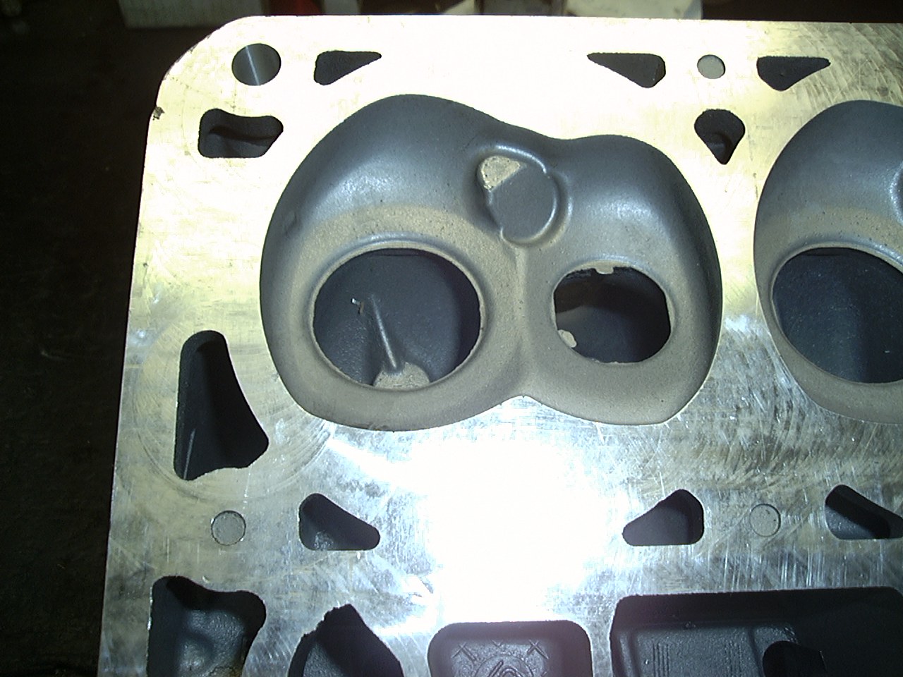

I got a chance to section cut a semi raw head casting and thought I'd share some pics with the board. I started out with a head casting number 5364. BTW does anyone know how many different casting numbers GM made for these heads? I have at least 2 different casting number cores.
Here's a shot of the unfinished chambers.
Note that there are no spark plug holes.

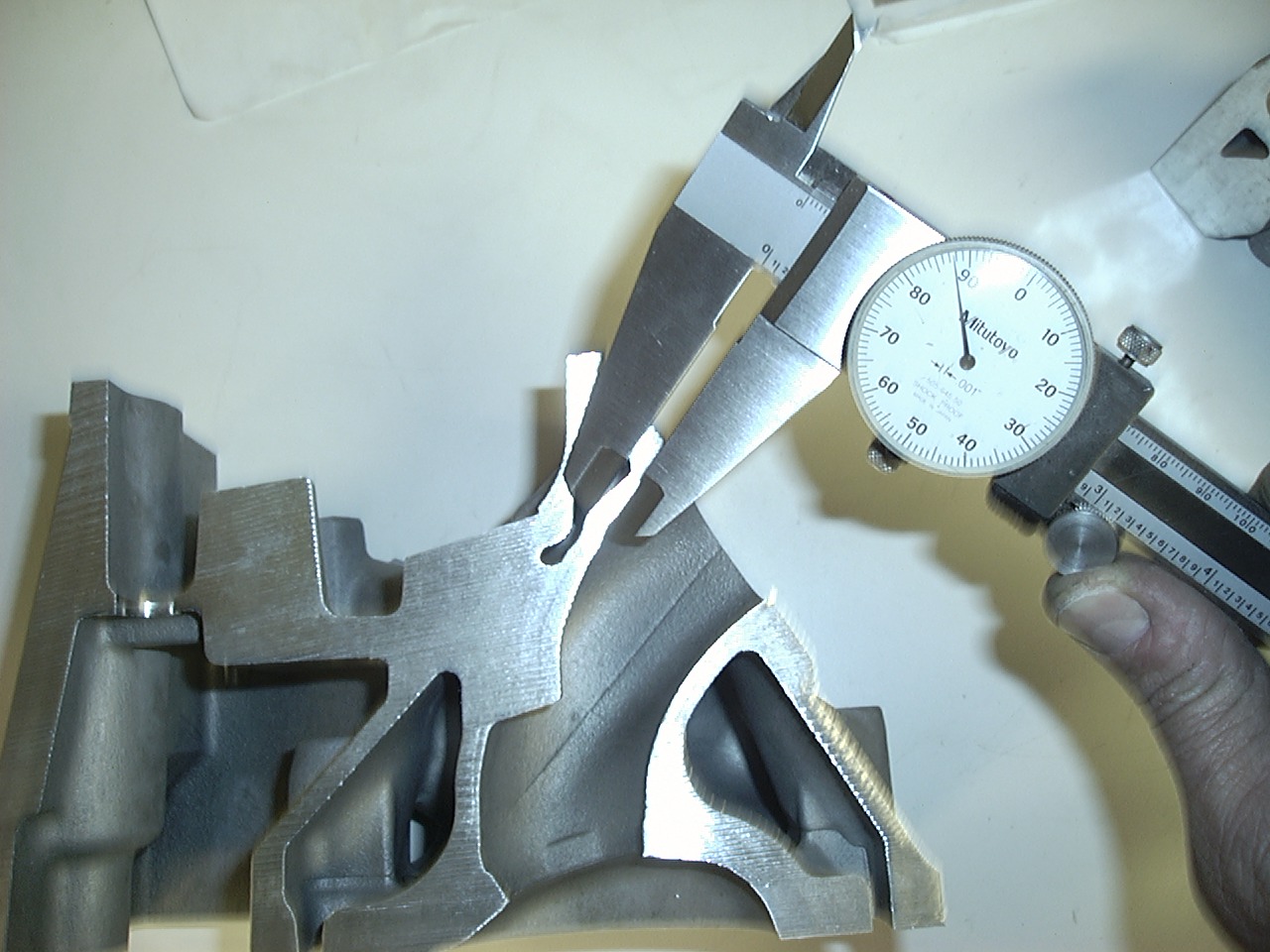

The main purpose of this exercise is to determine how much casting thickness there is in some critical areas of an unported head.

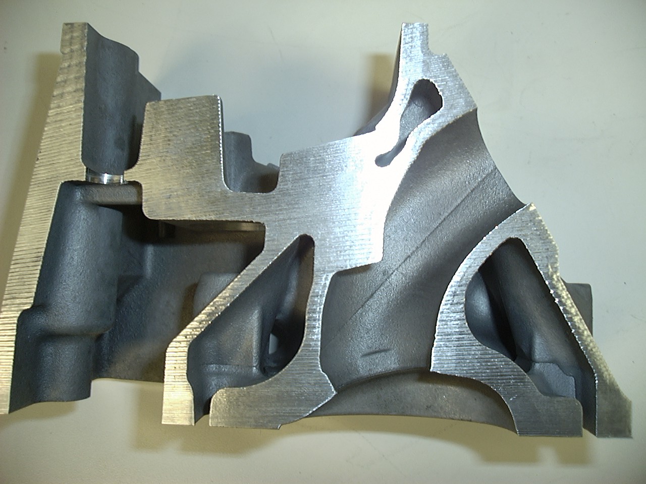

This is a shot of the intake port cross section.
This shot shows the deck thickness.
Note that this casting was not machined to the finished deck height. It was .055" thicker than the finished heads I have. As you can see there's a bit less than 1/2" of material supporting some of the head gasket sealing surfaces.

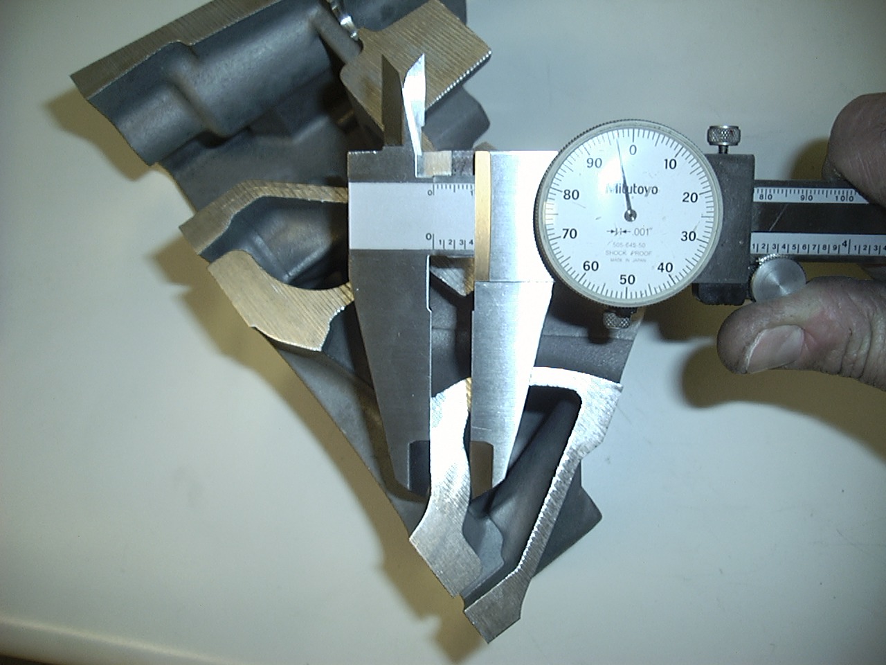

The back wall of the the chambers seem to be thick enough as evidenced in this shot. It looks like a little over 3/8" wall thickness here.
Several thin spots surrounding the intake and exhaust ports are evident. This shot is looking at the back of the intake bowl on one side of the guide boss.

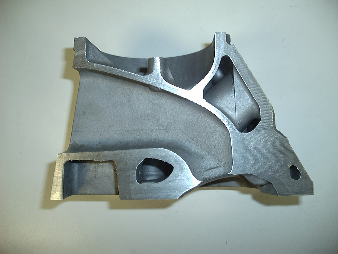

And heres a look at the as cast exhaust port section.
Note the lack of roof section thickness here:
