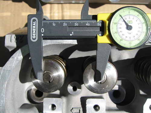

Hold your horses for a second...
Although it's the same valve angle, they're spaced apart farther.
Here's my LS3 head:
Here's my LS1 head:
Here's the LS3 valve:
Here's the LS1 valve:
And here are pistons made for the wider spaced valves and larger intake valve:

Well of course they have different valve sizes and spacing! He just asked about valve angle

I figured it the question was related to piston clearance issues.
