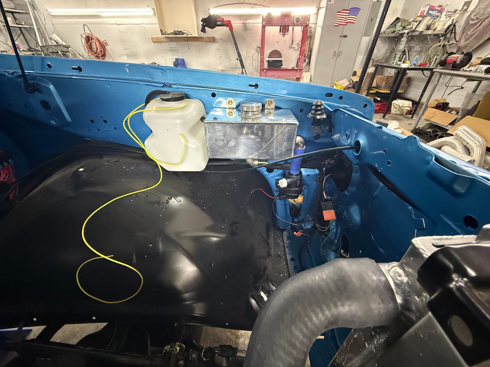

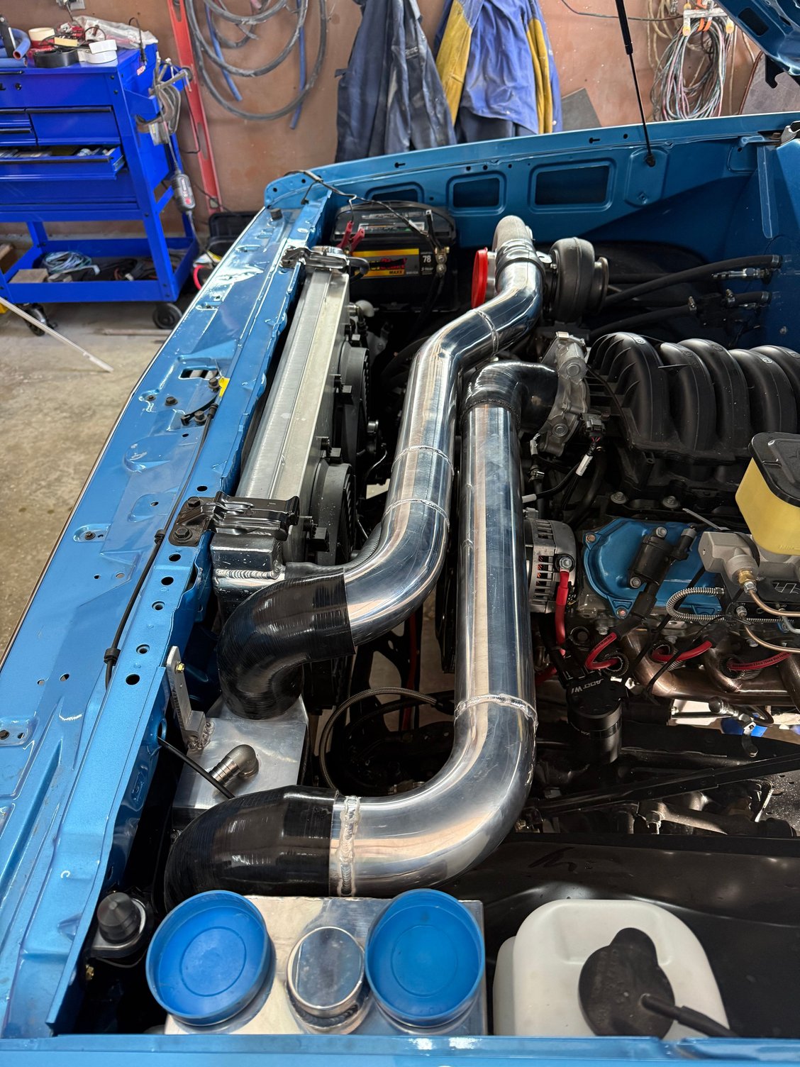

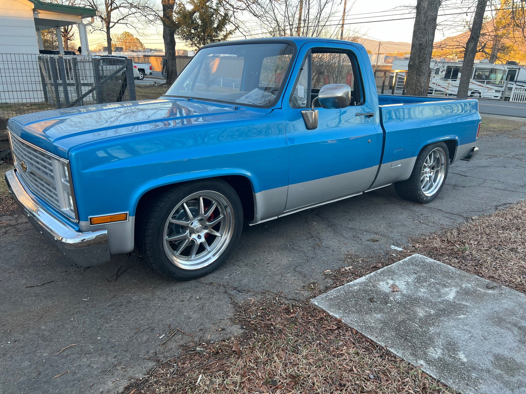

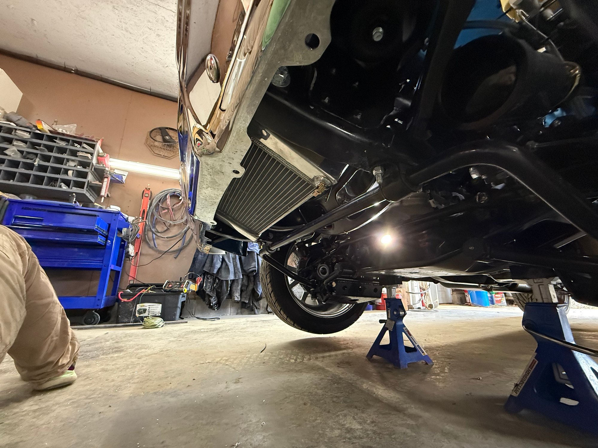

Default Truck 99% completed for a year or so.
Incase anyone find this for future the truck runs and drives great. Terminator ecu controls engine and trans beautifully together. No issues whatsoever with engine or trans. Never got tune fully sorted before used trans bit the dust but figured while trans is out I should rebuilt it and change converter to one with a small stall and thrown in a turbo because why not 🤷🏻‍♂️.
Quick air to water setup because no air to air intercooler room and should be firing it back up soon.
Fingers crossed my trans rebuild goes well. First 4l80e but shouldn’t be hard compared to 10r80 ford just got done doing for the wife’s navigator.
Yes the truck is still missing some trim maybe one day I’ll get around to finishing that part 😃.
