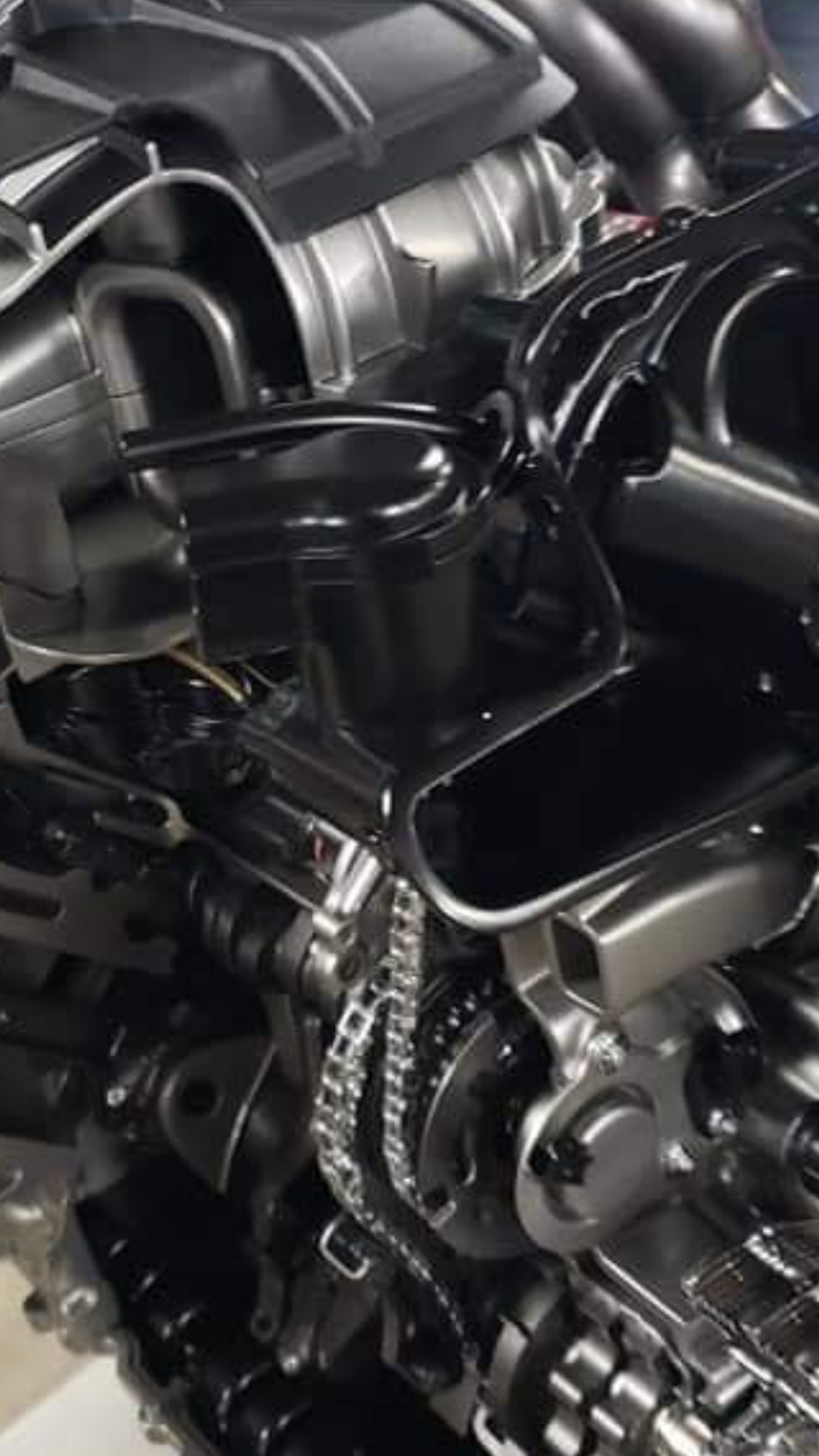

Lt2 engine. Can in cam tech?

DI fuel pump maybe?

3 oil pumps in engine (2 in the crankcase and 1 in the valley)....my guess would be the 2nd chain is driving the pump in the valley....
Yes, pump in the valley. The oil passages that previously allowed oil to drain into crankcase have been eliminated to reduce windage, so the valley pump is required to get oil from the top of the engine back to pan, or I guess the tank rather.

Check that timing chain. Without the tensioner, there would be some SERIOUS slack in it.

coil location is cool. wonder how hot they will get down there.
Why would they get hot? The exhaust goes up and over...hot air rises...

Also, the slack in that chain looks like a lot of the VWs I've worked on. They have a couple of chains and there's one tensioner that looks like that keeping things taut on the larger chain.
