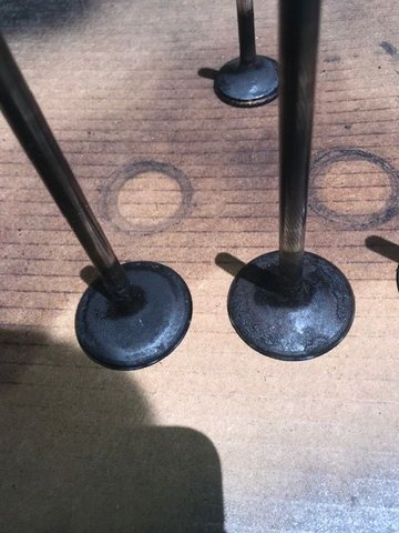

Here is an Intake valve from an 85,000 mile 5.3, 2015 DI motor. Engine was in great shape.
Intake Valve

That’s not terrible. I’ve seen worse in high mile port injected engines. Perhaps this “problem” isn’t really a problem after all? I’d love to see in intake valve from a 150k-200k mile engine that’s been maintained well. This is EXACTLY the type of info I’m after. Appreciate this!

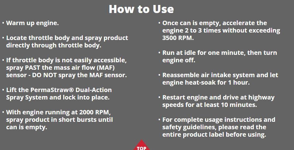

I use the crc gdi cleaner once a year in my gmc 6.2. No idea if it actually works but i figured it can't hurt. I guess i will find out down the road. My neighbor has a 2017 5.3 with over 200000 miles and runs like a champ. It also has had at least 3 different owners and has dents and dings all over it so i don't think it was well taken care of.

Thats the stuff, I believe he buys. How do you use it? Spray right into TB?

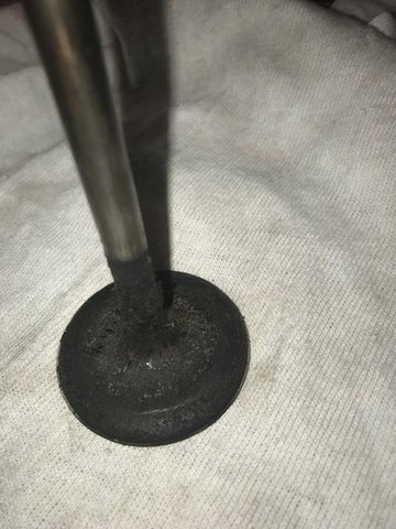

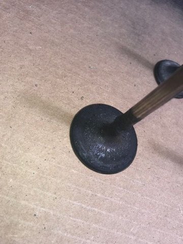

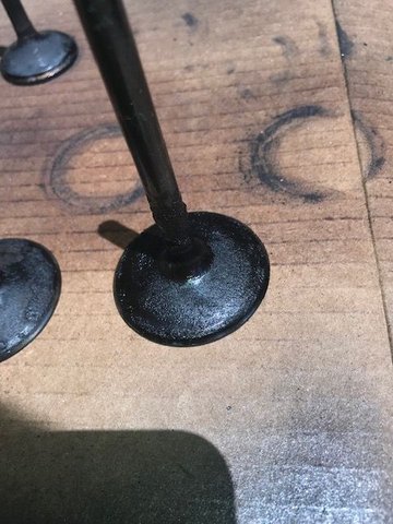

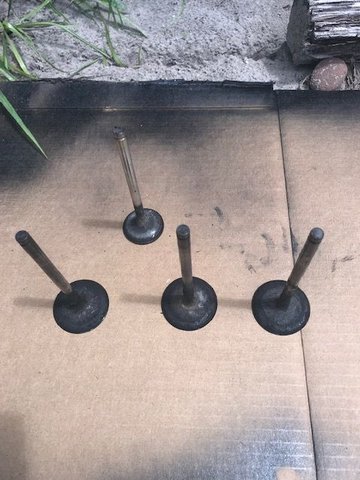

Here are a couple of pics of the valves before and after using that GDI spray directly on them. I set them out in the sun to get warm, but not 300 degrees like they would be on a running engine. Can says to spray whole can into intake while the engine is running and 5 minutes afterward, not exceeding 3000 rpm. Then go drive on the highway for 15 minutes---this will remove about 50% of the buildup. I guess you need to purchase 2 cans.
I sprayed the valves 4 times, not letting them dry between sprays. Couldn't tell any difference. I wiped two of them with a rag and some of the gunk came off. The hard baked part stayed on. I suppose the hot running engine might help loosen some of it.

I uesd 3 intake valves and 1 exhaust
Pretty dirty
After spraying 4 times, I wiped these two with a rag. Hard stuff still stayed on.
This one was not touched with a rag. Still looks the same. You can see the little amount that came off on the cardboard.
Old Aug 5, 2022 | 06:29 PM
Posts: 7,828
Likes: 5,176
Originally Posted by gagliano7
Pretty sure that’s the same product we used.
