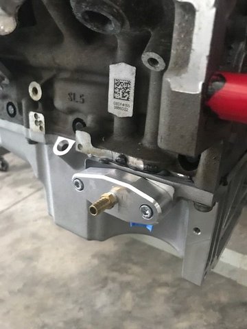

Default barb
I drilled and tapped the oil cooler cover
1/4 npt with 5/16" barb

^^ where did you get that cover ?
Old Sep 10, 2022 | 03:30 PM
dw456post's Avatar
Joined: Nov 2005
Posts: 933
Likes: 75
It came with the Holley gen V oilpan
