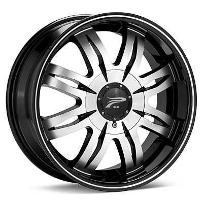

My rims I have on there are 20'' x 8.5'', they do have a lip on (spokes are sunken in) and I agree, it makes it look a lot better
edit: If it turns out the balance doesn't do anything i'm going to get these:
