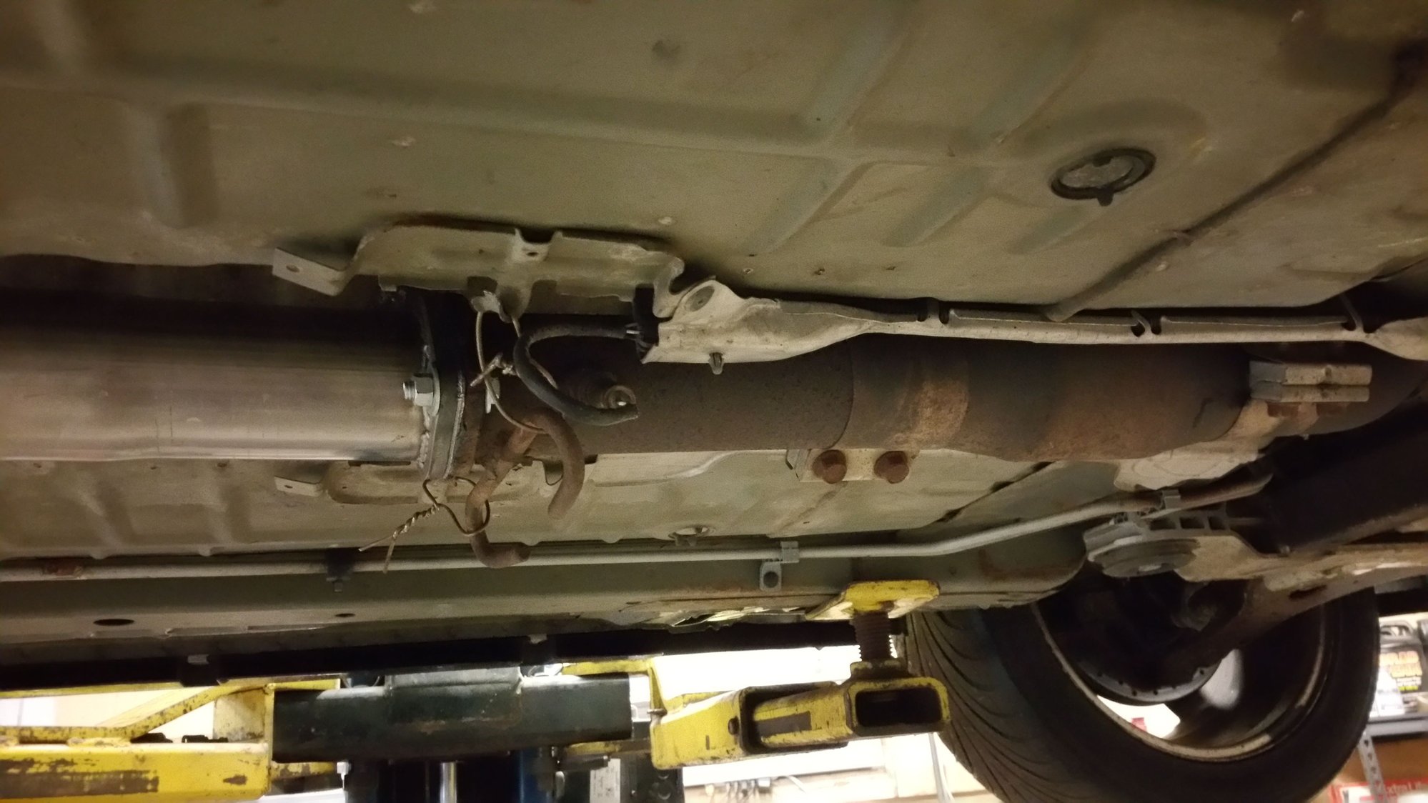

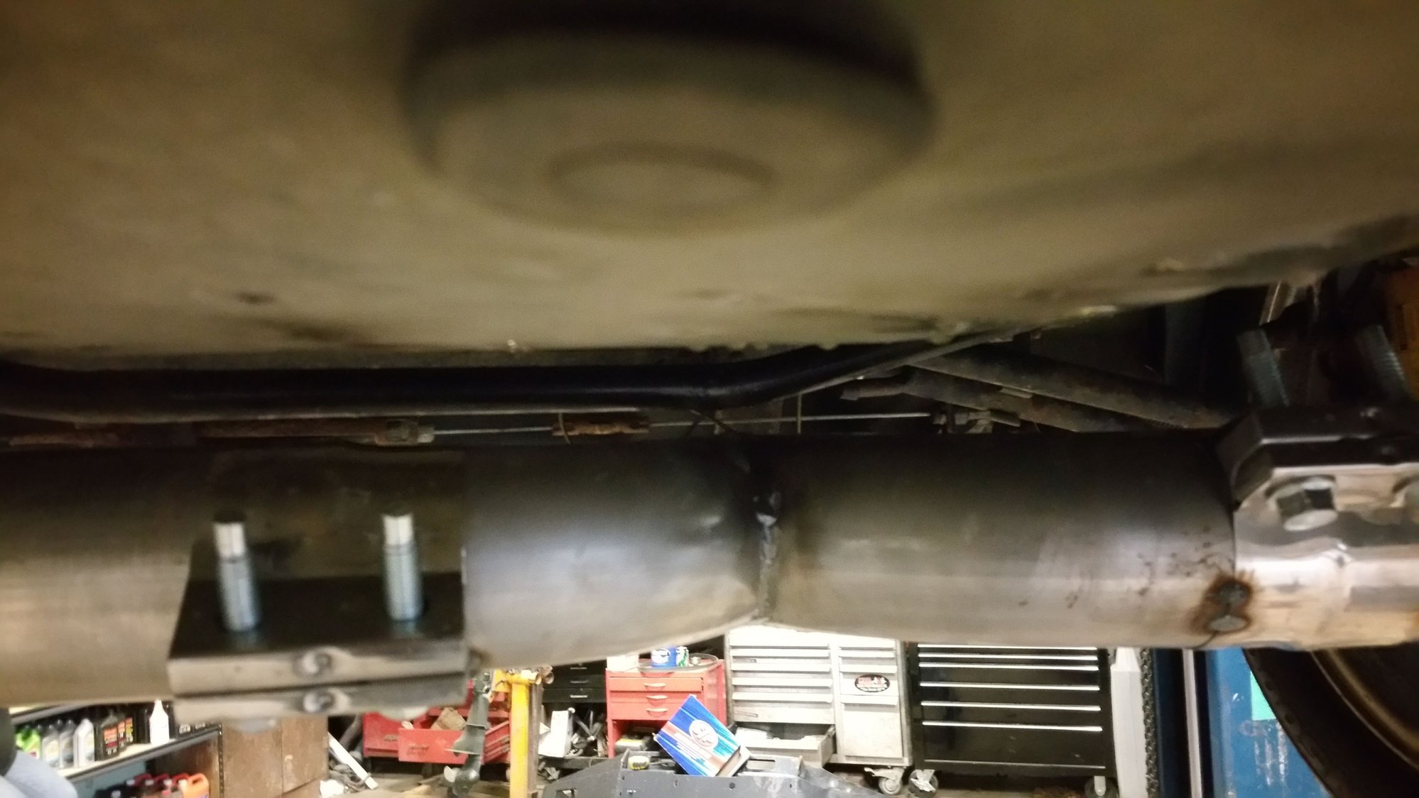

I sincerely apologize for the lack of pictures. Time was of the essence and I was behind as it was. I will get the car on a lift tomorrow and snag some for everyone.
I DID NOT INSTALL MY OBX HEADERS AT THIS TIME. I just looked at how cramped it was and knowing how my luck usually goes (this catback took 8hrs!) I didn't wanna get stranded without the ability to get parts over the holidays. I installed only the trubendz 3" stainless catback and Jones mufflers to my Hogan 3" "catted" DP.
I can say this though...the trubendz kit is legit. By far the easiest way to obtain a 3" dual exit exhaust for a W body car. It is a full 3" the entire way out both tips. The kit specifies and requires a 3" offset/center muffler configuration with a 14" case length. This puts the exit of the muffler within the cutouts in the bumper and about 3" or so from fully exiting the bumper. The case tucks in nice and neat. Almost no room for exhaust tips but you don't really need them. The exit sits in almost a perfect spot.
I used the included 3" flange. It mated perfectly to the DP from hogan. Cut intermediate pieces to length, welded the flange on, and pieced it together.
It went as smooth as it could. I am one guy alone on a garage floor with the car maybe 18" off the ground...I have a 36 waist...yeah...it was fun. Lol.

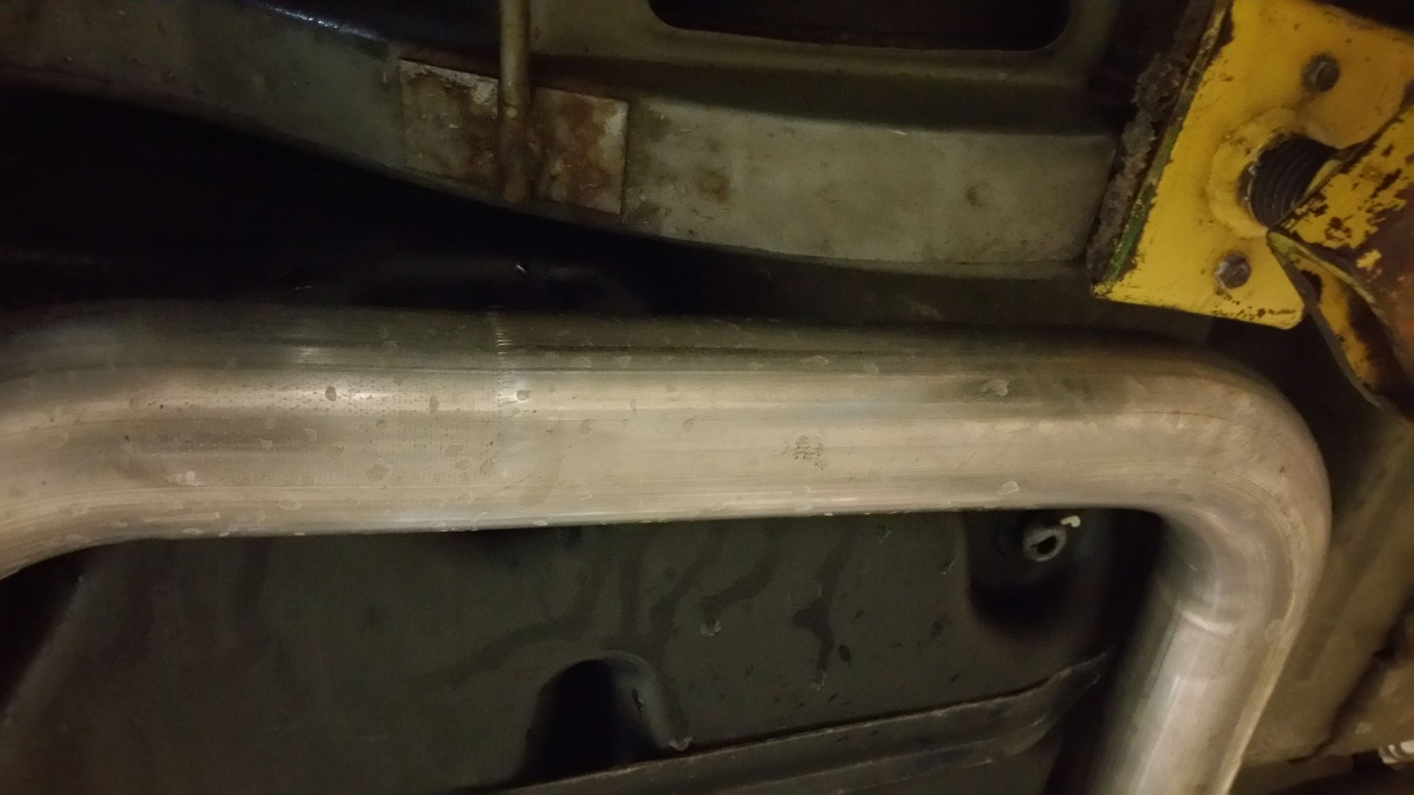

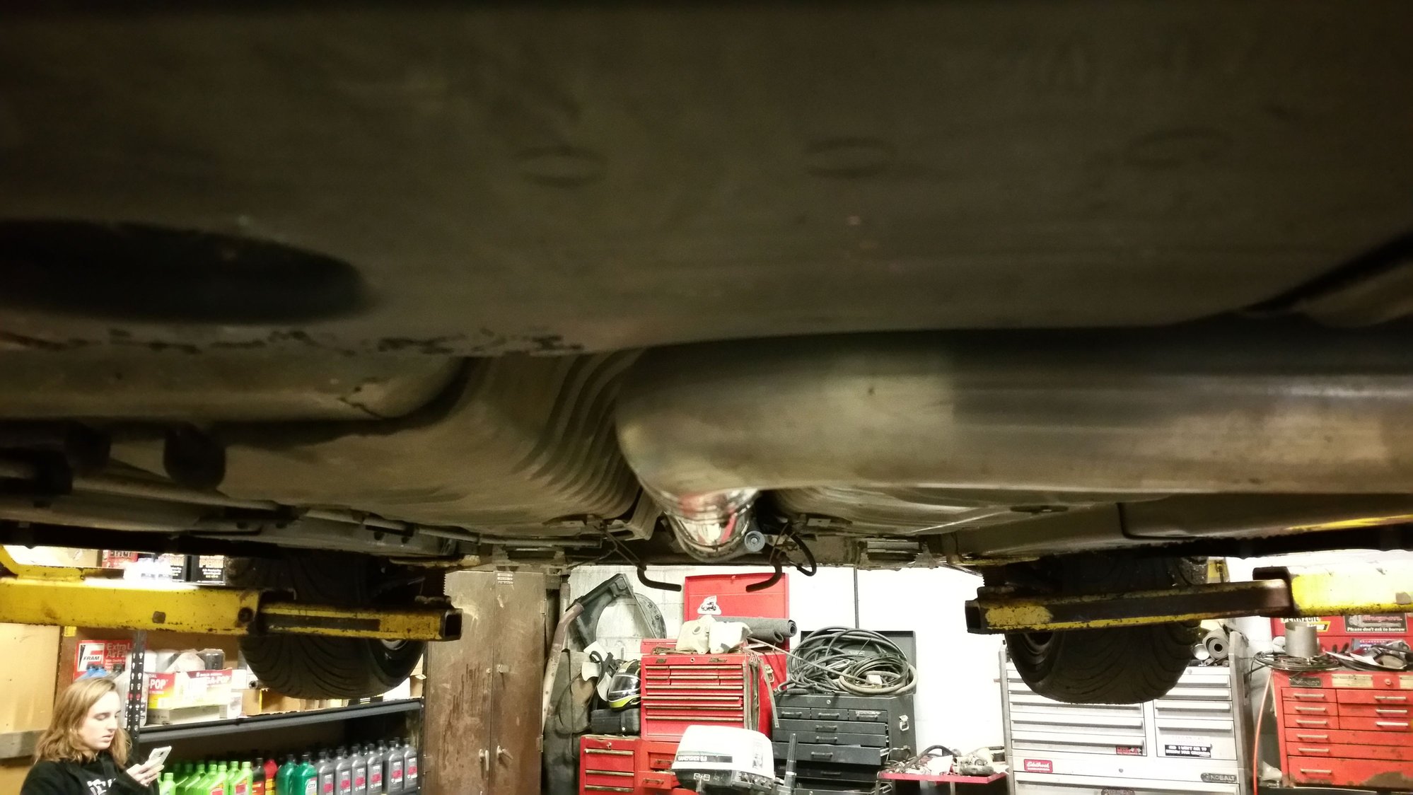

Old Dec 23, 2014 | 10:37 AM
fubar569's Avatar
iTrader: (9)
Joined: Jan 2006
Posts: 258
From: Bradford, PA
It fits pretty good in all critical places. I tucked mine up a good bit further than some would've so it's tight to the sway bar and tank strap but I have good clearance at both points.
Overall an excellent purchase. Just make sure to either weld or get some good band clamps. As you see I still tacked the clamps to help keep the pipes from rotating and it gives me a reference if geometry ever changes.

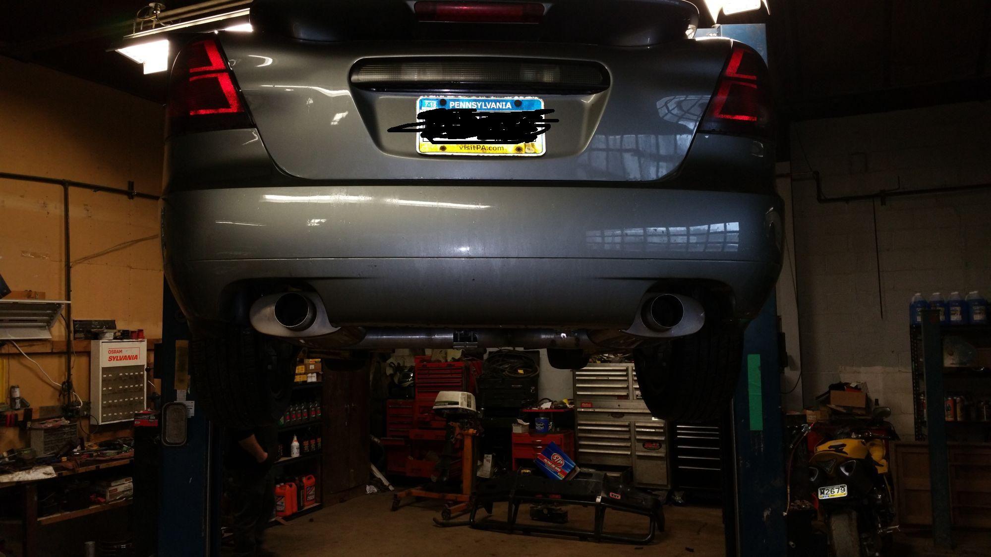

Do u have pics of the rear after the Y? And how much was the catback setup?
Old Dec 26, 2014 | 09:54 AM
fubar569's Avatar
iTrader: (9)
Joined: Jan 2006
Posts: 258
From: Bradford, PA
Catback was i believe 350 shipped in 3" stainless. They have it in 2.5" mild, 2.5" stainless and 3" mild as well. add your own mufflers.
This is a shot of how the system looks exiting the car. those outlets are just into the bumper. Could use tips but there's really not much room at all for them...
