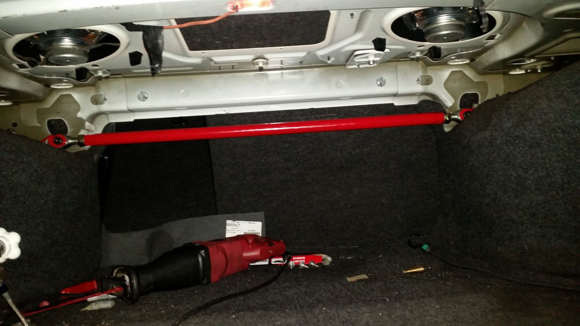

You will love the setup. I got the rear stb bar to fit as well with some modification.

Hope so, that looks great. Post a pic of the rear strut bar if you can, its a mod I want for sure. I like the look of the factory bars with the Don Rome adapters, I just don't think the adapters should cost that much, and I would prefer steel over aluminum also. Hoping to maybe find a used pair as there are very few options besides custom fab strut bars for these cars .

LOL, how the hell does that help. I need to see the mounting points if you made some mods to make it work. BMR says the strut bar wont work on ours, we all know anything is possible with some customization
I went through the trouble cause I don't like non tension adjusting strut tower braces. This ****** is thick to and probably complete overkill. But that's how I built my suspension.
To the right you can see where I had to slightly enlarge the flange to fit around and clear the lip area.
You'll see the 2 lines here that needed to be cut back to clear the bracket area for the BMR stb to clear. After all that your all set. Took me about 30 minutes to figure it out and test fit and execute.
Thank you. Looks good. Is that metal you removed just part of the rear seat support?
Yea, it doesn't take away from any structure. I just made the cut and hit it with hammer till that section folded out the way.
