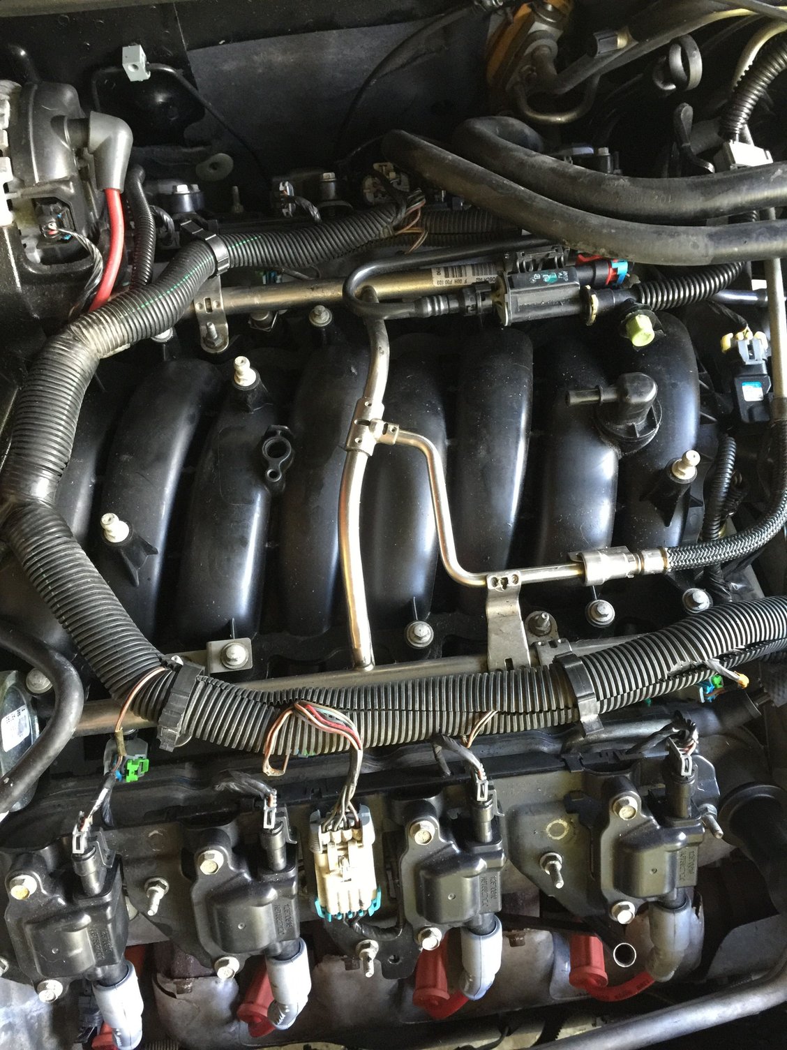

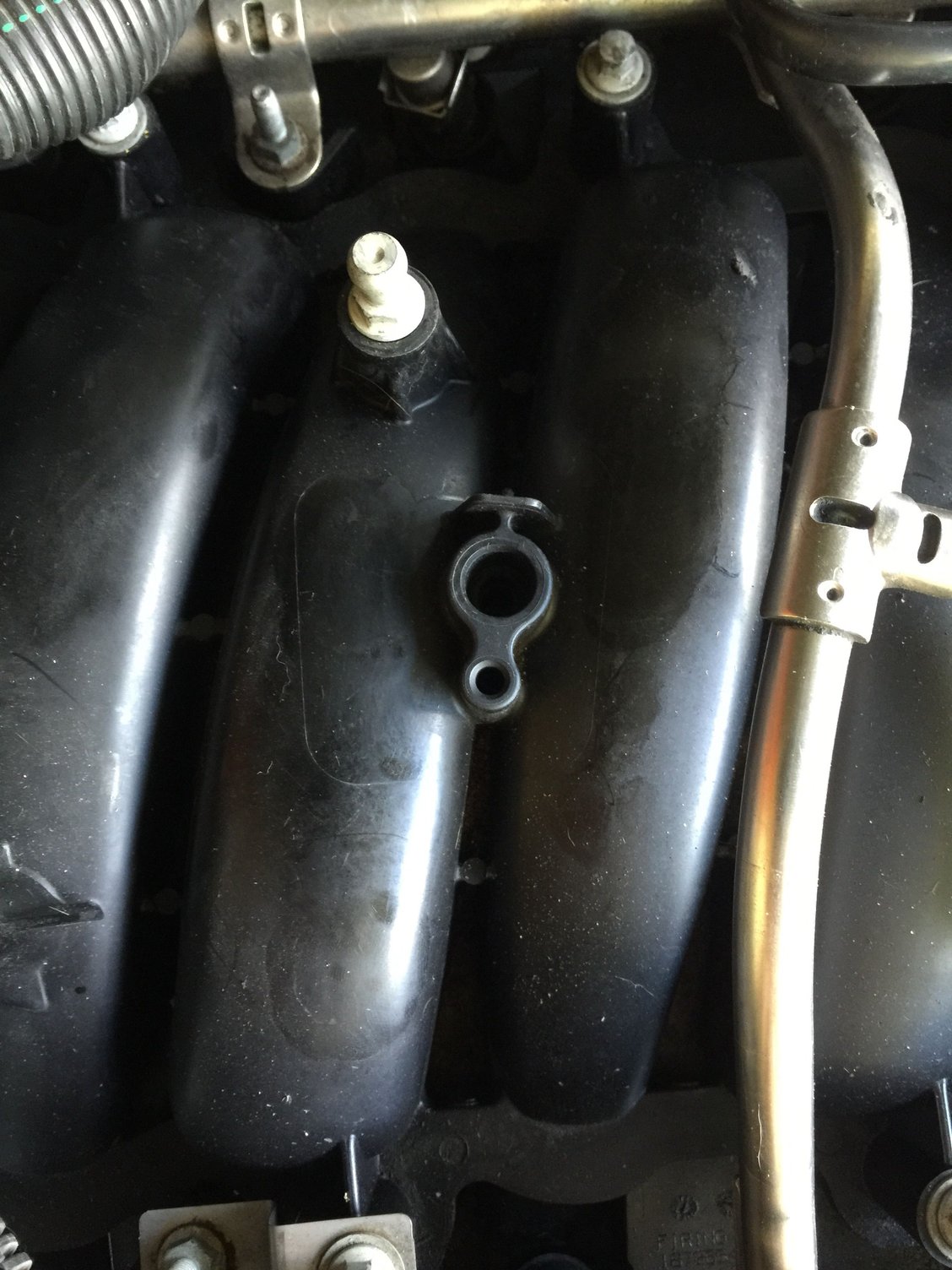

Hey guys, I just finished changing plugs, wires, and valve cover gaskets on my 06 GXP. I noticed when I took the cover off the plenum there is a port in the middle of the plenum. I'm not sure if something goes here and if it's sucking air when the car is running because I have the battery out of it from doing several things. If something goes there I figure it can't be much since the cover sits on top pretty close. Not sure if this is the original plenum since I bought it used. Any info on this? I looked for pics of an LS4 plenum but had no luck.

Old Aug 31, 2015 | 04:11 PM
spawne32's Avatar
Joined: Jan 2014
Posts: 1,524
thats the map sensor port, and the one to the right of that comes off the back valve cover with a vac hose

Since your a 06 you just need to move the map over to that location since it used to sit by the throttle body for all 05 06 ls4 vehicles

91parkave is my map located somewhere else. I haven't noticed a wiring harness for it in that area in the picture.
Old Aug 31, 2015 | 07:09 PM
spawne32's Avatar
Joined: Jan 2014
Posts: 1,524
one of the MAP ports should be blocked off depending on the year, you can just test that by using a small screwdriver to see if it goes into the manifold. If both ports are open, then you need to block one of them off so it cant put air through it. Although they shouldnt be.

I've never seen a ls4 manifold with both locations for the map odd.
Old Aug 31, 2015 | 10:24 PM
pigsticker's Avatar
Joined: Feb 2010
Posts: 54
From: Mississippi
Where do I need to look for my MAP sensor? Near my throttle body?
Old Aug 31, 2015 | 10:39 PM
91parkave's Avatar
Joined: Feb 2008
Posts: 2,079
Likes: 9
From: Arizona
Just leave it where it's at and plug the other port

Looks like the map is on the R/S of the pic.
Old Sep 1, 2015 | 10:10 AM
pigsticker's Avatar
Joined: Feb 2010
Posts: 54
From: Mississippi
I just checked and it's right behind the throttle body.
