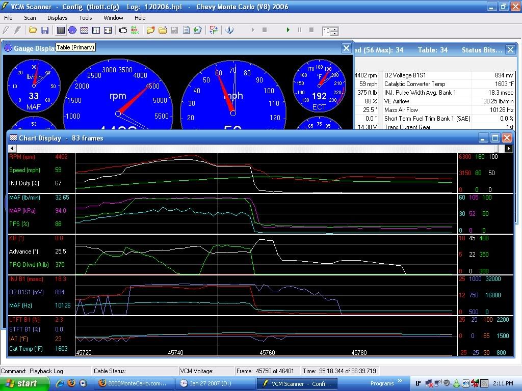

UPDATE:
Well i left my camera at work so i couldnt snap any shots. But i got them and swapped them in last night.
The front set was super easy, its akward isntalling them because the two rockers are connected by a pin and always slid off one another when trying to put them on, and trying to hold the new pedistal on the screw too while trying to line up the screw in the mounting hole was a bitch.
The rear takes some patience, working under the alternator on the right most cylinder is tough and you will need a will need an allen wrench on a socket to make this go quicker.
Buttoned it all up, fired it up, pretty noisy for the first 10 sec then got whisper quiet. Grabbed the lap top and logged it and took it out and tested it. First impressions were like eh... i cant really feel it but again the road were kinda damp and would spin through 1st into 2nd but i was like hmmm this thing really seems to pull HARD from 55+
So i look at the log and the delivered torque was up alot from 4G +from 329ish normally to 355 consistently. So i noticed it was running a touch lean (880Mv) so i fattened it up 3% and raised the rev limiter to 6600 and shift points to 6400. Tested it and was greeted to valve float and nose over above 6200 and a blinking SES light indicating a random misfire. So it could use springs if you wind it higher.
So i turned the rev limiter back to 6300 and shift points at 6100 and tested it with the new fueling and it hooked kinda in 1st and WHOLY ****! does the thing just pull like a freight train! It never got to 100MPH so fast LOL Its not like a diff after a cam but its enough to feel once the tune is right on. and my grand total peak torque the scanner sowed was 366 at 4700! that 60-80 just feels wicked now!

I think Vinci Hi-Performance in Flordia tested a Impala SS with 1.8 rockers and claimed 18 hp and 16lbs tq gain at the wheels.
http://www.vincihighperformance.com/...sMAINPAGE.html
I moniter the engine delivered torque in HPtuners as well. Stock I was seeing around 310-325tq at WOT, now I'm seeing 350-375 tq at WOT(colder weather).

25 degrees timing and + 2.3 trim at WOT... I run 30* with 0 trims at WOT, perhaps i should try and drop it some.
